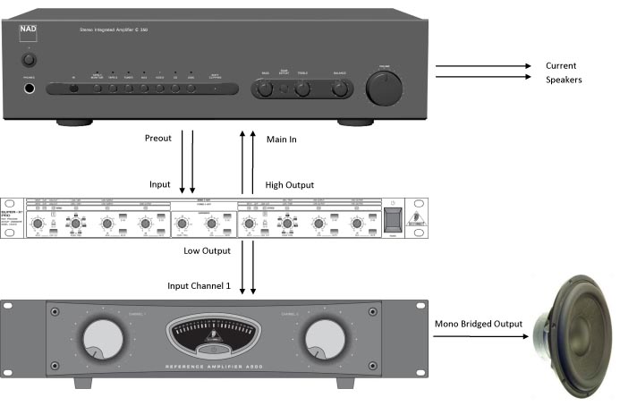

Ive found a matching a matching 2 way Behringer cross over (CX2310)...
Currently i have an oldish NAD C350 amp and a decent pair of speakers which are a bit modest when it comes to bass. Im thinking of adding the CX2310 and A500 to integrate a sub into the current system. Connected something like:
- Preout from NAD into CX2310
- High Output from CX2310 to NAD main-in
- Low Output from CX2310 to A500
Ive opted to use the low output rather than the sub output because it has a 25Hz high pass filter which can act as a rumble filter.
Any problems with the set up or a better solution/cross over??

If you can, save the few hundred extra bucks for a Behringer DCX2496 crossover. It's one seriously handy bit of gear, and an amazing bargain in my opinion. Mine cost $440 from a store in Melbourne. The parametric eq is invaluable for sorting out subs in bad rooms. Can you tell how much I love this thing?
kffern,
On another thread someone recommended the Reckhorn B-1 as a cheap cross over.
The unit you recommended looks more advanced than this product and also has an amplifier integrated into the system. For $395, it is actually cheaper than purchasing a separate amplifier and crossover!!
I'll look into it. I think i want to pump more power into 8ohms though. It must be handy to adjust the output for bad rooms...
Cheers!

Guy, I have been using the Behringer crossover for a few years now and I have had no real problems.
Others on this site say they perform better with measurment equipment to calibrate but Ihaven't had that fine level of hearing for a few years now.
I find it a very versatile and useful piece of equipment so much so that I own 2 CX2310's and one of the three way units.
I have had good reports on the Yamaha Pro amplifiers, but lets face it if its bass and you cross low a little distortion could be traded for power and most people could not hear it, in the short term any 200 watt power amp thru e-Bay may do the job
Regards Ted

Thanks for the advice! I think i will stick to the Behringer configuration. Im not after SPL, Im sure 200W would fit the bill - i certainly dont want angry neighbors knocking down my door.
The A500 seems like the smallest, cheapest amp i can get retail - without resorting to Ebay. For $280, its a better deal than the WES/Stones plate amps... and on a hunch, i trust its build quality more (purely speculative). Like Cloth Ears said
Thats the hope anyway!
I'll sniff around for a second hand Yamaha. Hehe, the Redgum amps do look alright but unfortunately my numbers didnt come up the other night!!
