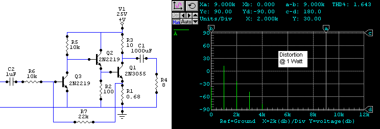

I was a bit bored and looked over at a disassambled regulated psu that has two 2N3055's in it and thought "i wanna build an amp with that!"
Heres the result after a few hours in simulation:
schematic with sim
schematic with sim
First thing I noted is with your diff amp degeneration resistors R9, R16.
You have them shorted out, as your distortion text also indicates.
Sandy
Sandy

So if you want stereo, it'll have to be single-ended class A.... two 2N3055's ...
Hehe - look Ma, only 30W dissipation for 2.5 watts output.
If i want to make a stereo version of this, i'll just get more 2N3055's, their dirt cheap.
This heatsink is way undersized anyways, its already HOT!! And this amp runs only 100mA bias.
