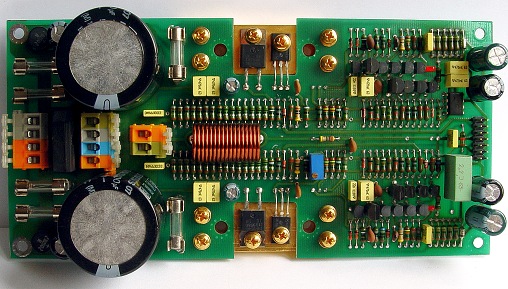

Whatabout something like this : 60 W/8, 100 W/4, full power 1 Hz- 300 kHz, SR 100 V/microsec, SNR over 120 dB, THD 0.002 %, IMD bellow 0.002 %, IRF 540/9540
