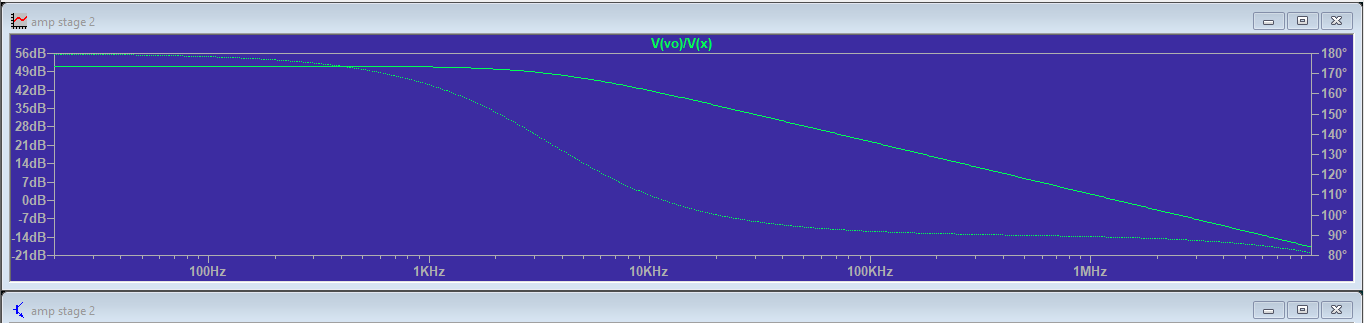

Hi i am attaching a simple amp stageThis is how you go about it To generate the loop gain and phase plots from which you can determine stability :

I cannot plot Vo/x

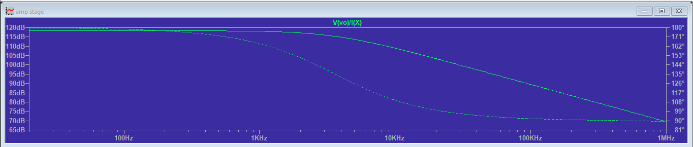

Add AC Amplitude 1 to Voltage source.Hi i am attaching a simple amp stage
I cannot plot Vo/x
You have only added text to output net. Right click on output net to label net to Vo.
Plot V(Vo)/I(x)

This is an excellent reference that gives a very good theoretical background of the subject and describes in detail the Tian probe method, what I've always used in LTSpice for stability analysis with good results: https://www.iceamplifiers.co.uk/articles/stability/stability.pdf
If you want to jump straight to this, it starts on page 56, "13. Using LTSpice to plot the open loop response". The circuit shown in fig. 28 is available in the included LTSpice Examples folder, located in C:\Users\[UserName]\AppData\Local\LTspice\examples\Educational
In that plot pane, click on "V(vo)/V(x)" at the top, this will show the cursor (a dotted line cross) in the middle of the graph and a small window will pop up showing you the reading of the graph at that point. Click anywhere on the vertical line (as you approach it the mouse cursor will change from a small cross to an arrow with a "1" next to it) and drag it right until the value in "Mag." reads 0 dB. The value you can read now in "Phase" is your phase margin.
Then you click again on the cursor vertical line and drag further right until "Phase" reaches 0º. The "Mag." value (ignoring the sign) is your gain margin. In this case it looks like you will have to simulate up to a much higher frequency to get there. Note that it's possible that the phase never reaches 0º, which means that, in principle, you could reduce the closed loop gain as much as you want without going into instability.
