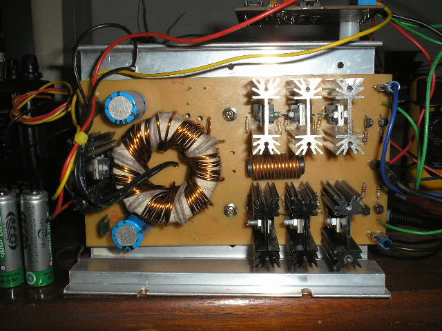

Some seem to think they are great.
<a href="http://www.audio-consulting.ch/pipeSMPS.htm"><img src="http://www.audio-consulting.ch/pipeSM1.jpg"></a>
<i>A C37 wooden version using no PCB
Very high efficiency HF Supply featuring 100% Silver Power Transformers.
They power our reference SE 300B amplifier based allowing absolutely new levels of performance</i><hr width="95%" align=center>
<a href="http://patft.uspto.gov/netacgi/nph-Parser?Sect1=PTO1&Sect2=HITOFF&d=PALL&p=1&u=/netahtml/srchnum.htm&r=1&f=G&l=50&s1='5612646'.WKU.&OS=PN/5612646&RS=PN/5612646">US Patent 5,612,646</a>
<i>"A linear audio amplifier includes a push-pull pair of vacuum tubes operating in a linear amplification mode coupled through a pair of dc-dc switching power converters to an external load impedance"</i>

tripping on C37 ?
Hi James, thanks but this was not quite what I had in mind - not even the remotest bit really. 🙂
These guys seem pretty intoxicated on C37 - maybe the fumes are a little too strong.
Next suggestion please. 🙂
