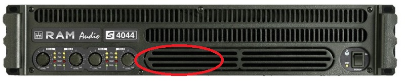

I am a happy owner of two 4-channels RAM Audio S4044 amplifiers (class H)
But one of them has a problem : even when nothing is plugged on it (no source, no speakers), it is getting quite hot.
The heat is generated only on the left side (see the red "circle" on the picture attached), but not enough to activate the protection mechanism.
(but this is probably because I am using it at low levels as it serves in a dedicated home theater room).
Apart from that, all 4 channels are working perfectly. But I am affraid that if I continue to use it without doing anything, the problem could get worst.

Welcome to diyAudio 🙂
We would certainly need to see circuit diagrams in order to advise you...
Given that the amp is working, and given that you say it is Class H (which means the supply rails powering the amp vary) it is a possibility that the heat is being caused by a problem with the supply voltage being stuck at a high level.
Don't be under any illusions about fixing this as it is almost certainly not a quick fix and it would need detailed measurement and testing to diagnose where the issue lies. At the very least you would need to be able to identify parts on the PCB and then be confident to make voltage measurements without shorting anything out.
At this stage it could be anything 🙂

You really do need the schematic...
In the mean time, you can remove the cover from the left channel (in the picture) and very gently probe with a gloved finger (for electrical insulation) to see what's getting hot. Once you tie it down to a geographic location on the board, it will be much easier to see the problem on the schematic.
Being a pro amp it seems to have comprehensive protection circuitry, so its likely to protect itself and your speakers if it does get worse. Could be as simple as bias drift in one of the channels.

That looks like quite an amp. If the schematics accurately include all those 'Txxx's marked on the board topside on the left, and other Test Points similarly provided in the power sections, success might not be completely out of reach. Keep in mind, though, Class H is among the most complex.

With no schematic and it not tripping and high cost of repair maybe its best to just use it until it dies ? If it has no fan the maybe leave lid off (if no kids or pets around.)
In addition to class H, this is a switcher supply amp. I see a tiny toroid in the upper right, and a forest of big capacitors, probably 400 v rated.
These are VERY DANGEROUS to work on. Buy a class AB amp of 100 to 300 W and develop your skills on something safer. The category in ebay is "amp for parts or repair" under consumer electronics or musical instruments. Buy something produced before 2000, when switcher supplies & surface mount parts became popular. Or fix or build a mixer, preamp or riaa board, which has pretty safe 15 v supplies.
