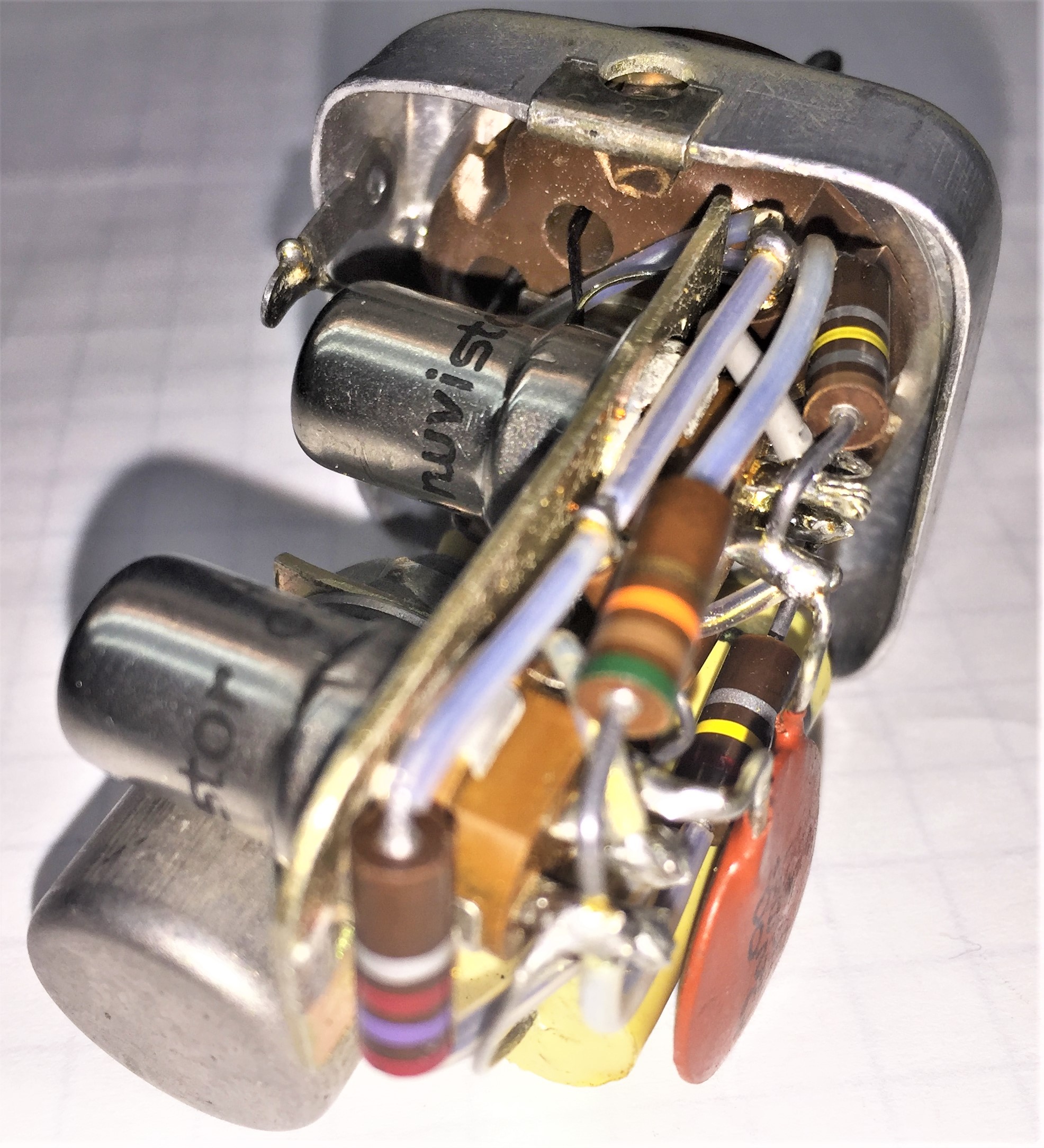

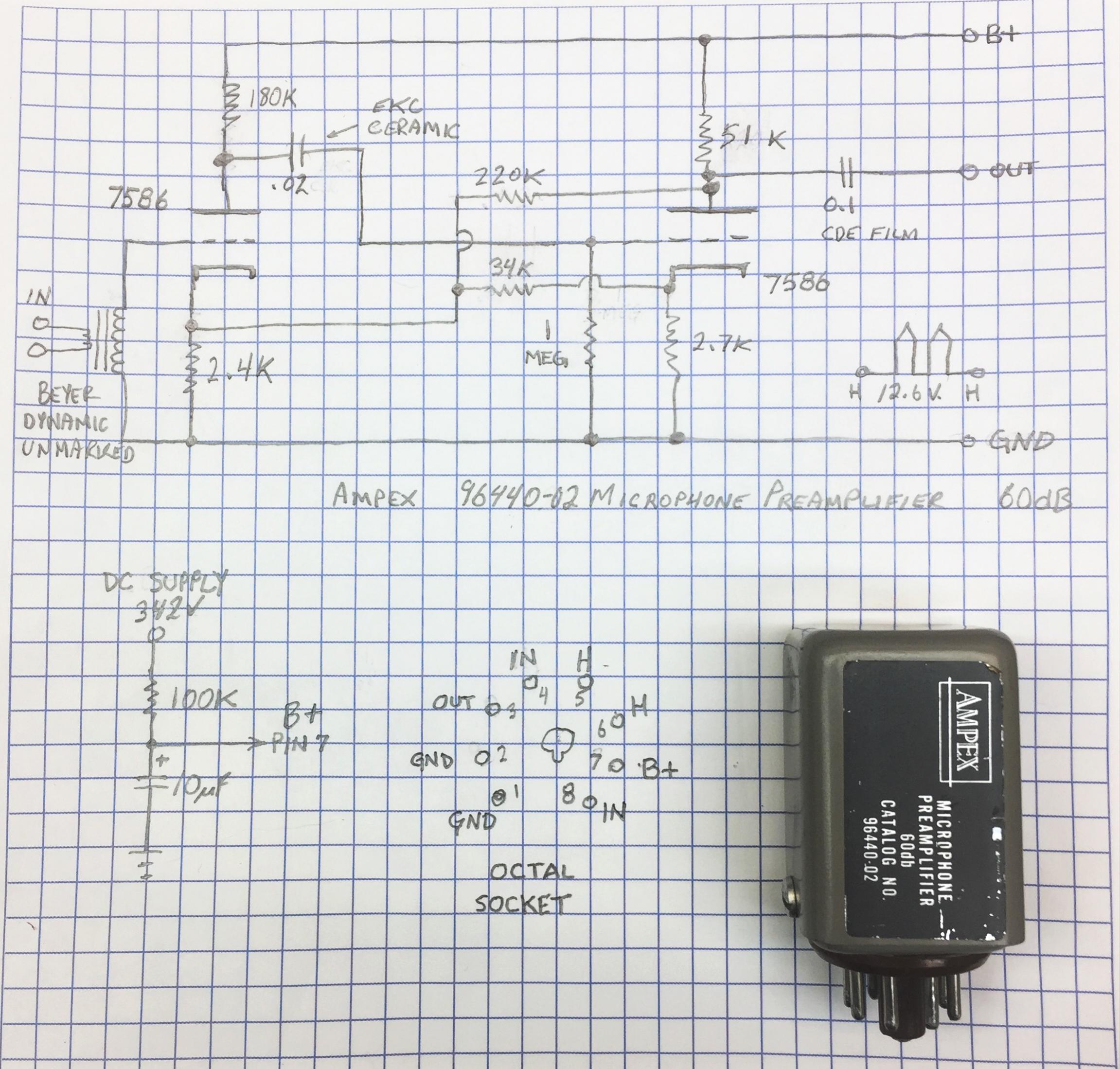

Schematic and photos of an Ampex 96440-02 Microphone Preamplifier plugin unit are posted here:
Ampex Mic Pre Plugin 96440-02 | Flickr
This preamp uses an unmarked Beyer Dynamic input transformer and RCA Nuvistor tubes, housed in an octal-based aluminum can enclosure. It looks similar to the 96440-04 preamp for the Ampex 354, but it uses different tubes and is not listed as an option on the Ampex literature I found for the 354.
DC voltage supply resistor/capacitor comes from the 354 schematic, assuming this model preamp is compatible.

I've seen the same can but with transistors. I suspect it was originally a can for optional input transformers. Stuffing TO-18 was tight; stuffing tubes is amazing (and hot!).

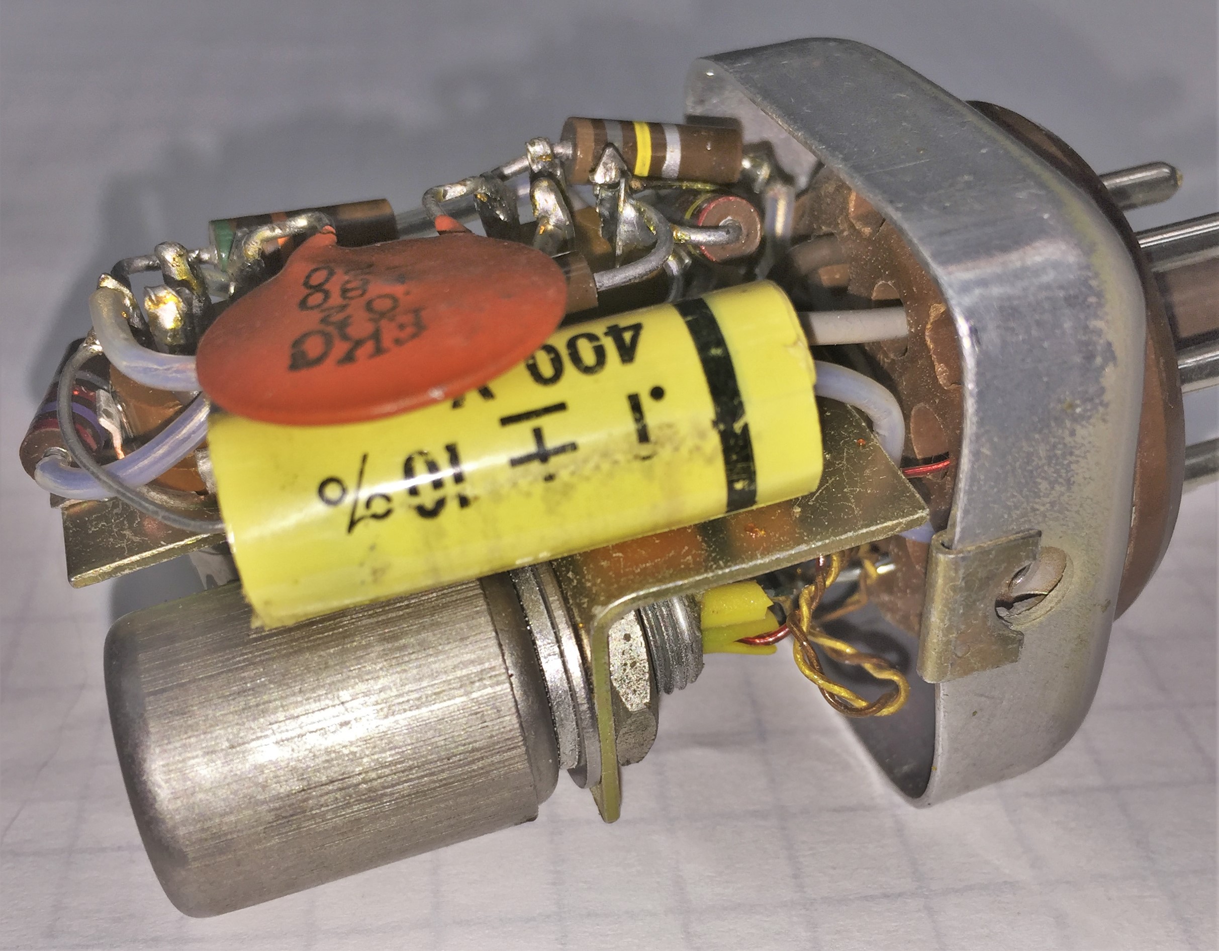

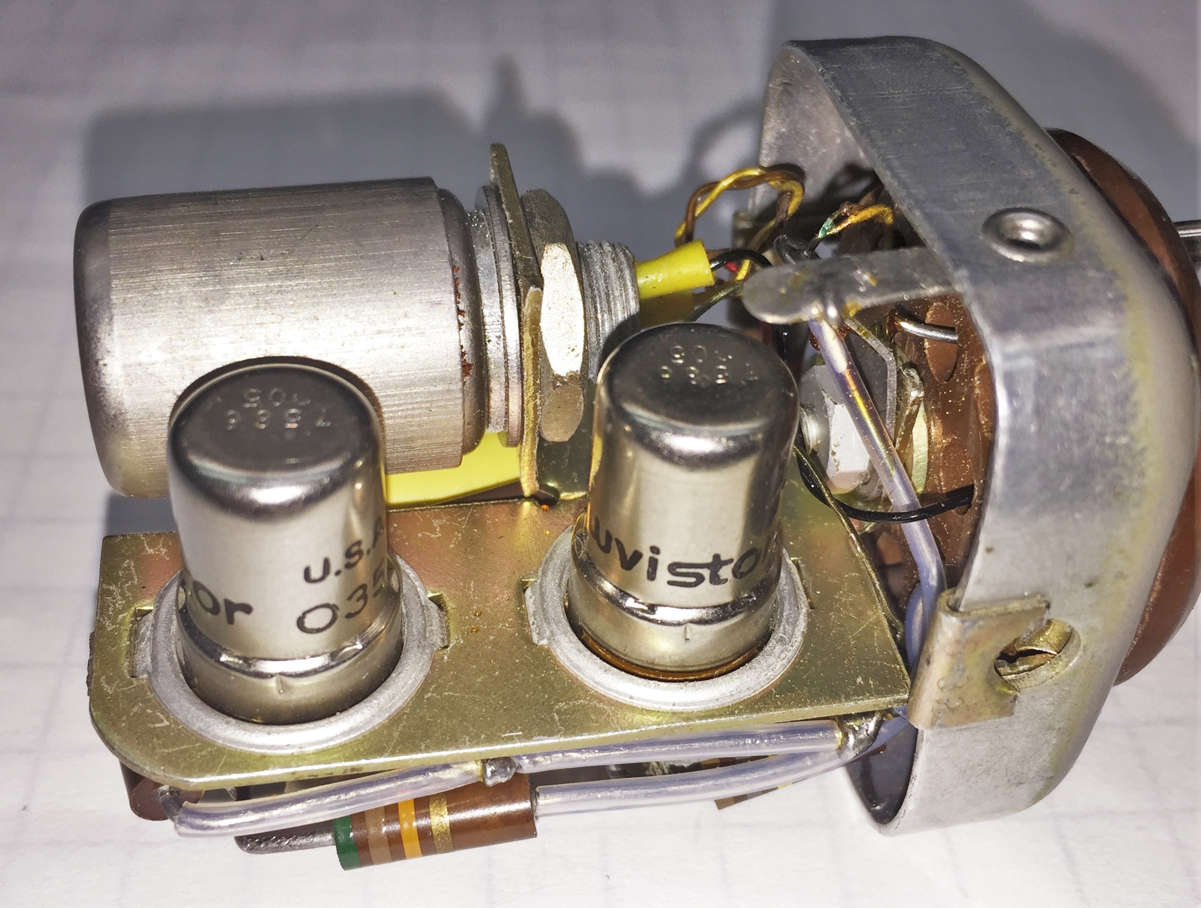

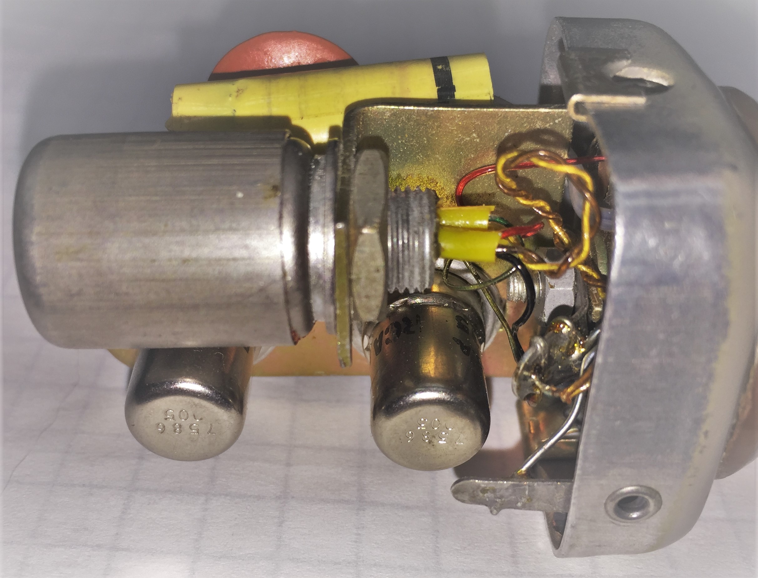

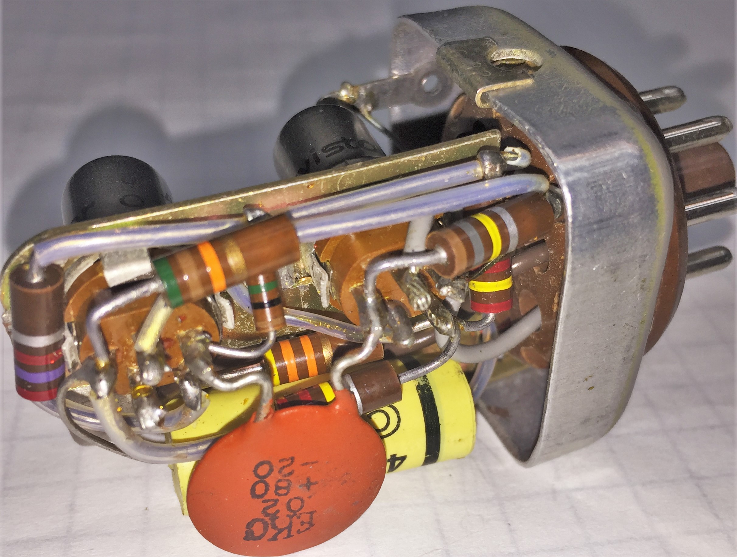

Sorry, I don't often have much time to post, and hadn't taken the time to look up how to attach files. They are attached here.
This was an impressively tight build !
Any opinions about it's quality as microphone amp ? Most if not all the parts are possible to source today..

I haven't tried it yet. I don't have a deck to plug it into, so I reverse engineered it in order to rack it up with power supply, line amp and attenuators. I've been curious for decades about nuvistors in audio applications. Back in the day, the RCA TVs with nuvistor front ends said "New Vista Color" on them.
