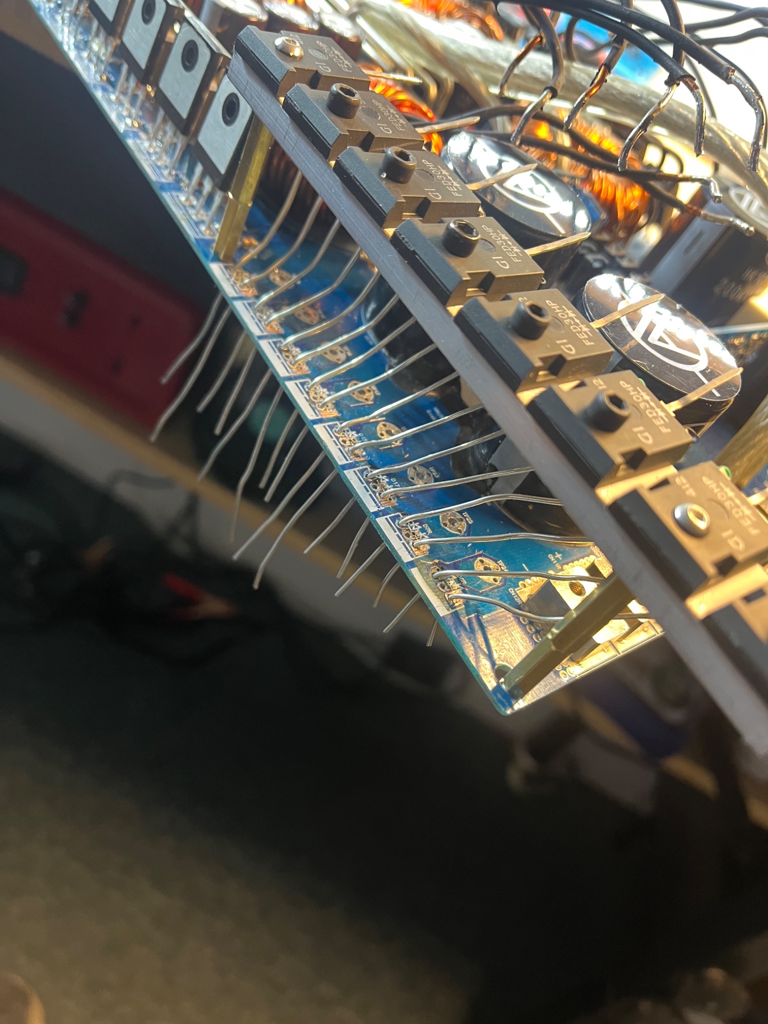

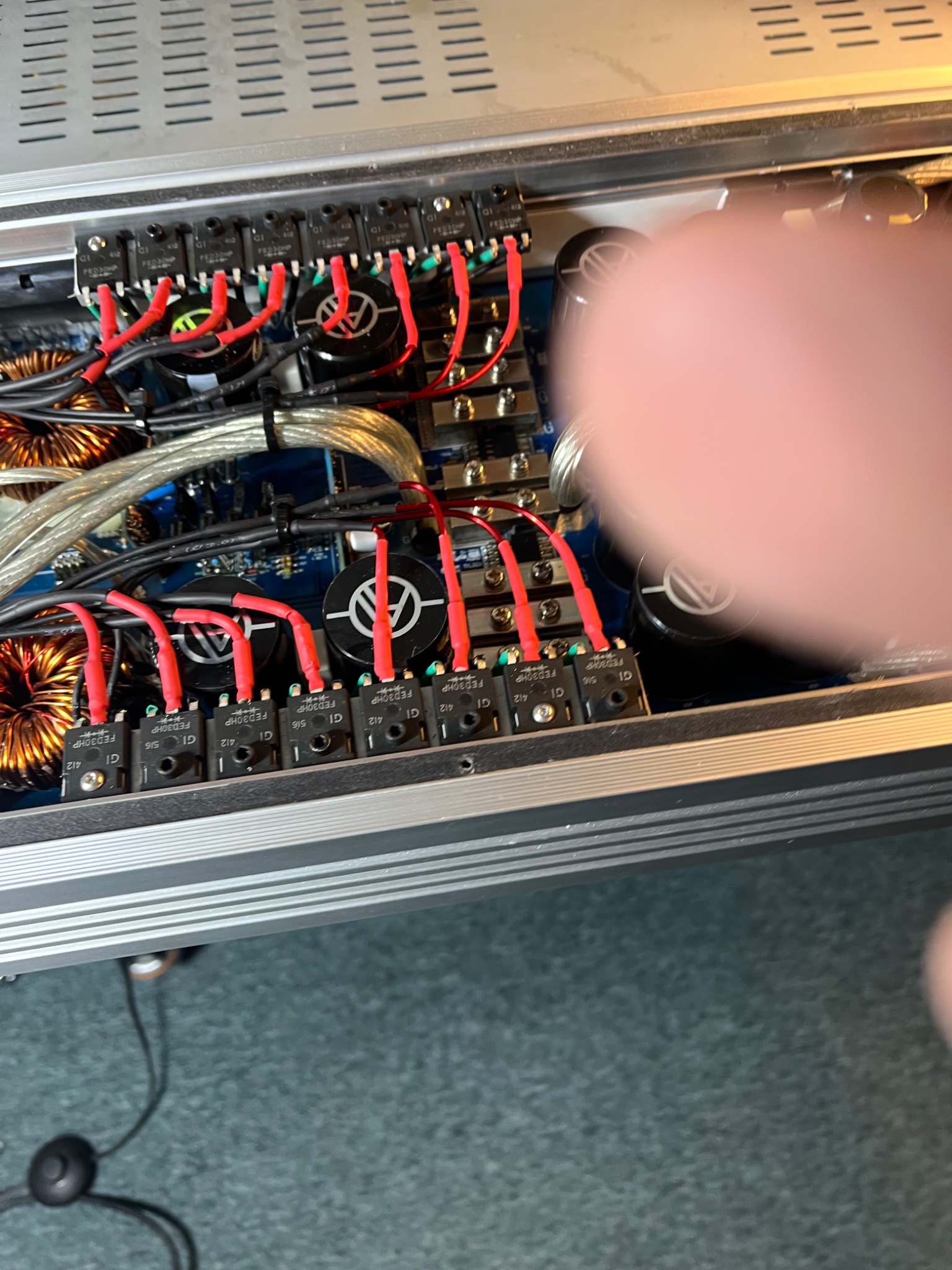

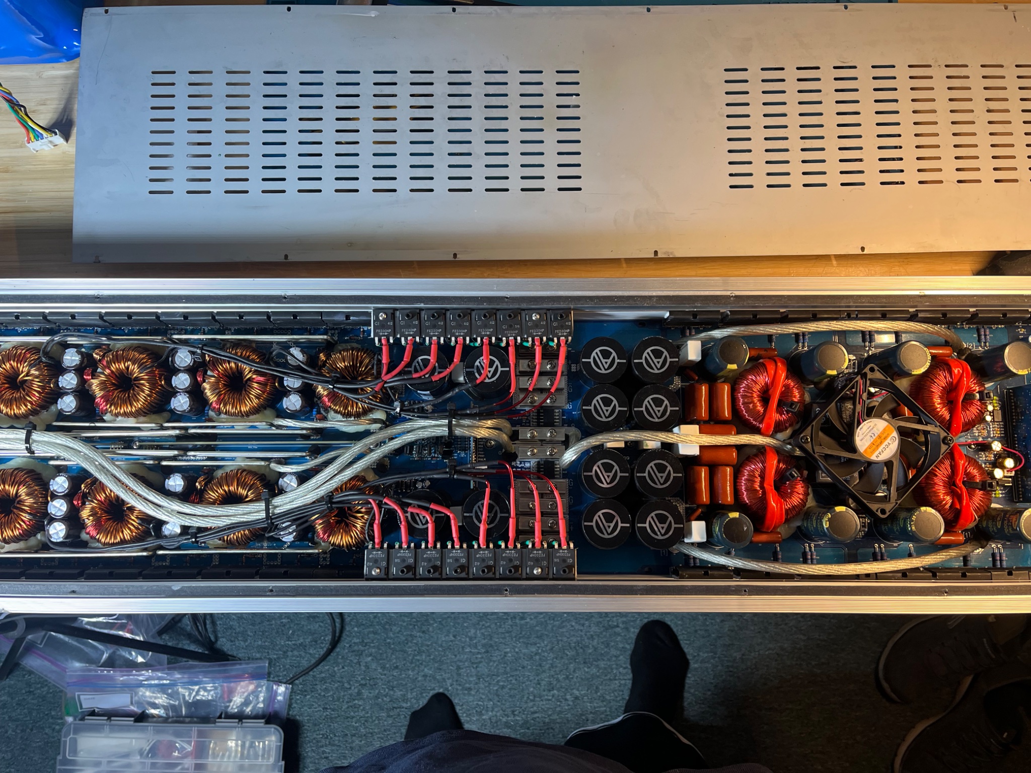

Hello, a repair technician told me. He said that he has had multiple in his shop where the rectifier diodes were a problem. I purchased mine broken. The power supply went down and all of the rectifier diodes on one side had the legs blown off. I couldn’t find the URF2060 diodes anywhere cause they are obsolete. So I reached out to anyone and everyone trying to find them and that’s just what the one tech told me. Thank you for responding, I appreciate your help.
That makes sense. I didn’t come across any other broken legs. The tech is Todd from Ellensburg amplifier and service. I think he only does warranty work now for a couple companies. Taramps and Ruthless Audio. He basically suggested getting creative and trying to retrofit something. He sent me some FMU22U’s just to get it running. I’m pretty new at this and I just bought your tutorial a little while back. I’ll attach a photo of what I did. And just to be clear this is my amplifier and I just enjoy tinkering. I definitely don’t want to see it go to the landfill. Just curious, if you don’t mind sharing what would you recommend for this amp with obsolete rectifiers. Everything I did is reversible. Thanks.

Nice work. Have you run it hard enough to see if the rectifiers will run cool?
If they run too hot, you could use double the thickness on the stock and drill through the heatsink to bolt the aluminum stock to the main heatsink.
What you did would be acceptable as long as they stay relatively cool.

I was thinking the same thing. I haven’t ran it too hard yet but I did run it until the output transistors got warm and the rectifiers were staying cool. So far so good I guess. Thank you so much for your kind words. Made my day. You have a great day also.😁
