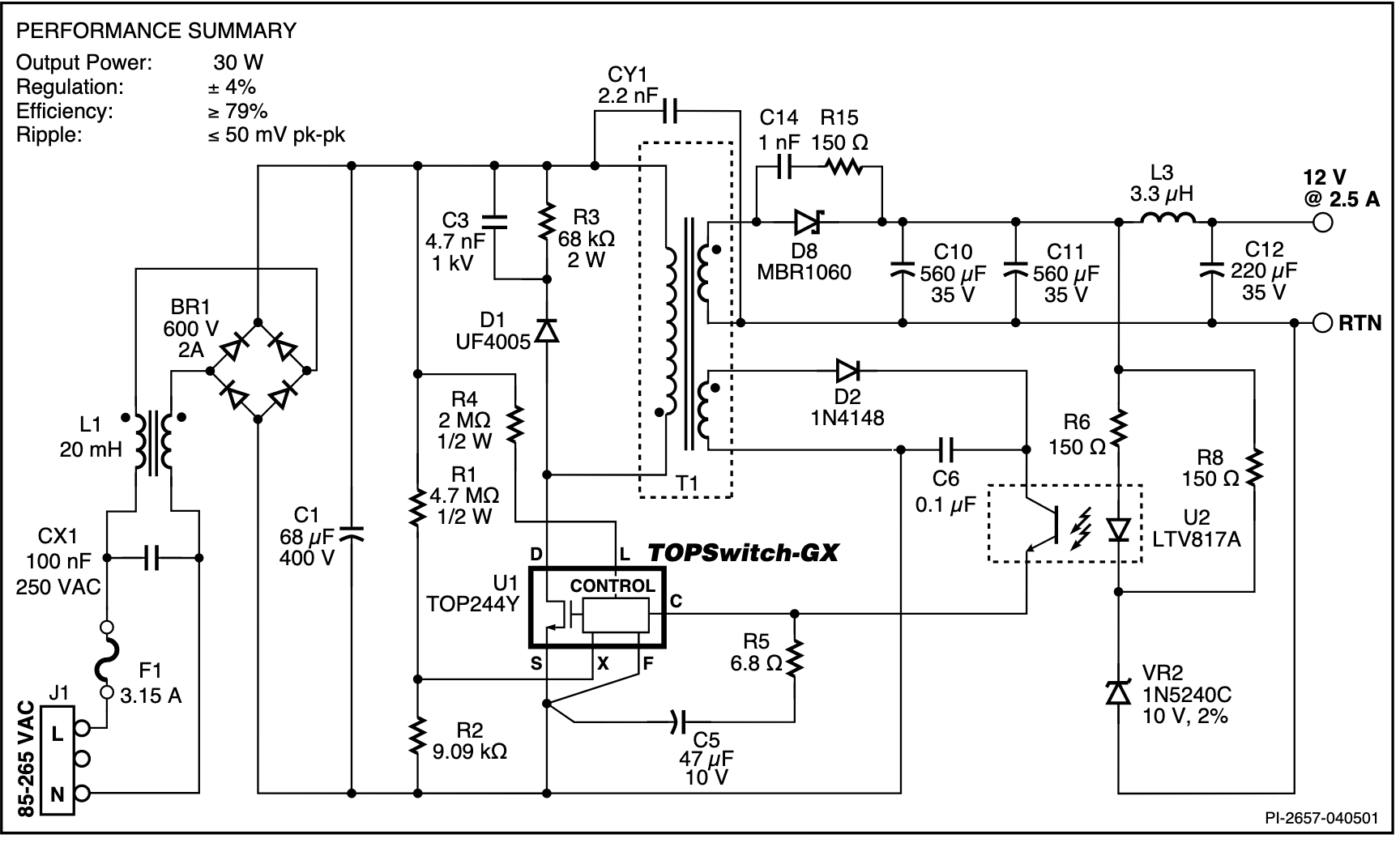

It is similar to the TOP249 range of power supply chips.

U2 supplies the low current and start up power, nothing will startup without the +15 supply.
They get hot because there is a tuning issue or they are running at the wrong frequency producing a corrupt waveform.
