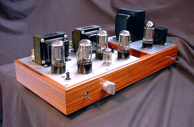

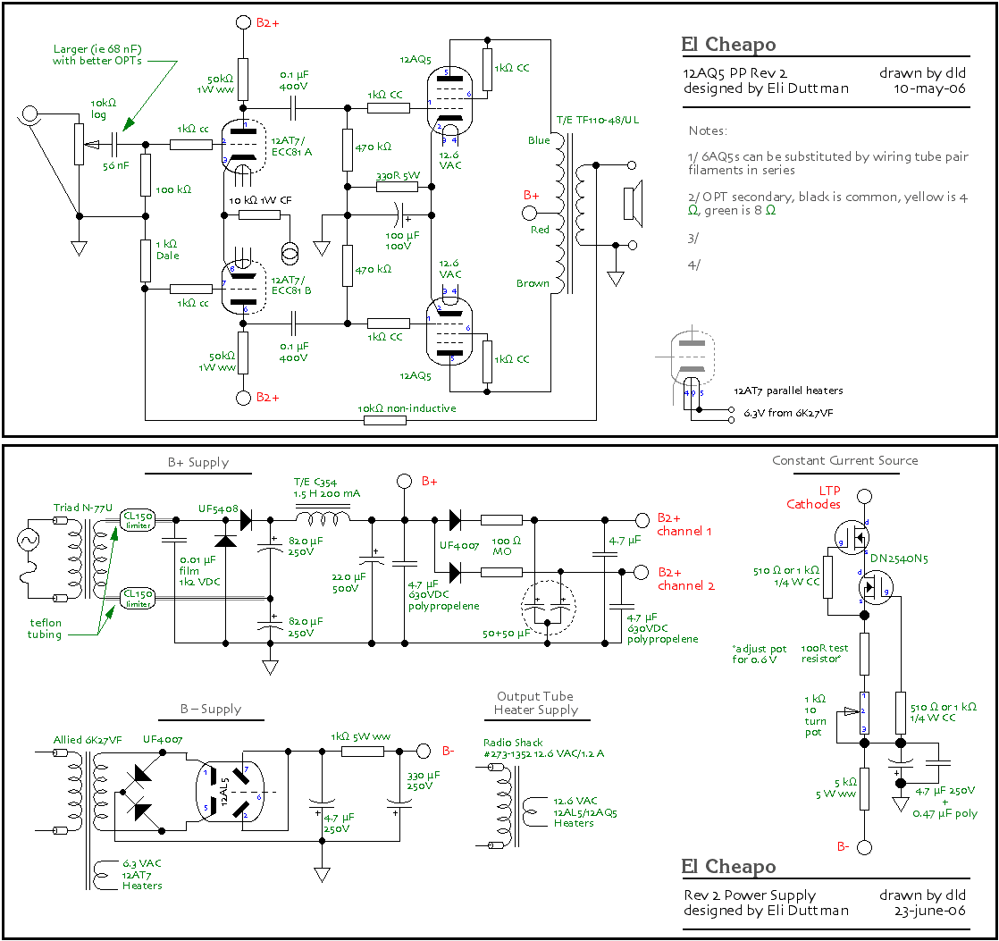

The budget is $500. A very well executed "El Cheapo" will pass financial muster. Build with "reissue" TungSol 6V6s and above average 12AT7s. Buy Dynaclone Z565 O/P trafos from Triode Electronics. A complete set of power "iron" can be sourced from Allied Electronics. Other than a chassis, for which a large commercial kitchen cake pan will do, tubes, passive components, etc. come from Jim McShane.
The Z565 is a price/performance champion. You have to spend MORE to get better performance. As you have a decent preamp, you don't need the volume control. The RC high pass filter at the circuitry's I/P changes to 0.068 μF./150 KOhms. Above average O/P trafos provide freedom from core saturation worry.
BTW, should you so choose, you could build with triode/UL mode switches. Triode wired "finals", as shown in the schematic, are good for approx. 6 WPC. That's PLENTY for your horns. However, being able to switch to UL mode gets you about 12 WPC and other speakers can be tried, with success.
The Z565 is a price/performance champion. You have to spend MORE to get better performance. As you have a decent preamp, you don't need the volume control. The RC high pass filter at the circuitry's I/P changes to 0.068 μF./150 KOhms. Above average O/P trafos provide freedom from core saturation worry.So, blocking the worst infrasonic noise is sufficient. F3 of 0.068 μF./150 KOhms is a "perfect" 15.6 Hz.
This looks good, but it's beyond my pay grade. I flip bits for a living (Network Engineer). I've got an electronics repair shop around here that could probably do it if I provide the parts. Is it worth it or should I try to buy one used?
"El Cheapo" is a DIY project. Those of us who worked on it placed it in the public domain. The people who built the project are highly unlikely to part with fruits of their labor, as it sounds too d@mned good.
You will have to factor your tech's labor into the overall cost. $500 buys the top notch parts, but I doubt you'll have much left for labor. Edcor offers decent O/P trafos at lower cost than the Z565s, but ...

What do I mount it on?
An aluminum plate in a wood frame is a common choice. A large, heavy gauge aluminum, commercial kitchen cake pan is another cost effective option. Check this out.
I built my Tubelab Simple SE into an aluminum roasting pan. It made for a nice, sturdy, cheap chassis.
The SSE might be another choice. I think mine came in around $500, using Transcendar OPT's, an Allied power trafo, and EL34's. It's a simple build on a single circuit board. Sounds nice with full rangers, though I've never had the chance to hook it up to a Lowther.
