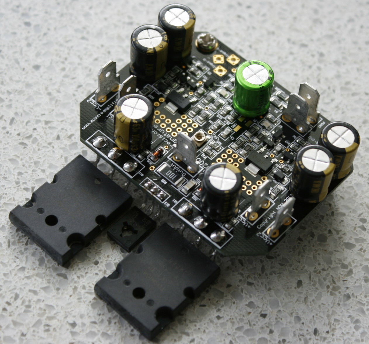

@geierasul: Nice idea to mount the power devices beneath the PCB. keeping the total footprint small. But won't it lead to mechanical stress at the devices when tightening them after soldering has been done?
Best regards!
Best regards!
To long wiring to output transistors, and maybe newer output types with higher Hfe?
You may have nailed it there - I did but the PCBs in a new chassis and had to increase the length of the wires to the output transistors, then it started blowing fuses when it had been working perfectly before. Thanks very much for your suggestion.
One of the reasons I'd like to rebuild my amp is to tidy everything up on the inside and not have such a bird's nest of wires.
Joe
But why is that any different from mounting the above the board? And why not solder the devices after mounting them on the heatsink?@geierasul: Nice idea to mount the power devices beneath the PCB. keeping the total footprint small. But won't it lead to mechanical stress at the devices when tightening them after soldering has been done?
