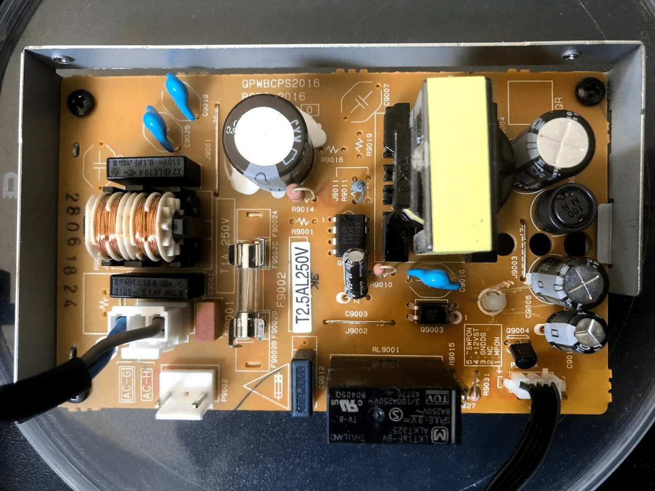

Thanks for the reply! Here's what the power supply board for the VSX-933 looks like. Frustratingly, this unit IS (was) sold internationally, so this board SHOULD exist as a 240V version, but I can't find it anywhere and I can't seem to find any Onkyo substitutes.

From the component ratings, it looks like your PCB is meant to operate from 240V, not 110V. Further, it also appears to be a standby power supply, rather than the main one.
I think a simple 50Hz / 1-2kVA step-down transformer with a 100V secondary rating would do just well for both items together.
