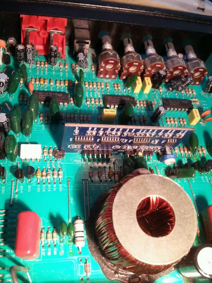

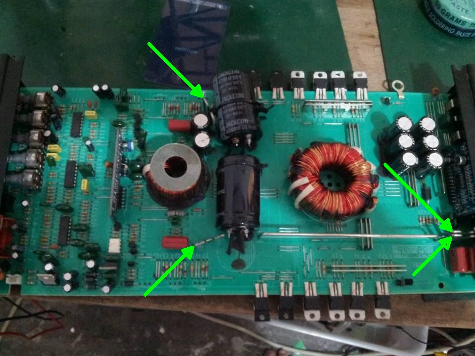

I have a mono amplifier 850 watts rms with an issue. This amp protects at mid volume. Capacitors are new but have some repair in driver board and some external circuit.
I wondered why i'm measuring -38V on Pin 3 or Pin 4 of the driver board terminal. I don't know if this related on this issue.
This amp is generic or china made amp, pls see attach image.

'Mid volume' doesn't tell us much. Does the shutdown occur at precisely the same output voltage regardless the load (no load or toughest rated load, shutdown at same output voltage?

First I thought it protects due to lower supply voltage but it doesn't. I've tried 10Volts supply and the amp still good at lower volume.
I think the amp protects at the same amount of output voltage.

Is it -38V found at the terminal of Driver board is normal? The only higher supply voltages found on this driver board is +-15V for comparator supply.
What are the ICs on the driver board?
2 x NOR gates, 1 x LM219 (2 hi speed comparator) and 1x LM4568 (opamp).
I think this may be a 6n137 amp but you're not giving us much to work with considering that this is not a common amp. Post more photos of the entire amp.

Is the opto-coupler a 6N137?
Does it have three 5v regulators?
Perry, Yes, It's 6n137. Please give me some time to check the part number of TO220 regulator...I know one is 5V, 7805 regulator.

Follow up question, do you know the voltage rating of the two zener diodes? I measuring 12 volts here.
There may not be a 3rd 5v regulator. It may use a the opto-coupler to drive the high-side FETs and transistors to drive the low-side FETs. If you can confirm that, it may be helpful.

I think I know basically what this is. The DB Drive amps use something similar but use a different modulator board.
If you adjust the potentiometer on the modulator board, does that adjust the DC offset at the speaker terminals?
Does the amp go into protect with no load?
If you adjust the potentiometer on the modulator board, does that adjust the DC offset at the speaker terminals? yes the dc offset changes if you adjust the potentiometer.
The amp didn't go to protect mode if no load.
The optocoupler supply comes from one 7805 regulator.
There are 3 over-current shunt resistor circuits from what I can tell, I'd jump each shunt resistor to see which one is causing the shutdown and then trace the circuit back from it to see if you can find the fault.
May I know what is the size of this resistor? Are these resistors place series with the rail supplies? I've seen 3, 2watts resistors connected to rail supply and goes to driver board.
