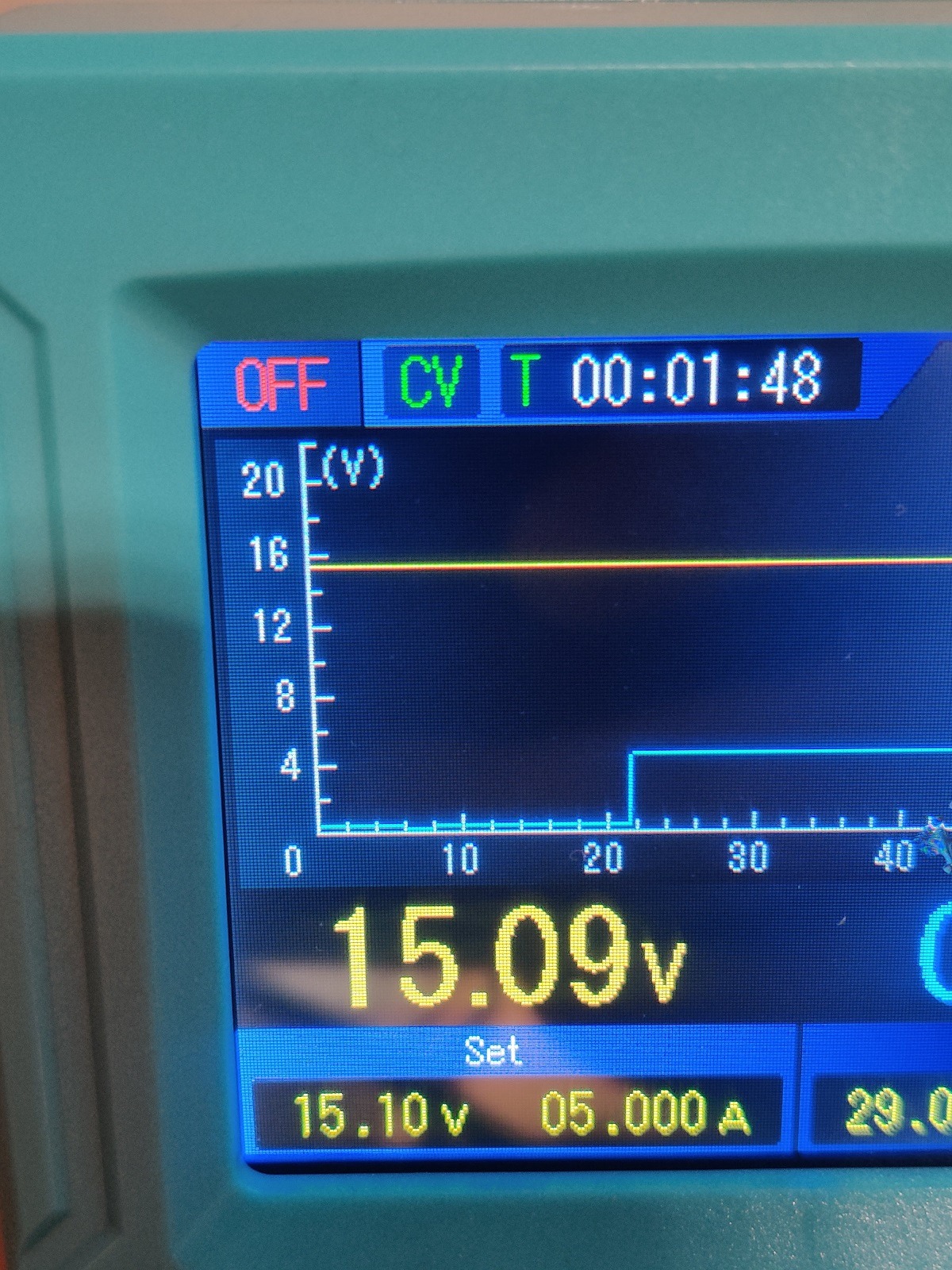

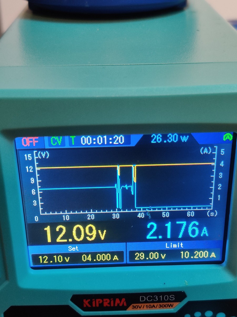

Voltage across B+ and ground on the 2A supply?

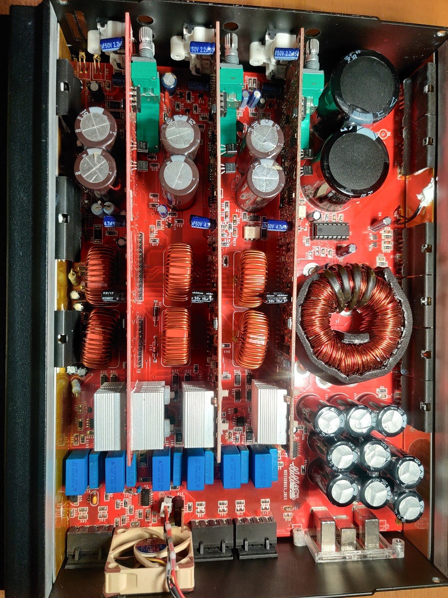

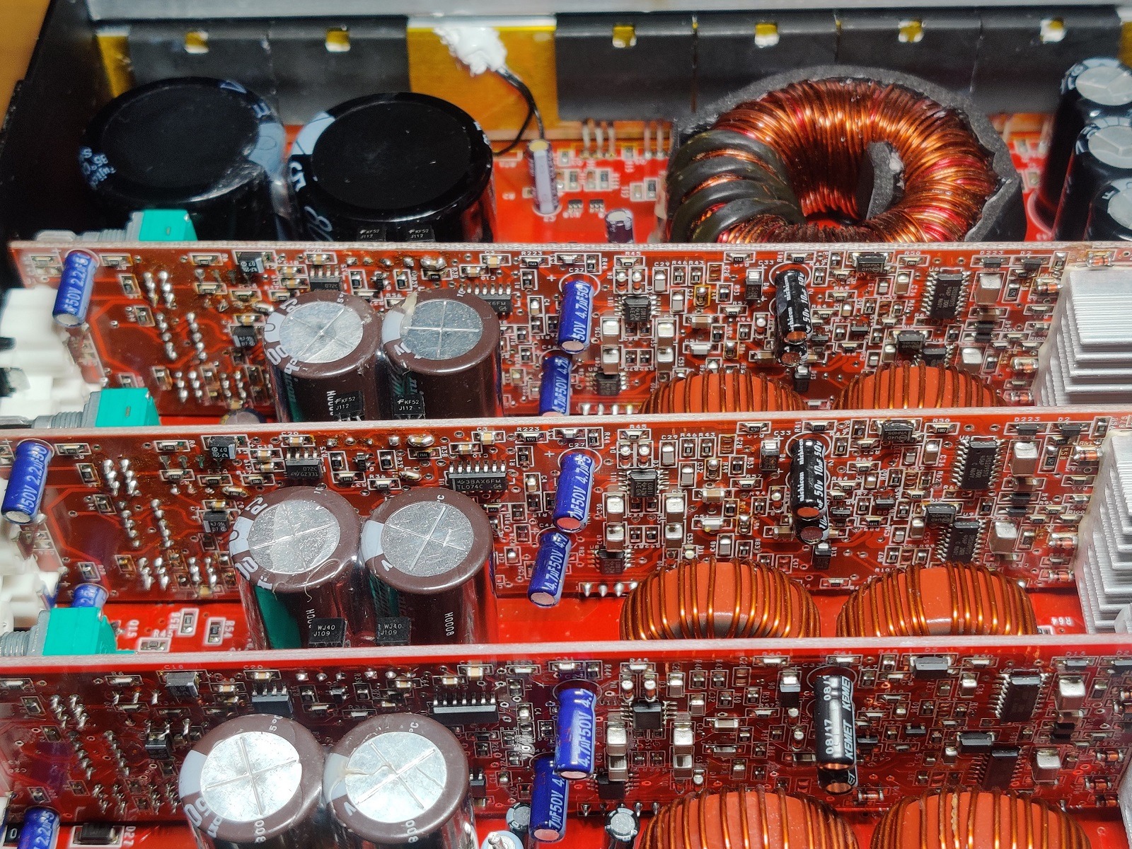

Post a good quality photo of the component side of the entire main board and the component side of any driver boards if no one can help.
Hello sure thing,
as per the voltage here:

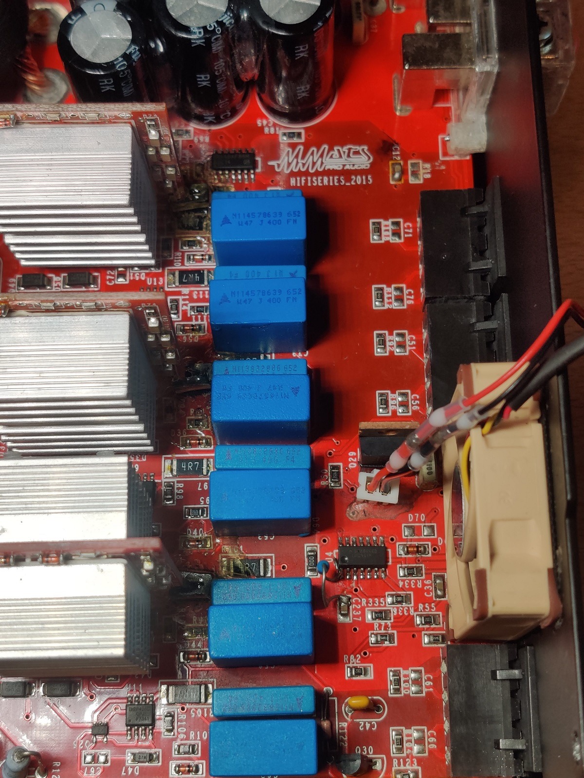

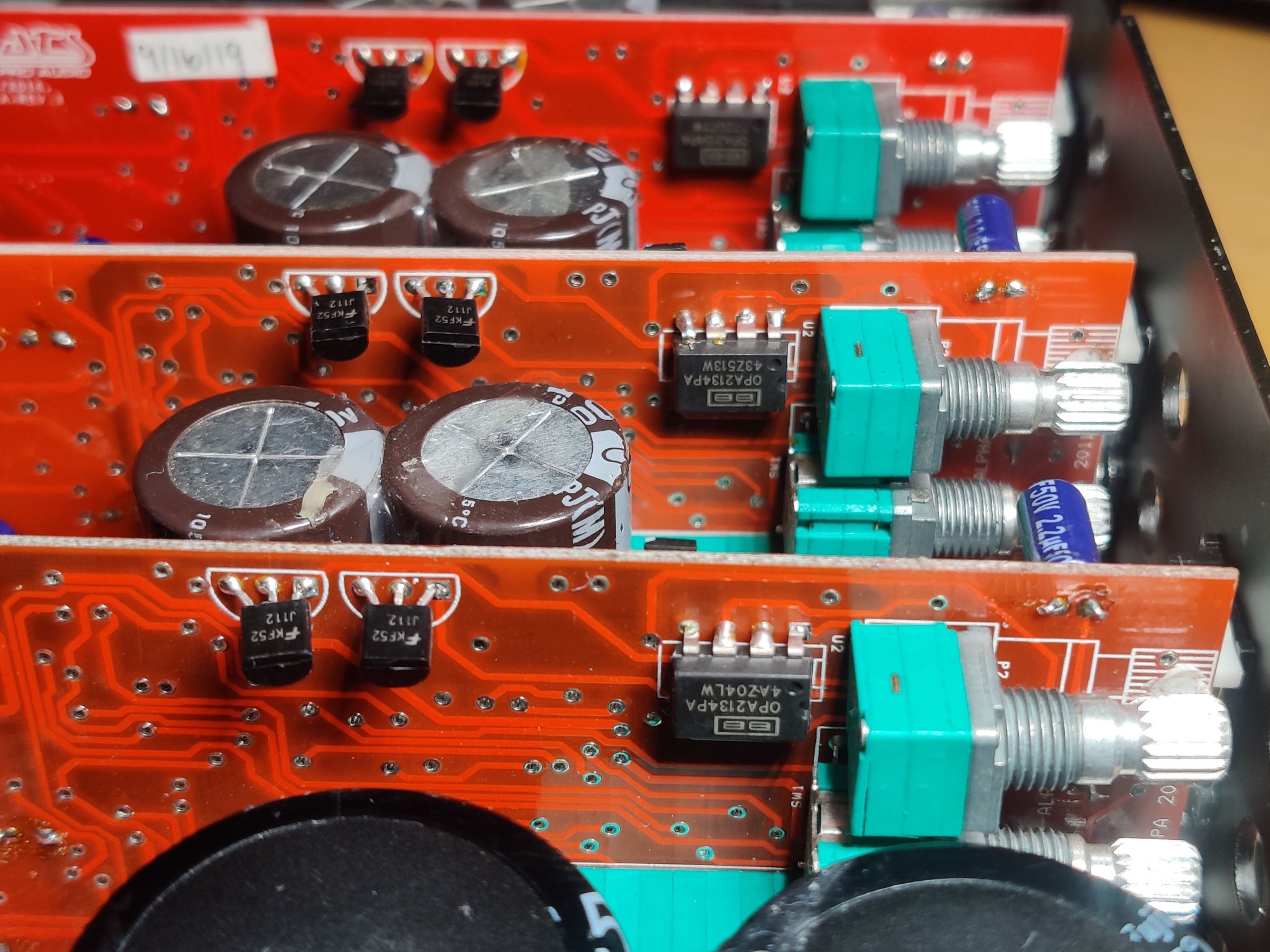

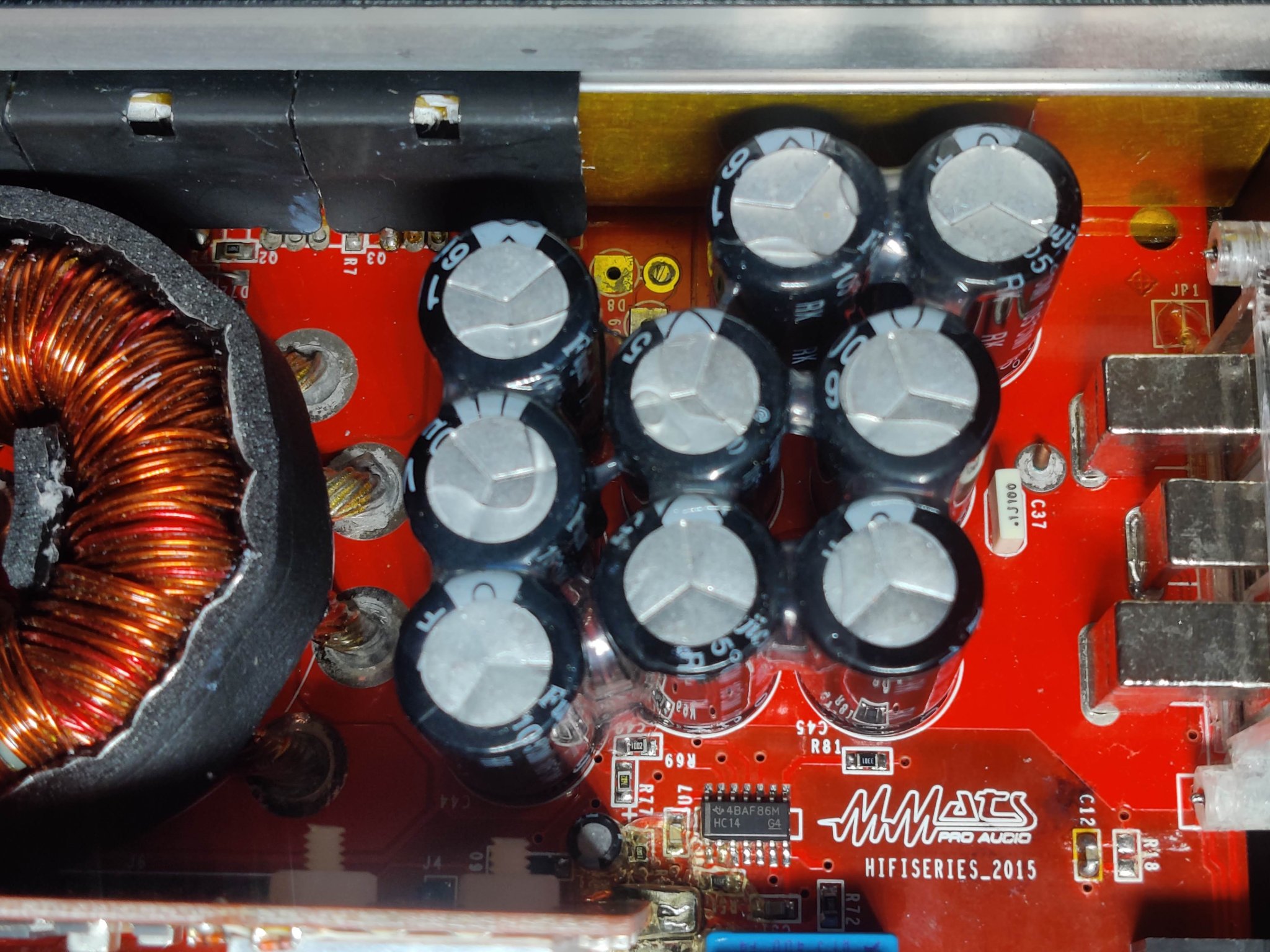

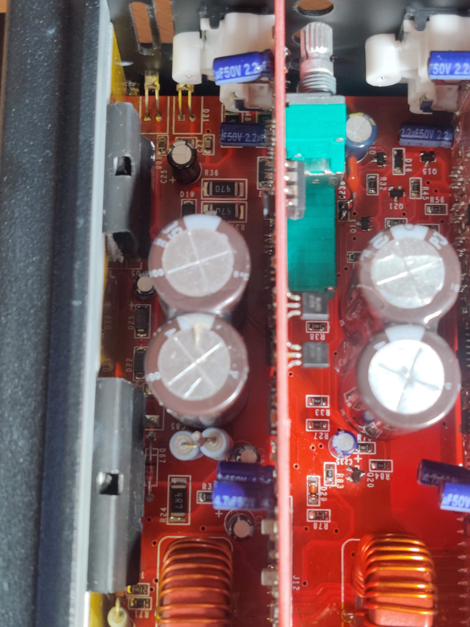

Some amp pictures:

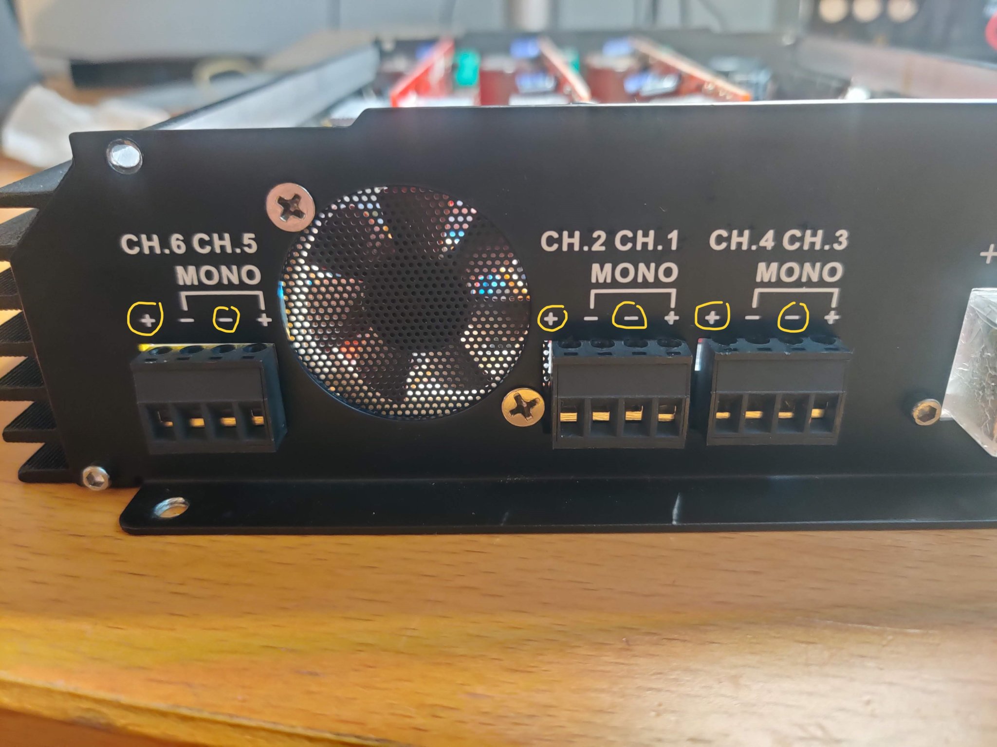

I did notice the circled outlets were all reading continuity.
Some amp pictures:
Oh yes,
Those circled speaker terminals read continuity on my DMM, well the Pos/Neg pairs nearest to each other.

'Continuity' is meaningless. An incandescent lamp will read 'continuity' but isn't a direct short. Use actual resistance in the future.
Those terminals are directly connected to the secondary ground (and possibly the primary ground) in the amp.

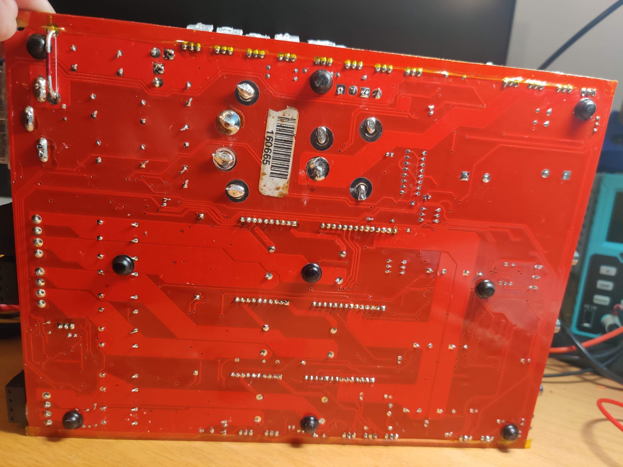

Have you taken it out of the heatsink to see if there were any burned traces or bad connections under the board?
Sure thing, I just emailed them with a summary of the issue. And yes I have taken the board out of the metal casing to look under and everything looked just fine no burnt spots. I also have one of those little "TC1 Multi Function Component Tester" from amazon and maybe test each MOSFET with in, I think i should be fine testing in circuit with those particular components if memory serves me right.

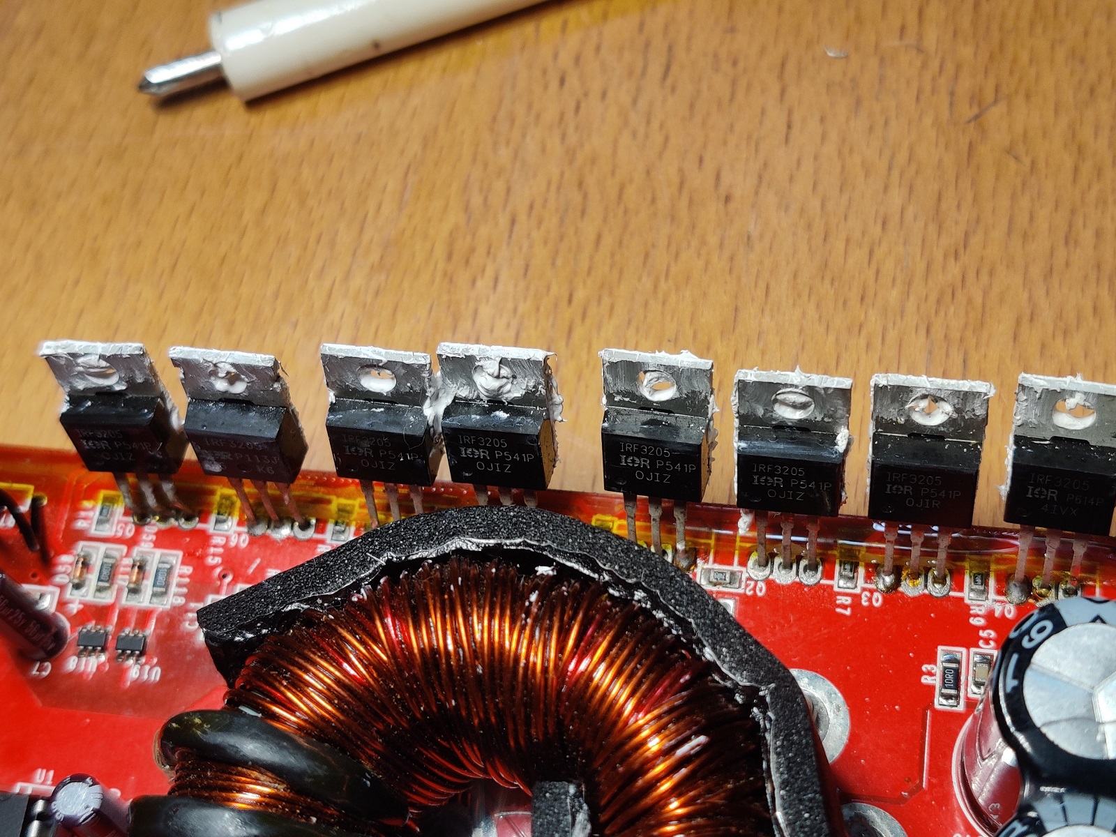

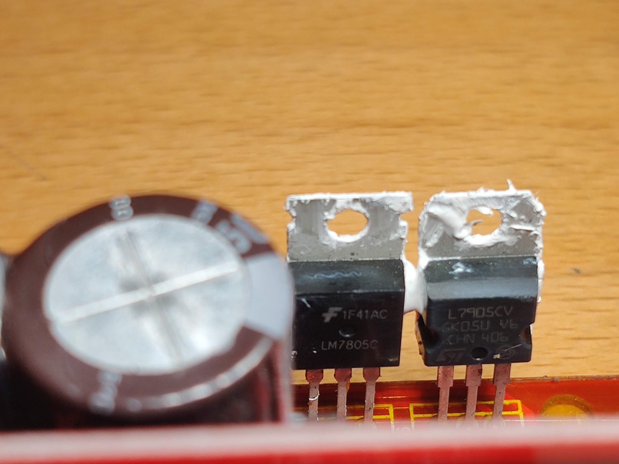

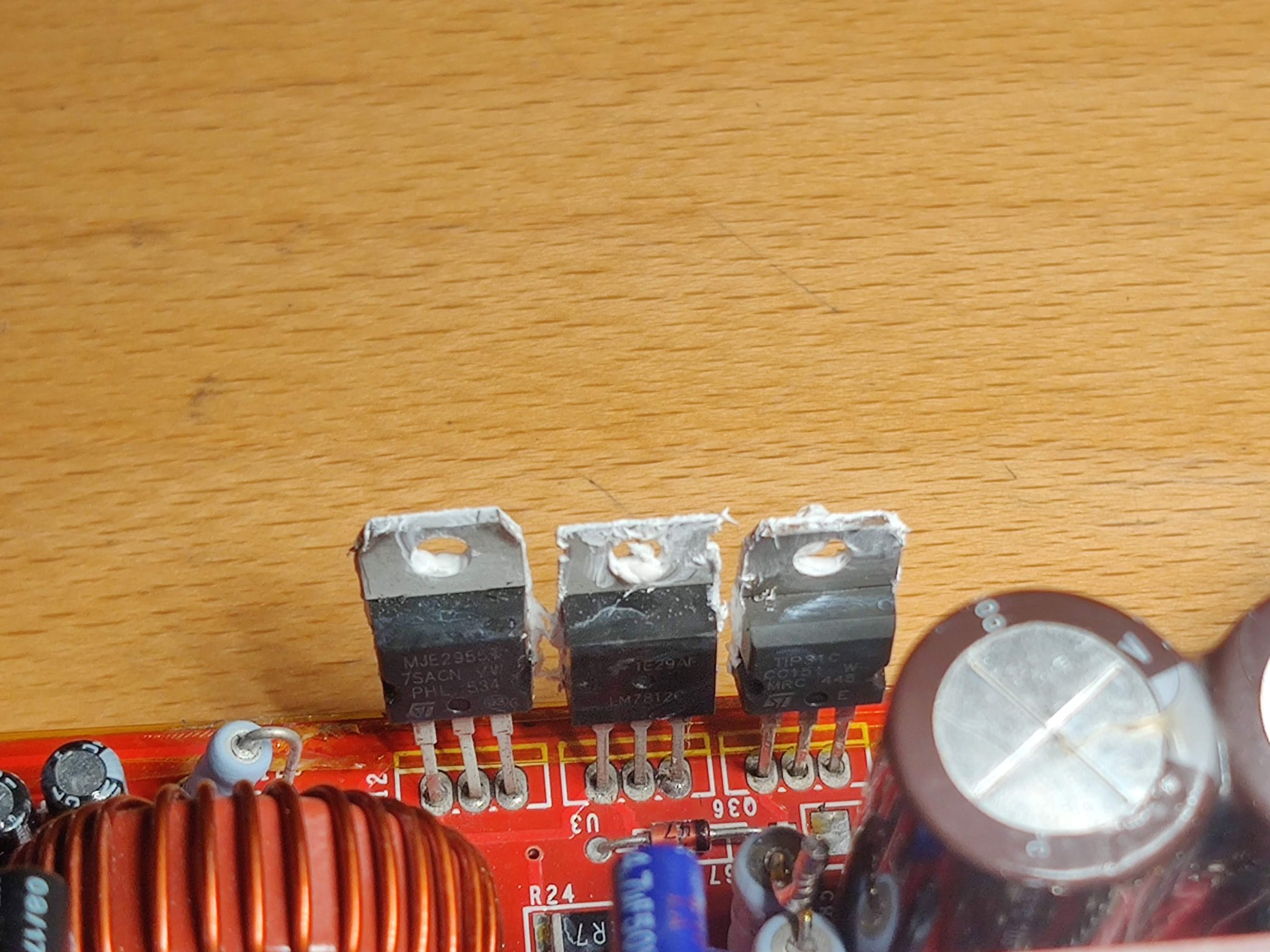

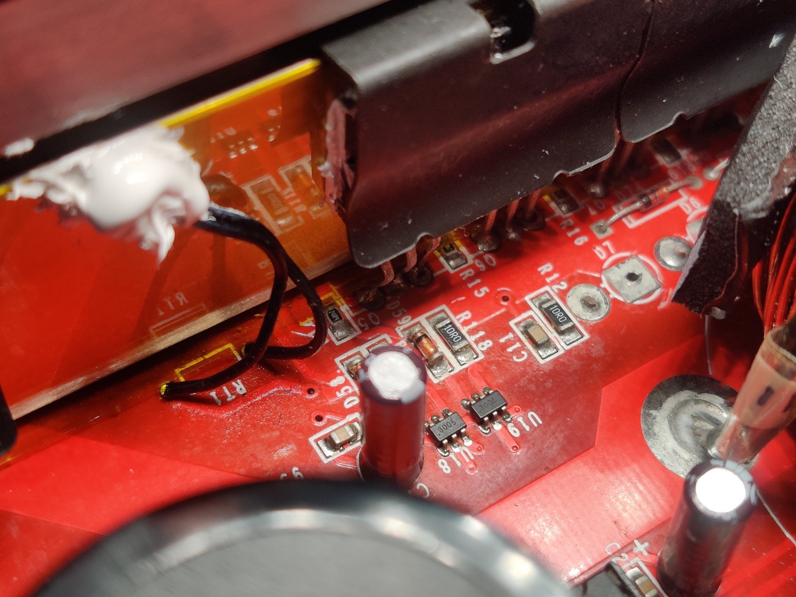

I took the amp board out again for another close view:
I also did the following impedance measurements:
POS + NEG : 0 -->50k
POS + REM+ NEG: 0-->2M
REM + NEG: 1M
POS + REM: 1.42k
Circled speaker terminals: 0.1
I also took two random power MOSFETs out and tested good. Lastly, I noticed that the amp stays in protection with the POS and NEG connected but goes "normal" (blue) when I put 12v on REM.
**I also just measured the ESR on all electrolytic caps on the power side and the large group of medium-sized caps have an ESR of 5-8 milliohm and the two large caps measure at 35milliohms

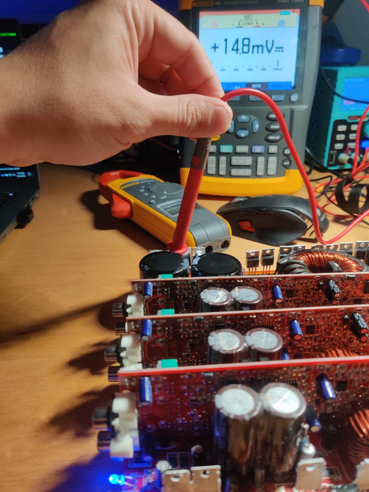

For what i can see, voltage never changes, just amperage. The amps got to 2A when normal [right side] and 0A when on protection (POS and NEG connected only)[Left side]

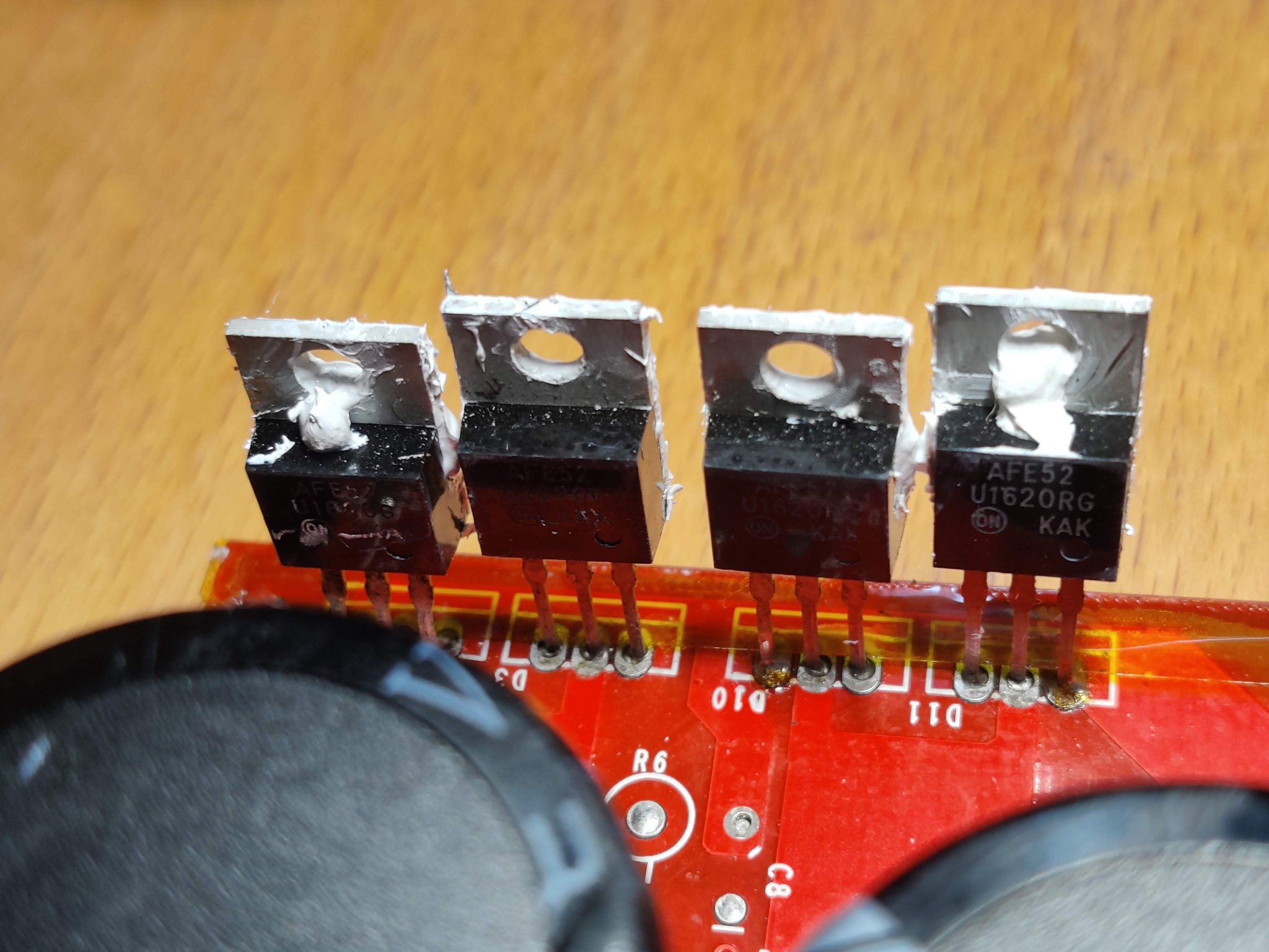

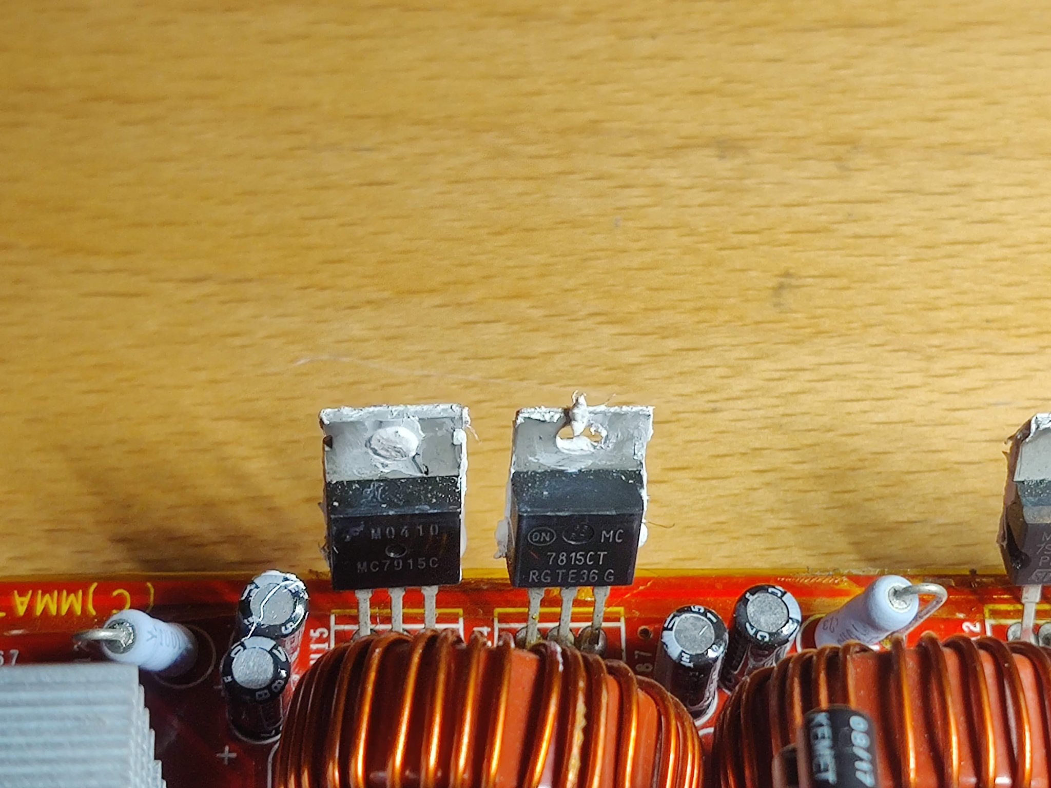

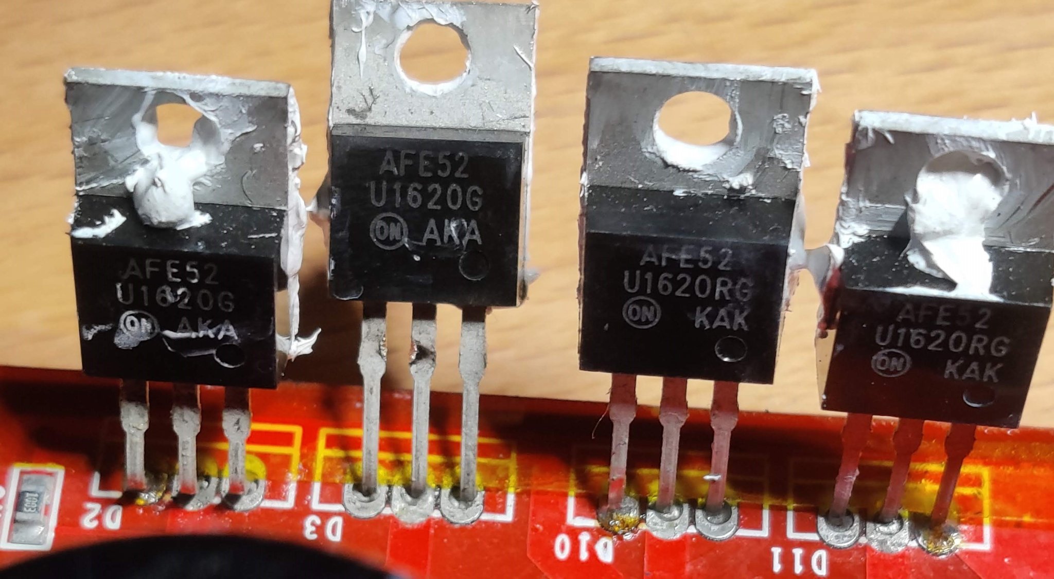

If youre talking about these guys, i did a quick search and they pop up as rectifiers, but I think they might have a different pinout as the middle leg threw a large spark and made me jump hahah. Ill have to find their right pinout later.
KAK is a center tap.
What sparked? Did you short the legs together? A scope or multimeter wouldn't make a spark.

Yeah, it seems it was my fault, my current leads are cheap thick ones. Im gonna order some better ones.
Just tested again and it doesn't seem I have voltage on both negative and positive rails. Interesting that the amp is showing itself as "normal" (blue) though
That's not rail voltage. Place the black probe on one of the terminals you circled if you're not using the secondary ground for the reference (black probe).
