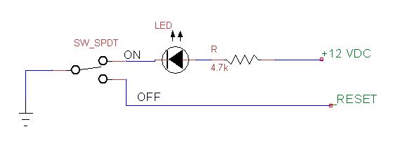

Hi All, newbie here so not looking to take up much of anyone's time. I built a pair of MTM speakers (Dayton RS180's) and am now looking to build an amp for them (rather than my old Cambridge A5 amp that is giving up the ghost!) using TPA3255 and LRS350-48. My question is on a power switch for the new amp I am hoping to use a push button switch but need a light to go with it to show it's on. As I am a relative beginner in electronics I am hoping to avoid a low voltage light switch and the relay necessary for it on the 240v side so will either use a 240v 16amp illuminated toggle switch which looks a bit ugly or a push button that then needs a separate light. As I'm trying to keep it simple can I somehow run a LED from the low voltage side of the power supply with a resistor to give me the 'on' light?? I hope this makes sense. Thanks for any help

You will need to study the application examples, but IIRC the way to put the amp into powered-on standby with the outputs turned off is by holding the RESET pin low.

The lamp circuit itself is pretty simple... See the thumbnail.

Thanks Doug - big learning curve for me but interesting. Still getting my head around the reset but that helps a lot.
Glad to help...
The switch circuit I gave you cheats ... when it's ON it allows the reset pin on the chip to go high, enabling the amp and turning on the LED. When it's OFF it holds the chip in reset and turns off the LED until you turn it on again. It's pretty simple.

So as a quick follow up if I am understanding this - By using the switch circuit this will be my main on/off switch for the amp. I was going to put it before the PS but this will be after the PS. So if I understand correctly I will not need a switch before the PS so there will be a 'permanent' current through the PU while the amp if off - this I take it is not an issue and if my reading is correct it is better for the amp to 'power down' via the amp rather than on/off before the PS. Hope that makes sense.

My little switch trick simply holds the amplifier chip in standby mode with it's outputs in high impedance state and the PWM oscillator shut off. Thus a very low drain on the supply.
Yes you could put an AC switch in there as well. But you should treat it as a "babysitter switch" much after the fashion of the one on your PC. Leave it on all the time unless you have good reason to turn it off (for example, when your kids are with a babysitter and you don't want the system to be messed with). Use the standby switch for normal on-off activity.
