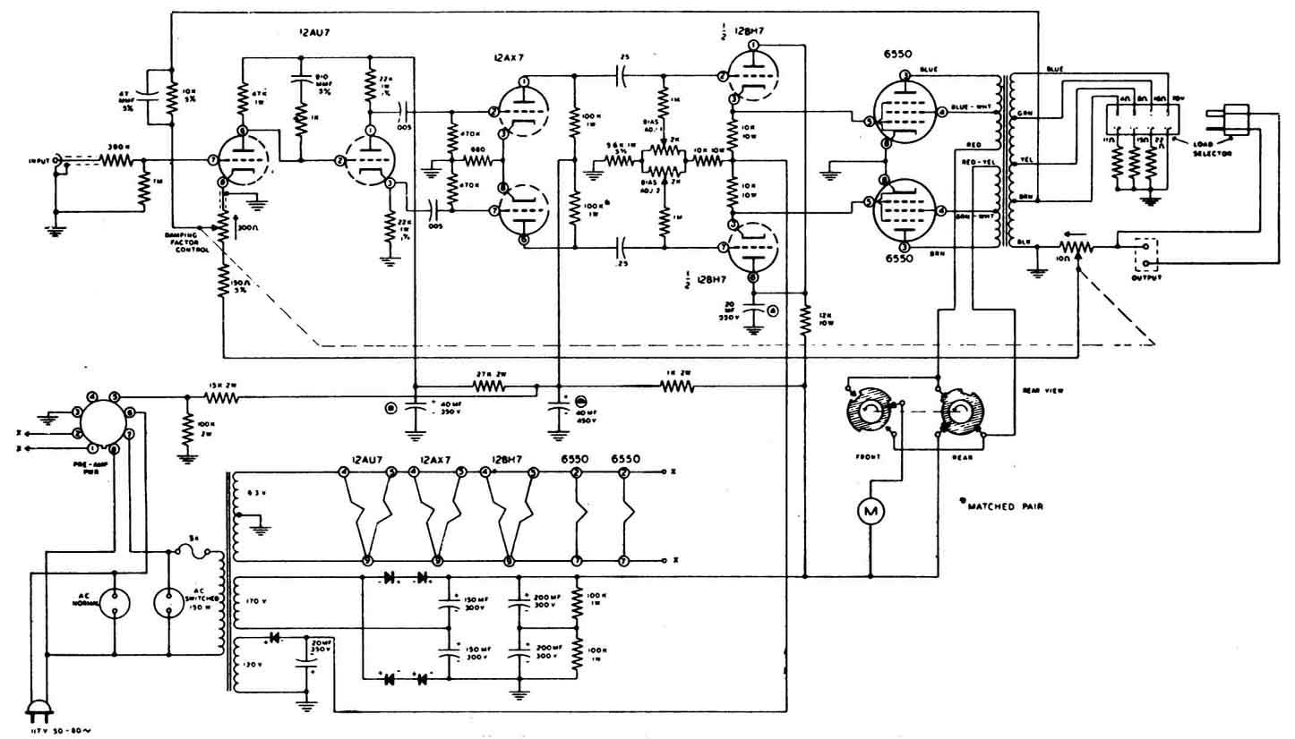

Eli, I will look into the Heath W6M. Any recommended alternative to the Hammond?
Low frequency instability is the "Achilles Heel" of Williamson style circuitry. First class O/P "iron" is appropriate, to hold phase shifts down. Heyboer may be able to "duplicate" the stuff Heath used. O'netics, ElectraPrint, and MagneQuest are other winders that may help. It will not be inexpensive, like Hammond. However, you have nice speakers that deserve GOOD amplification.
Remember, I said point of departure. The topology is fundamentally sound, but gain structure can and, IMO, should be altered to be compatible with modern digital sources. Also, 100% high transconductance (gm) small signal types should be selected for their resistance to slew limiting induced by the HF error correction signal out of the NFB loop. FWIW, I'd eliminate the damping factor adjustment and make the panels obey orders.

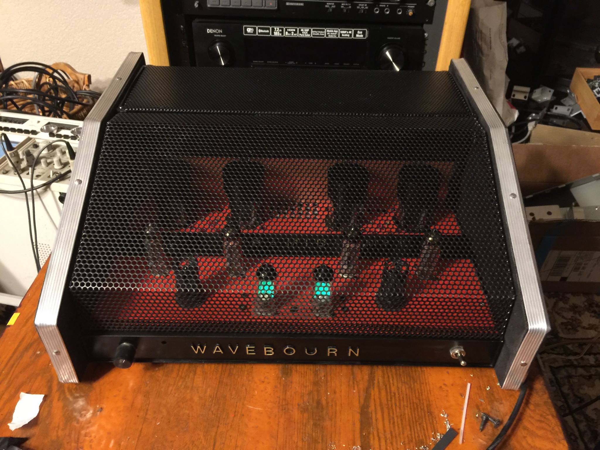

Thank you for all for the feed back. It looks like I have a lot more research to do. Wavebourn, do you have a schematic available? I sure would like explore your option. kstagger, I have heard Threshold amps in the past and liked them very much, but they are out of my price range. Eli, the Heath kit so far looks like what I had in mind, selecting a opt in my price range will be a challenge.

Mike is right about the MK3s being of use. They can donate their transformers to a new pair of Mullard circuit monoblocks. Everything else, especially the POS C354 choke, goes into the "junk box" or a dumpster. A heavy walled, commercial kitchen, aluminum baking pan makes for a cost effective chassis.

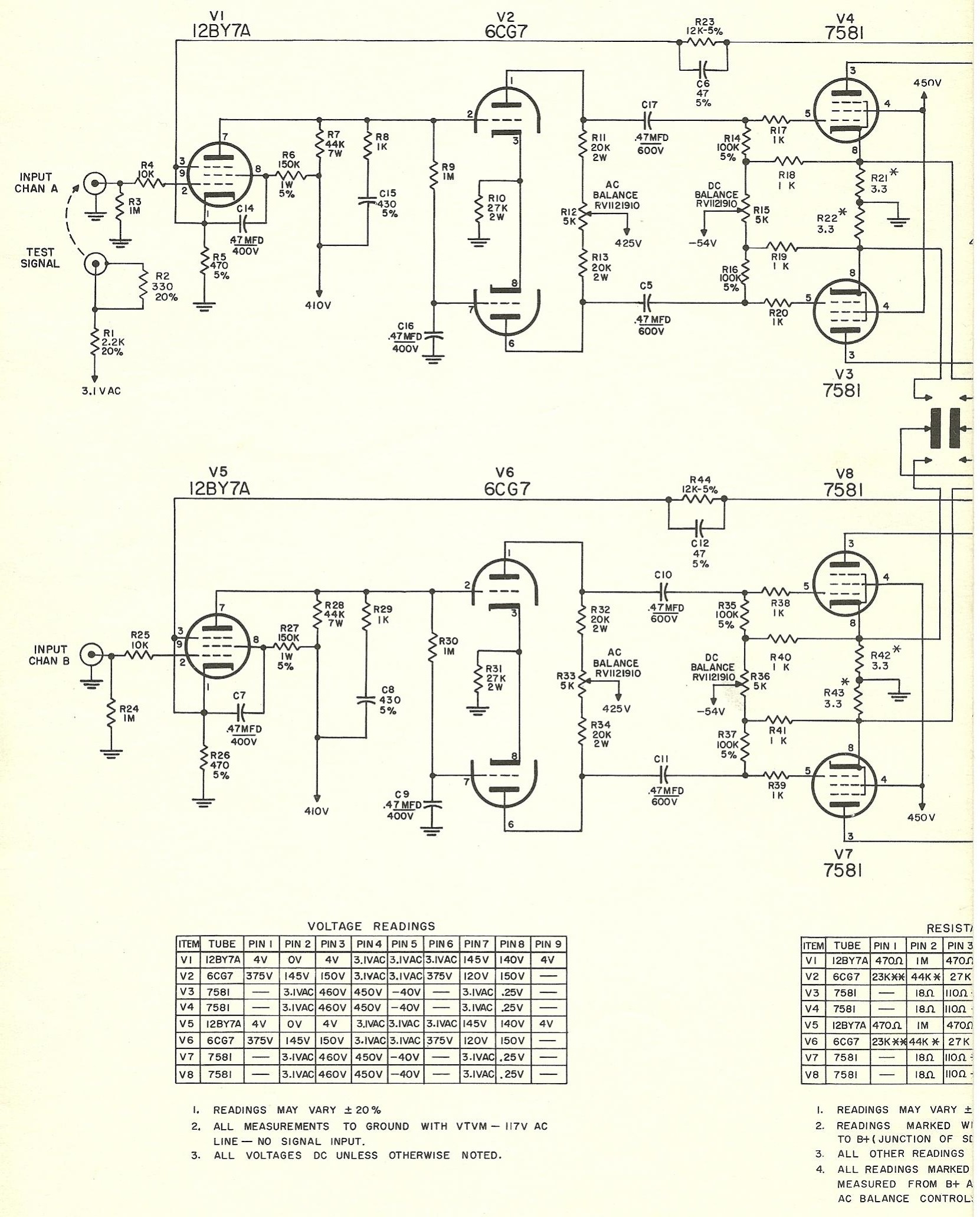

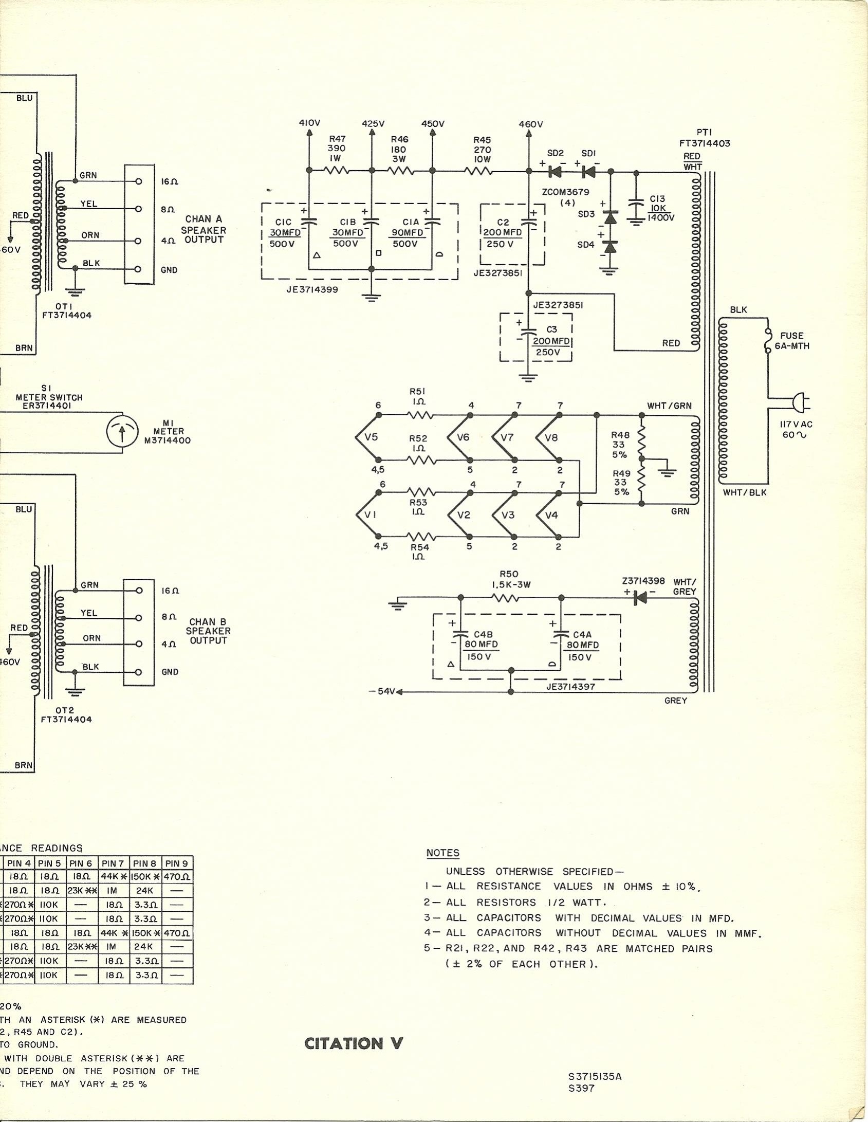

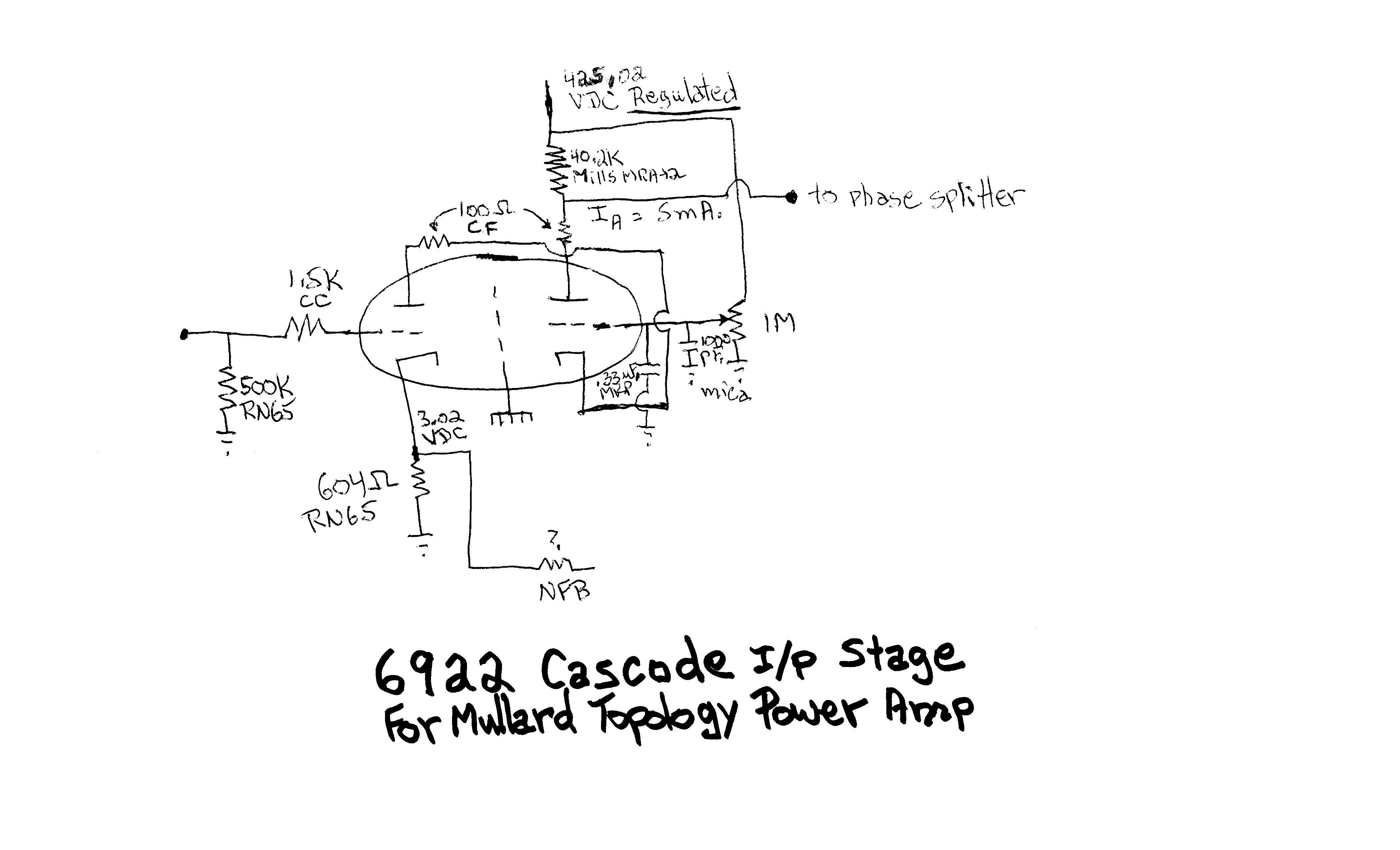

Take a real close look at the Cit. 5. I propose to do something very similar that will yield approx. 65 W. continuous and 130 W. instantaneous. The Mk3 has, by current standards, a very mediocre B+ PSU. Anything I'm associated with has a good PSU. The PSU is the foundation upon which the entire "edifice" is built. A good PSU is a necessary, but not sufficient, condition for quality amplification.
You will have to buy 2 new chokes (1/amp). As stated previously, the Dyna C354 is in way over its head. Edcor offers a suitable model. The comparable Hammond 193M is few $ more.
Part of what makes the Cit. 5 a superior implementation of Mullard style circuitry is the use of high transconductance (gm) small signal types. The 12BY7 is out of production and available stock is (IMO) best left to existing units. I'm uploading a 6922 cascode setup intended to replace 12BY7s in Mullard style amps.
The 6922 is and, highly likely, will remain in production.
We will emphasize high gm by using an ECC99 as the phase splitter, instead of the 6CG7. An additional refinement of the phase splitter is replacing the tail resistor with a constant current sink (CCS).

The 6H6П (6n6p), 6H30П (6n30p), 5687, and ECC99 are "similar". However, the ECC99 draws the least heater current and has the highest μ.
High gm provides resistance to HF error correction signal induced slew limiting. The 6П15П, AKA SV83, looks good from a gm perspective, but the 760 mA. heater draw could be trouble. The 12BY7 heater draws 600 mA. The 6922 heater draws only 300 mA.
I suggested the 6922 and ECC99 for their excellent electrical characteristics and the fact that they are in production. Across the board, NOS tube stocks are dwindling and employing types currently in production is (IMO) important.
