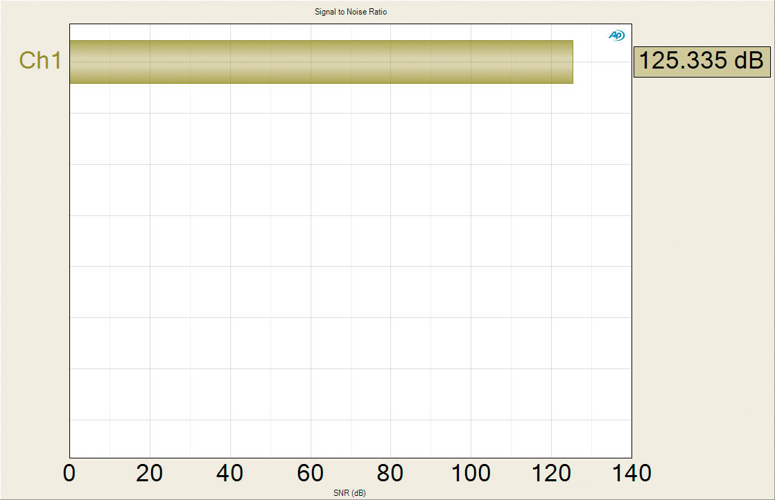

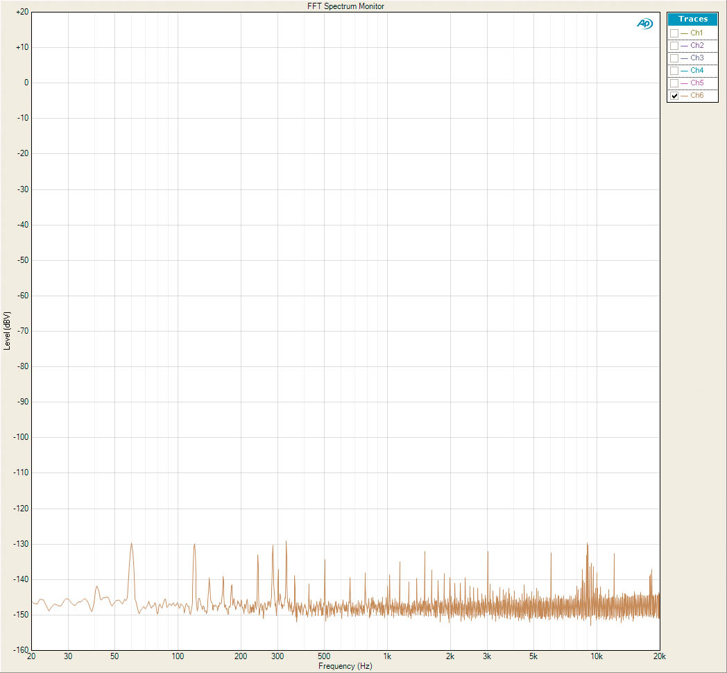

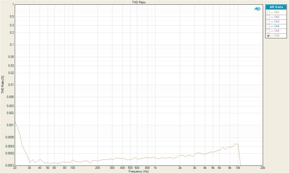

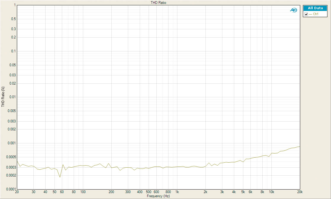

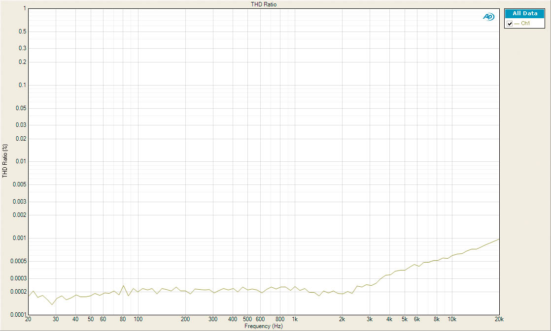

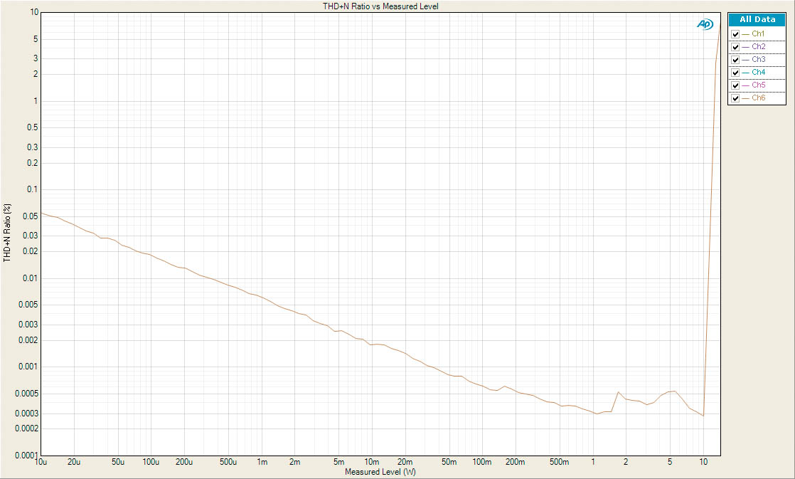

this one, I havent seen good enough real measurements to see if VSSA beats this, but I somehow doubt it because it pushed the ability of the AP2 to measure it. VSSA will have a bit more power most likely, but if the power isnt needed, it has no advantage there.
mouse over the pics and hold there for the file name, which gives the specific measurement type. note the steep rise on the THD vs power graph, which I believe is into 4Ω, cant remember. thats due to the current limiting on the lme49600 kicking in.
I think the SNR was at 1V from memory, more details are in the thread on the first page, where all these came from. the commercial version has a bit more power, a bit more swing and a few other tweaks afaik, but I believe any improvement is academic at this level if you dont need more than 15W into 8Ω, perfect for tweeter duties, which is all the OP wants it for.
