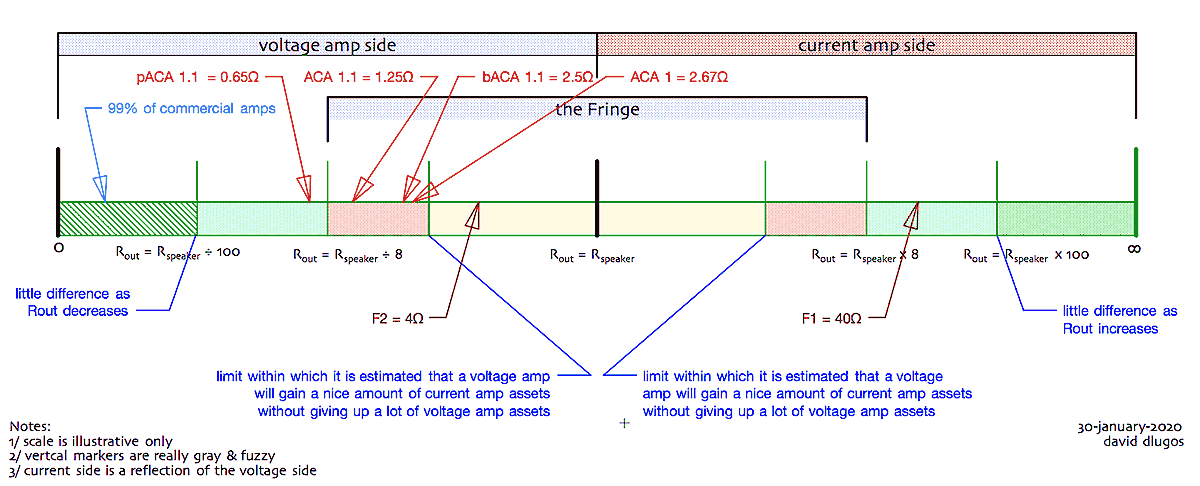

The 1st question i have is what is the outpu timpedance of the JHL?
From the JHL article: Output impedance: 0.03ohm (at 1kHz).
This is significantly different than the ACA which has a highish output impedance which means that ACA is much more sensitive to the effects of loudspeaker impedance on end performance.
The JHL will fall into the 99% and the ACAs fall as shown. Anything in the fringe really requires careful consideration of loudspeakers.
So these amps may both be about 10w, and Class A, but beyond that…
So, what speakers do you plan on?
