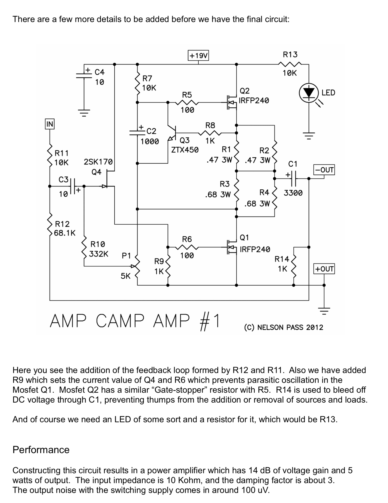

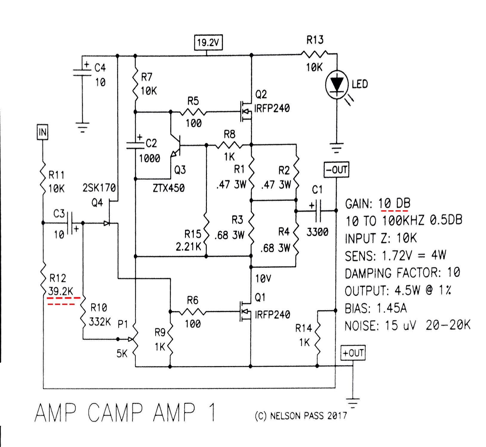

I do have similar experience with Diy M2 amp gain=15dB.
Your ACA is the first 14 dB version no doubt.
I can use passive AVC , audio source = 2V without active preamplifier.
My speakers are 98 dB efficiency.
With less efficient speakers 88 dB I do need active preamp imho.
New ACA 1.5 have only 10 dB of gain....
Anyway BA-3 is not constipated by the feedback loop 😀 😀
R12 is around 68K on the latest diagram; 39.2K on the original diagram. New ACA can only have more gain, not less...
How much of dB ?. New ACA can only have more gain, not less...
You can verify by youself on the left ACA V1.0 on the right side new ACA 1.6
source : http://www.firstwatt.com/pdf/art_amp_camp_1.pdf

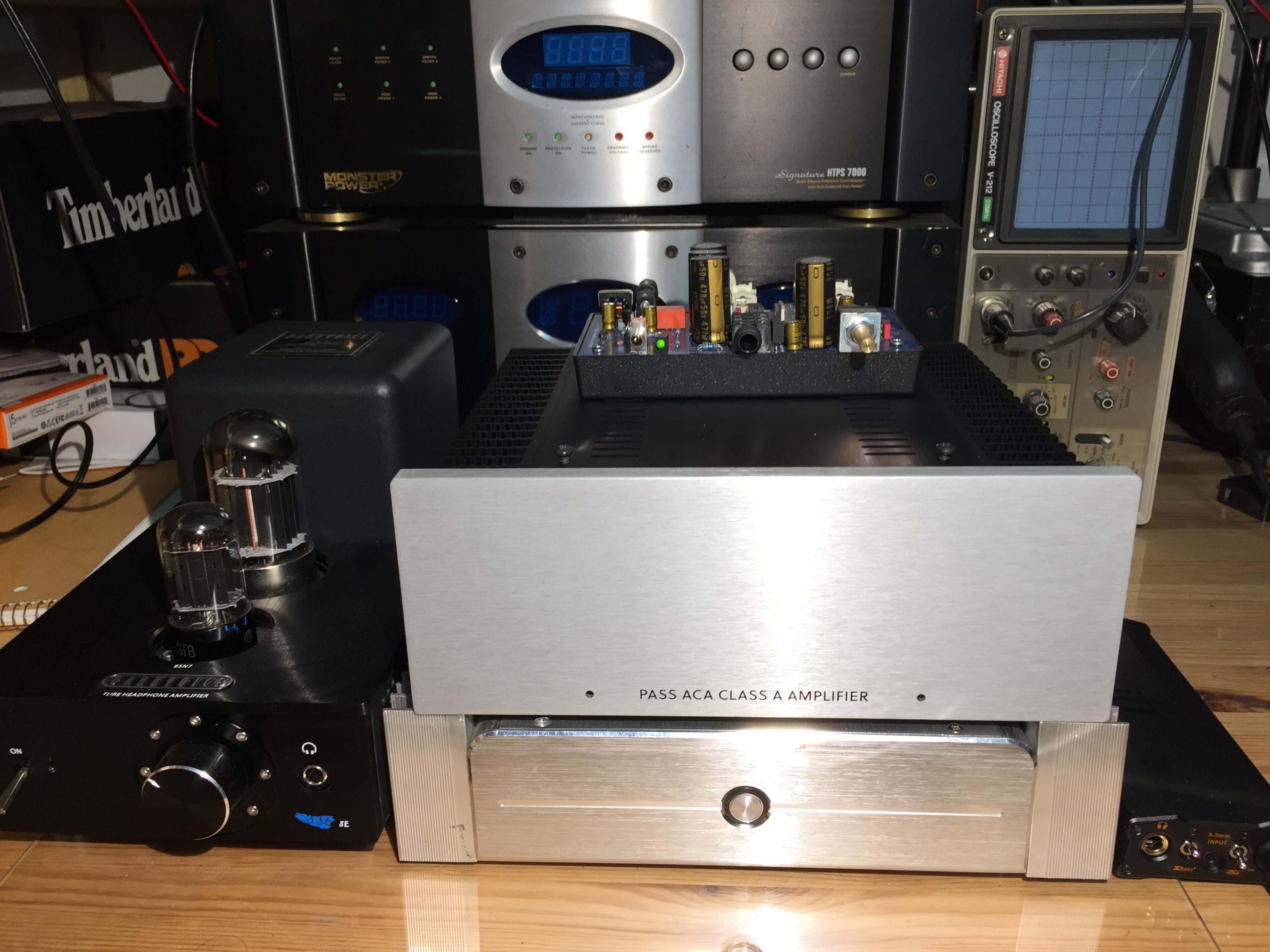

Like a child on Christmas morning just received one of my two chassis go to ACA 1.6 sitting on top of my original amp camp amp chassis I modified from a old mini computer chassis and just attached heat sinks to that side of it.
Been using the Krong tube as a preamplifier along with comparison the DarkVoice 336 SE and IFI micro Black Label as preamp.
It appears if you wanted to you could mount the Krong PCB inside the chassis of the amp camp amp.
Even the original Amp Camp Amp 1b PCB pictured below is more than enough power then you can comfortably listen to with the BK-20 Fostex speaker cabinet kit using them Fostex FE206En drivers. I will use my original ACA 1b. To drive the tweeters Fostex T90A ( that’s just for the family members who can hear both 15K+ , my hearing starts rolling off at 12k and stone cold death after 15K.) and the new 1.6v ACA to drive the Fostex FE206En Full range. Now just need to build a amp for the subs.
