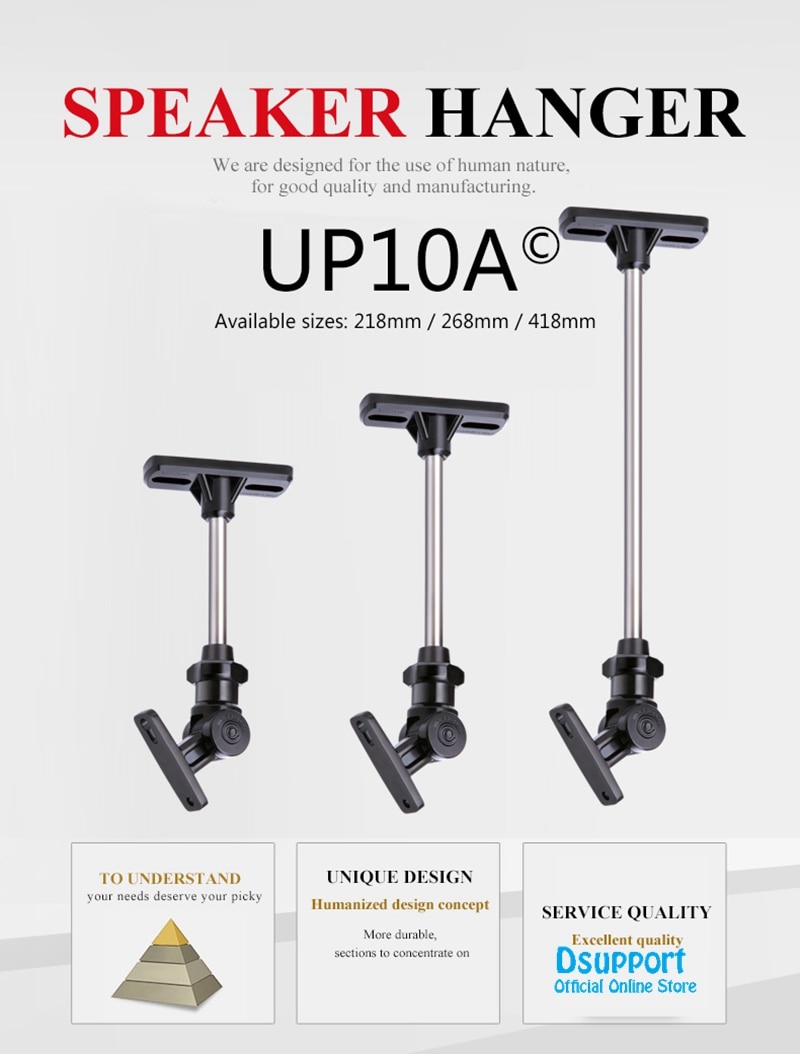

Several commercial speaker ceiling mounts are available.
Certainly worthwhile employing until the children mature.
Would the ones in the attachment be domestically acceptable?
K&M 24496 Speaker Ceiling Mount Black - Speaker Stands - Accessories - Studiospares
1 Pair (2pcs) UP10A 418mm Zinc Alloy Universal Ceiling Mount Surround Speaker Bracket Full Motion Speaker Hanger Loading 10kgs-in TV Mount from Consumer Electronics on AliExpress - 11.11_Double 11_Singles' Day

Ceiling mounts such as those would be visually appropriate, but I'll need something stronger. I've got to calculate the weight of these speakers, but I expect it is in the 40 lb range.
After thinking so much about how heavy the stands should be to reduce movement, I wonder if there is a meaningful way to do the same with a ceiling mount. I suspect not.
The K&M mounts support up to 25kg (55lb) and perhaps look a tad less industrial in white!
They certainly look strong and rigid.
