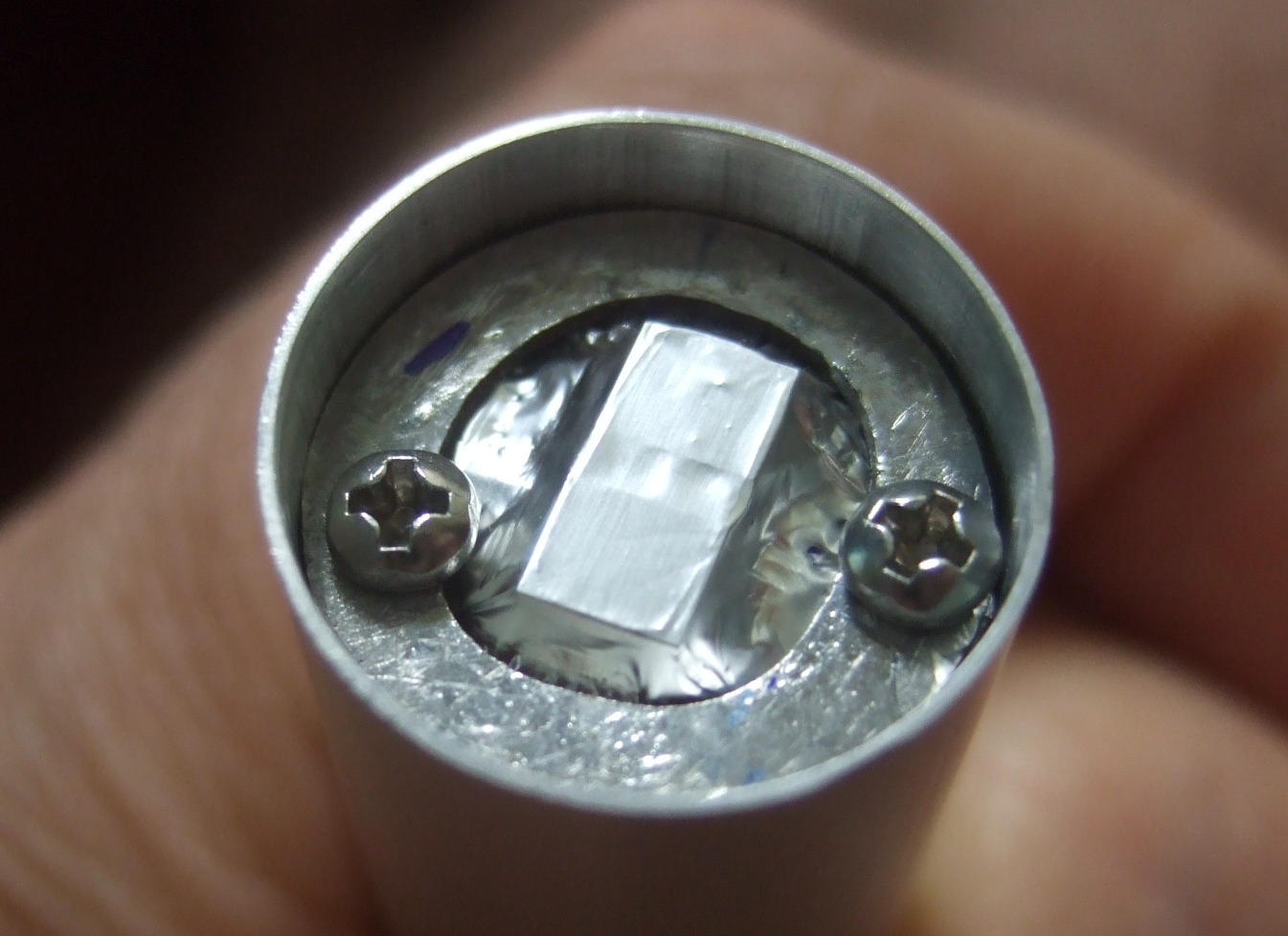

I made it with BPW34 photodiode, it works but not accurate💁♂️

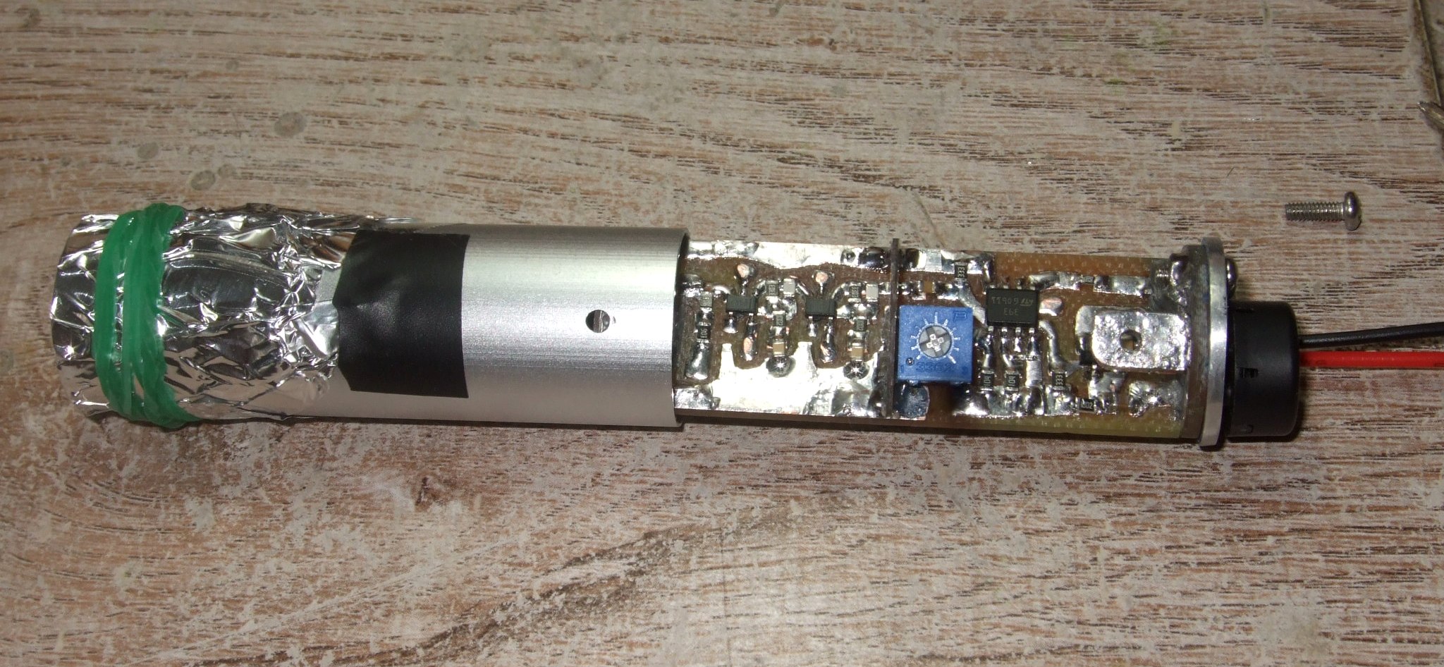

I made one last month with 2 x BPW34.
Without a scope and a radiation source , it is hard to say if it works well.

petromax lamp mantle!I made one last month with 2 x BPW34.
Without a scope and a radiation source , it is hard to say if it works well.View attachment 1215106
