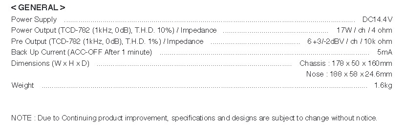

I couldn't access the 9855 manual. If they both use the tda7412 there should be no difference in the output from it. Have a look at the resistor values used in the buffer amps following the 7412. The 9853 uses 24k and 22k to set gain to near unity. Perhaps the 9855 uses different values to increase gain here.

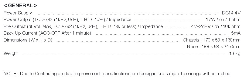

After having another look through the sheets I am now a little confused. The 9853 claims 6 volts out and the 9855 4 volts. The schematic sections are pretty much the same.
