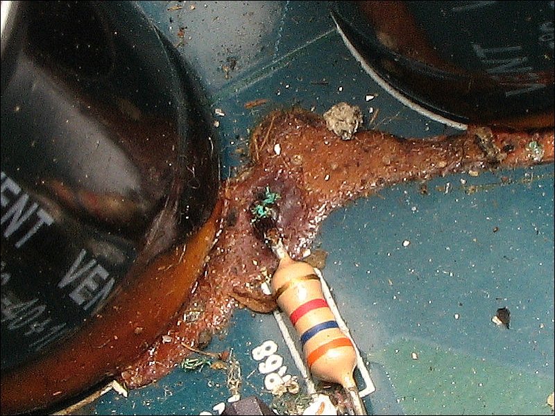

So, trying my hand at this again. This time I think I have an advantage to having a pretty comprehensive service manual. Been trying to get this amp to work for some months now. When I got it, both LEDs were orange upon powering up. I took it apart and found it needed caps as expected. I replaced all the obvious leakers and the surrounding ones. Basically all new caps except for the ones on the RCA input board. Scrubbed the affected areas wtih alcohol and all that. Result now is I get a green status, but yellow mute LED. No speaker relays are clicking. I adjusted the rail voltage per the beginning of the service manual to within spec. I am throwing in the towel and asking for some help on what to look at next. From what I can see, the relays are not getting a ground to trigger them. Thanks for any and all help and I promised not to be like that other guy asking that never followed up with what he found wrong after being asked to check pins 1 and 2 at IC 502, lol

I dont see any open traces. however, the side we are talking about had some hot/ugly resistors. I had replaced them with 5% tolerance units. Ive probably spent hours looking at this board with the magnifying glass, lol

Im not sure what you mean by brown fixative? There was some nasty corrosion stuff that took a good amount of scrubbing to get rid of. From what I can see, its no longer present.
yeah, there was some of that. cleaned it all as best I could. Dont see any residual. I have continuity from the emitter at q504 to e502 and q507 per the trace on the board. at least on that side of the board.
