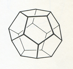

would want to use an alpair 10p in a 14 cm dodecahedron aside ( 21 liters), do I have to add a port ?
No, you do not have to add a port. 21 litres, lined will have a Qtc of about 0.5 with the 10P. It doesn't matter whether it's a dodecahedron or not of course -the volume is the volume is the volume, assuming no significant eigenmodes. The question is really whether you want a critically damped sealed box or something else. Which comes neatly to
If yes of which size ?
Which again depends on what alignment you're targeting. If you want vented, I'd probably pitch for ~42Hz for a lightly damped response assuming a voltage source amplifier; call it a 35mm diameter x 48mm long vent.
21 litres sealed will get you about 100 Hz F3. Add a vent and you'll get into what i feelare the optimum 16-20 litre vented size range and go much lower, at least an octave if not more.

We've got a few Alpair 10m/10p vented builds ranging from 15 to 28 litres. All work very well in their own way. Your cabinet volume should allow for a nice little vented jobbie! Sealed may be preferred if you will be using bass support, if not the bottom few octaves may seem a little thin.
