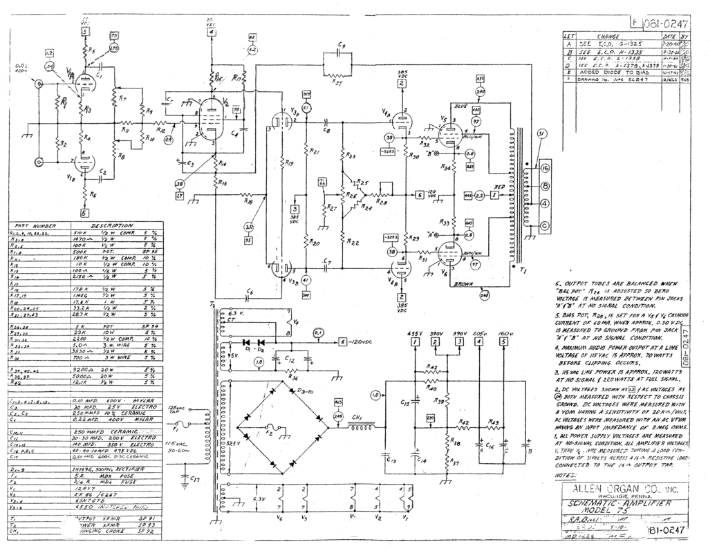

schematic:

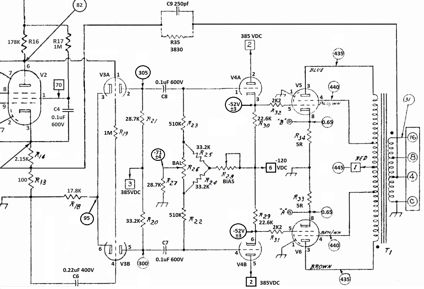

Ah, I see it is 110volts. What frequency is the hum? 60Hz means mains hum, could be a leaky heater in one of the valves also. 120Hz is usually main smoothing issues.
Does it vary with the volume or bias settings? If volume then look at the stage directly before the volume control, if bias, check the output valves and associated bias network. There is a bias balance pot that can cause issues.

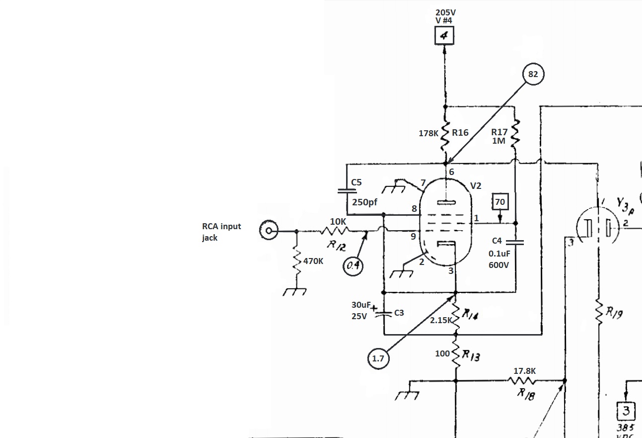

The hum sounds like 60 cycle. The hum changes in level when turning the input control in the input stage. I have two inputs that used to go to the 12AY7 the input tube. I removed the one on the right and bypassed the 12AY7 and went to the EF86 still using the input control. Now the control on the right goes directly to the EF86 for lower gain.
When the left control the 12Ay7 input is turned all the way down and I'm in the Ef86 input or not terminated at all there is a hum. If I turn up the left control a bit the hum is nulled.
Yes, correct I now have a high level and low level input. Note the noise was present before I added the low level modification. Also, I have two of these amps. One amp is perfectly quiet and the other has the noise problem.

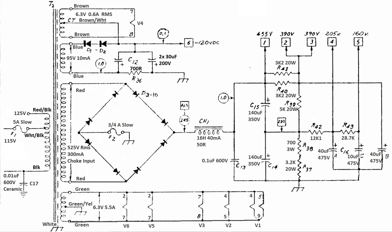

Power supply? The multi cap? Parts A,B, C? with B being faulty maybe? Hard to read my schematic very blurred.

With V3 pulled no noise.
Voltage across R29, R30 70VDC, 70.1VDC
Across R34 "B" bias test point bias set at 240mV
Across R33 "A" bias test point bias set at 240mV
Bias balance does vary slightly as amp warms up. A little adjustment needed on the balance to keep the balance A B as close to zero as possible.
Of course V3 is the splitter so if removed the amp is not working.

I removed the 12AY7 and go straight to the EF86, as the amp has too much gain for Hifi.
Make sure the RCA ground touches the chassis.

Pulling V3 will still leave the output stage biased up. So no V3 no noise. Output stage looks fine. So I think you have a small 120Hz between pin 1 and pin 4 of V3. The fact that the hum also changes when the volume pot is adjusted could point to a hum loop. Is the phono grounded on the chassis - try isolating it. Its hard to go any further without layout and photos of the mods. It could also be supply ripple entering via R16.
The thing is V2 is supplied from the main reservoir caps whose ground will be different to that of C6. I think I would have locally decoupled the rail to v2 rather than this.
