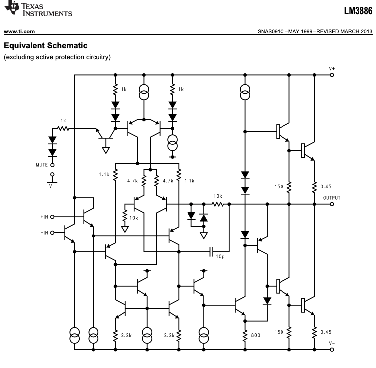

#1 LM3886

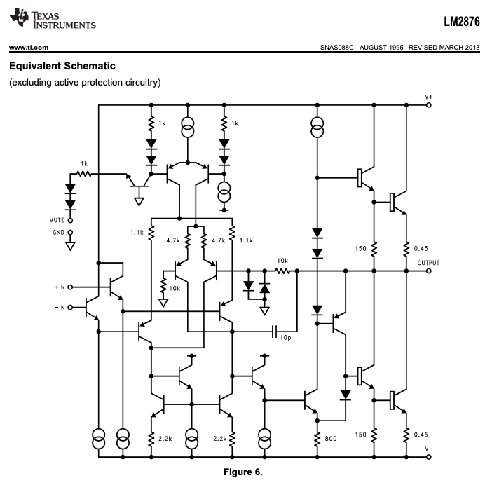

#3 LM2876

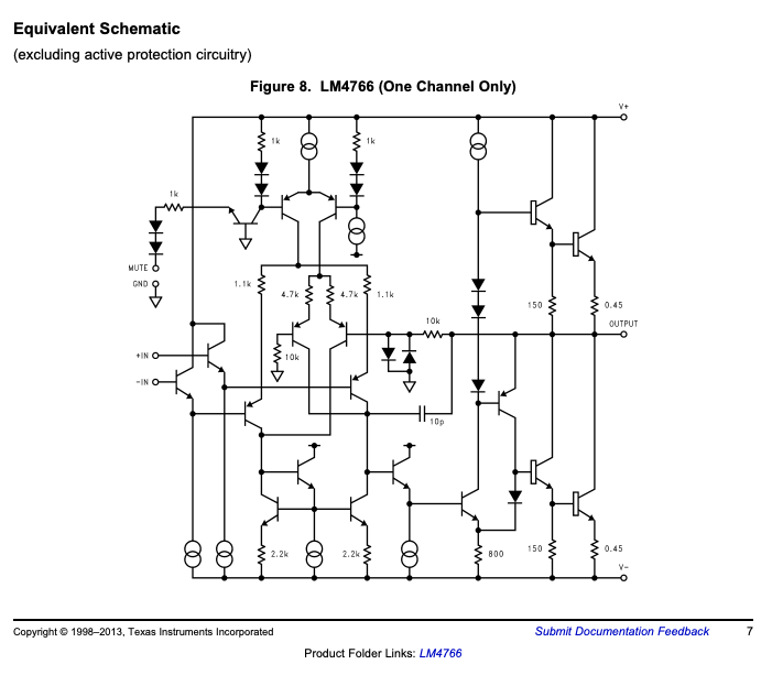

#4 LM4766 dual channel

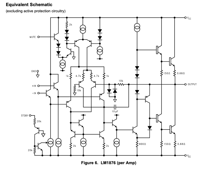

#5 LM1876 dual channel

#1 LM3886
- 68W into 4ohm, Vcc=Vee=28V
- 50W into 8ohm, Vcc=Vee=35V

#3 LM2876
- 40W into 8ohm, Vcc=Vee=30V
- NA into 4ohm
- NA into 4ohm
- 22W into 4ohm, Vcc=Vee=20V
- 20W into 8ohm, Vcc=Vee=22V
