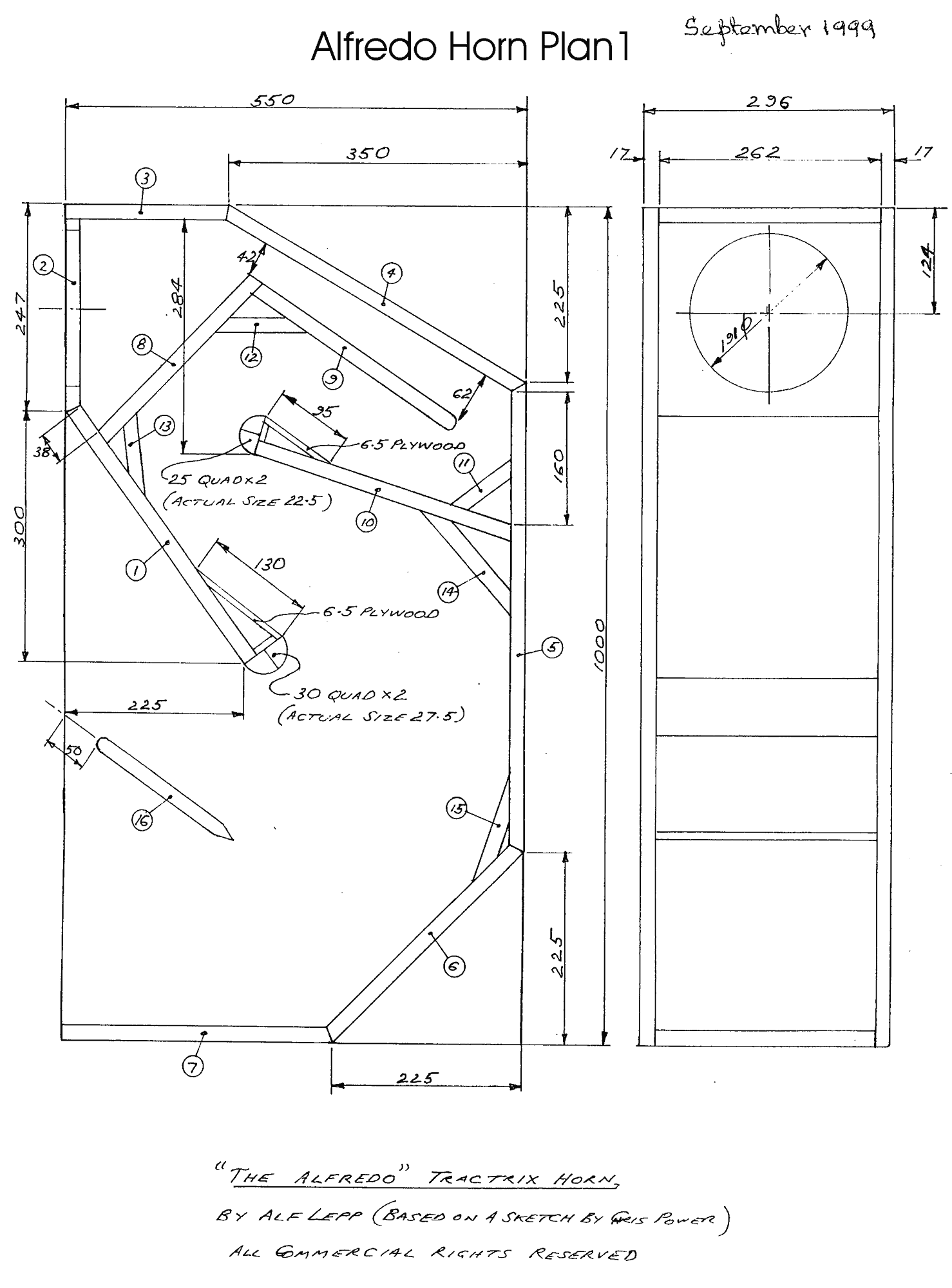

A Speaker Guy friend of mine was enthusiastic about the sound qualities of a Loudspeaker design which he new by the name of "Alfreda Horn Plan 1".
The Loudspeaker houses a single full range driver in each cabinet (eliminating the need for crossovers with their inherent complexity & expense) and includes an internal horn structure.
Unfortunately he's misplaced the plans for this build.
Can anyone assist me in locating the drawings/plans of the Alfreda Horn Plan 1?
many thanks
Cliff

191882d1286923532-plans-alfredo-horn-alf-lepp-alfredo-horn-plan-gif
From this thread - Plans for Alfredo Horn from Alf Lepp

What thickness would you use for the cabinet sheets?
I have access to 19mm "yellow tongue" high density flooring grade particle board.
Is this worthwhile using to assist in elimination of cabinet resonance?
I know a downside is that the resultant cabinets will end up being pretty heavy.
The design looks quite intricate and might be a challenge for my capabilities.
Would you describe this particular plan as the best to undertake for effort vs result?
Also are there more detailed instructions available?
