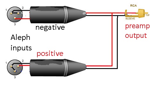

I have two original Aleph 3 to drive the E.T., if I'll find that vertical biamping has not sufficient power:
1) is it a wise move to bridge the two amp as monoblocks?
2) will I lose the beautiful sound of the Alephs (perhaps not any more in class A/s.ended, more distortion)?
3) which kind of wiring to do with preamp (not balanced) and with the speakers (they have separate connectors for low/high)?
Excuse me for my bad English and technical ignorance.

with preamp having only RCA outputs , you need custom cables for your purpose of bridging two Aleph channels ;
leave Aleph RCA iinputs unused , make two cable sets as per sketch , one per Aleph ; luckily , Aleph is having XLR - balanced inputs , so we can invert one channel simply by using inverting instead of non-inverting input
as outputs - use two hot ones , with gnd terminals unused

Aleph 3 has not balanced inputs.
bummer
I forgot that , counting that Aleph 3 is same as Aleph 30 regarding that
in that case , you'll need external phase splitter , which will bring opposite signal phases to two inputs
so - either electronical or xformers (with center tapped secondary)

When I talk about biamping I mean vertical passive biamp (internal crossover). The problem may arise if two Aleph3 are not enough to drive the speakers...
So I answered about bridging them but I fear it is not a simple question.

I read somewhere that bridged, the Aleph3 puts out 60W. I wouldn't bother passive bi-amping. Just try them bridged and if you feel the LFT-8b's need more power, get another amp or two for the bottom end and actively bi-amp using the bridged Alephs for the mid/highs.
