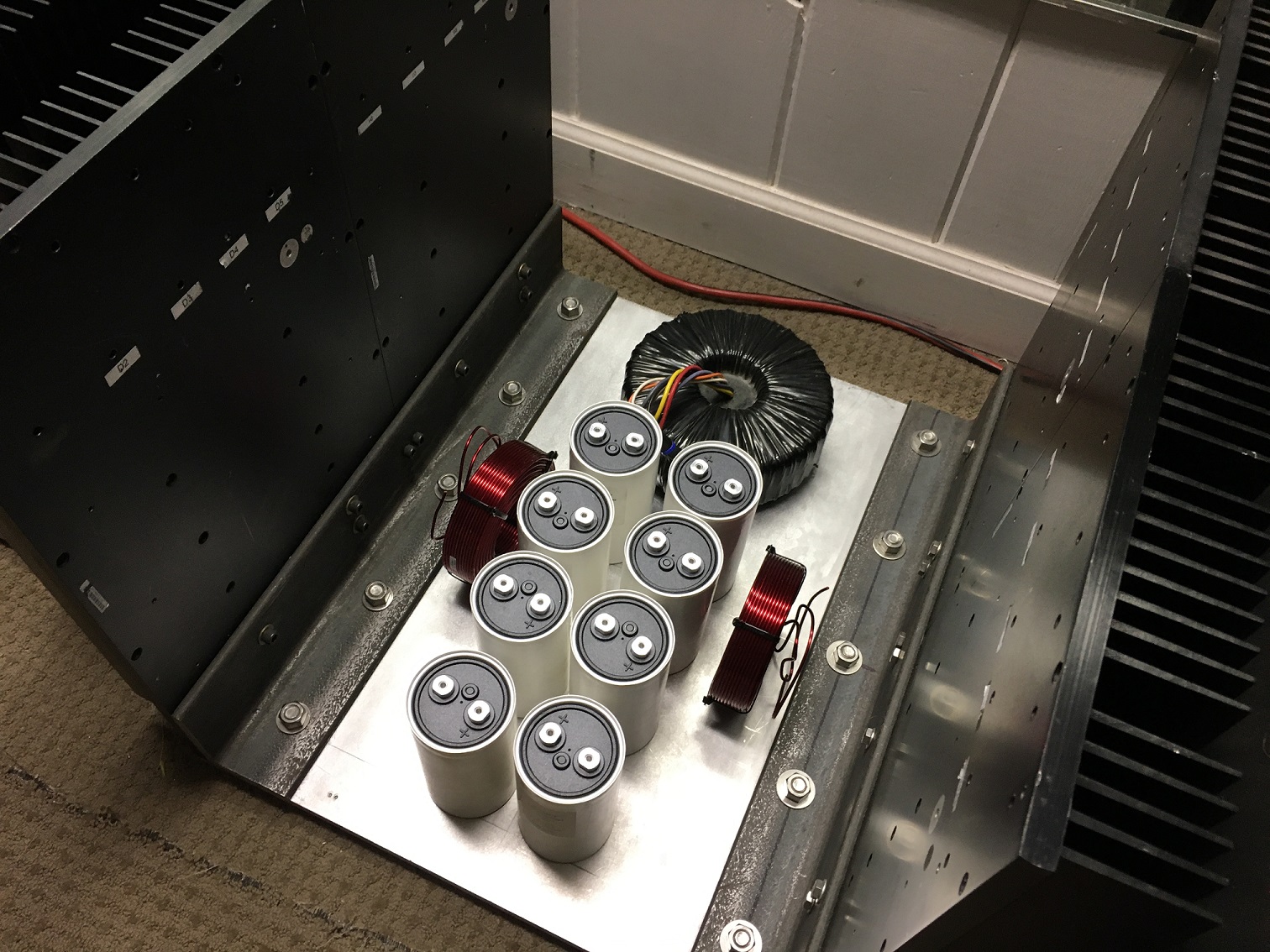

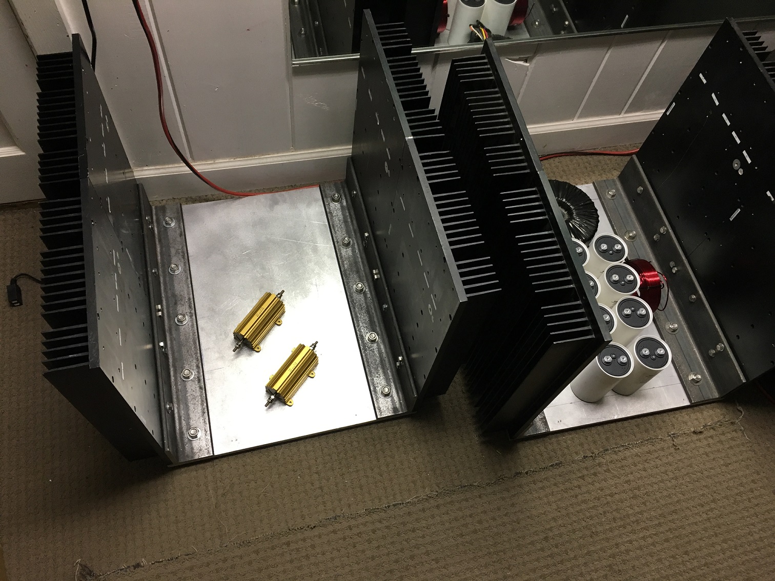

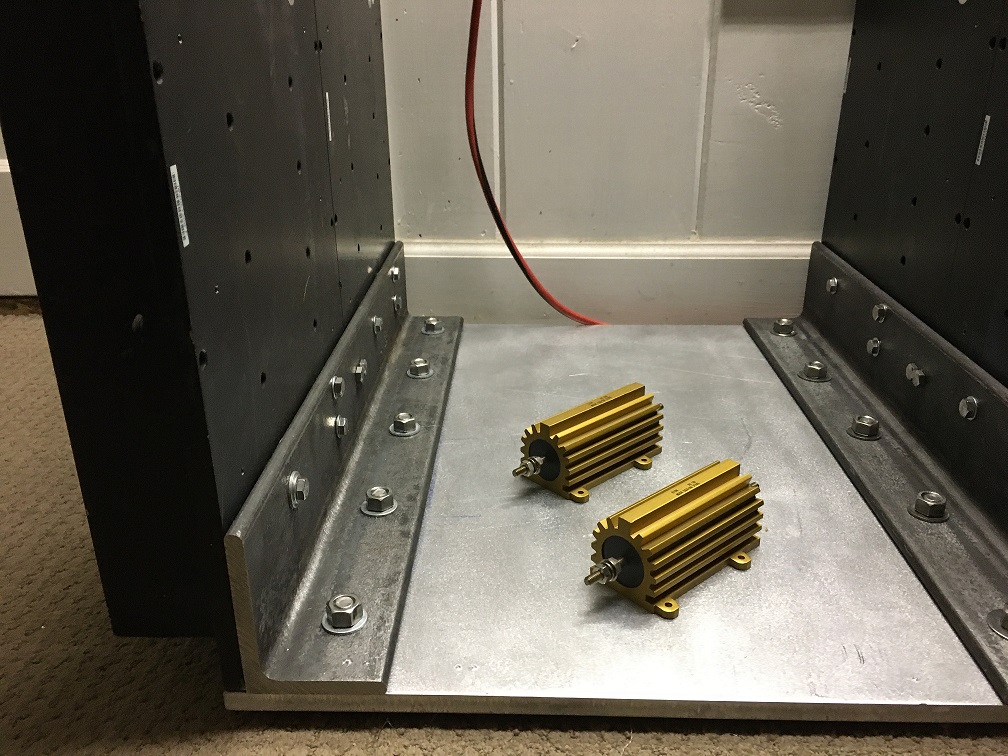

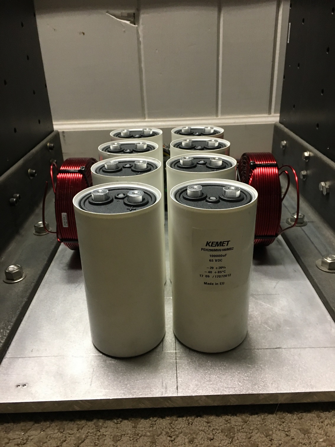

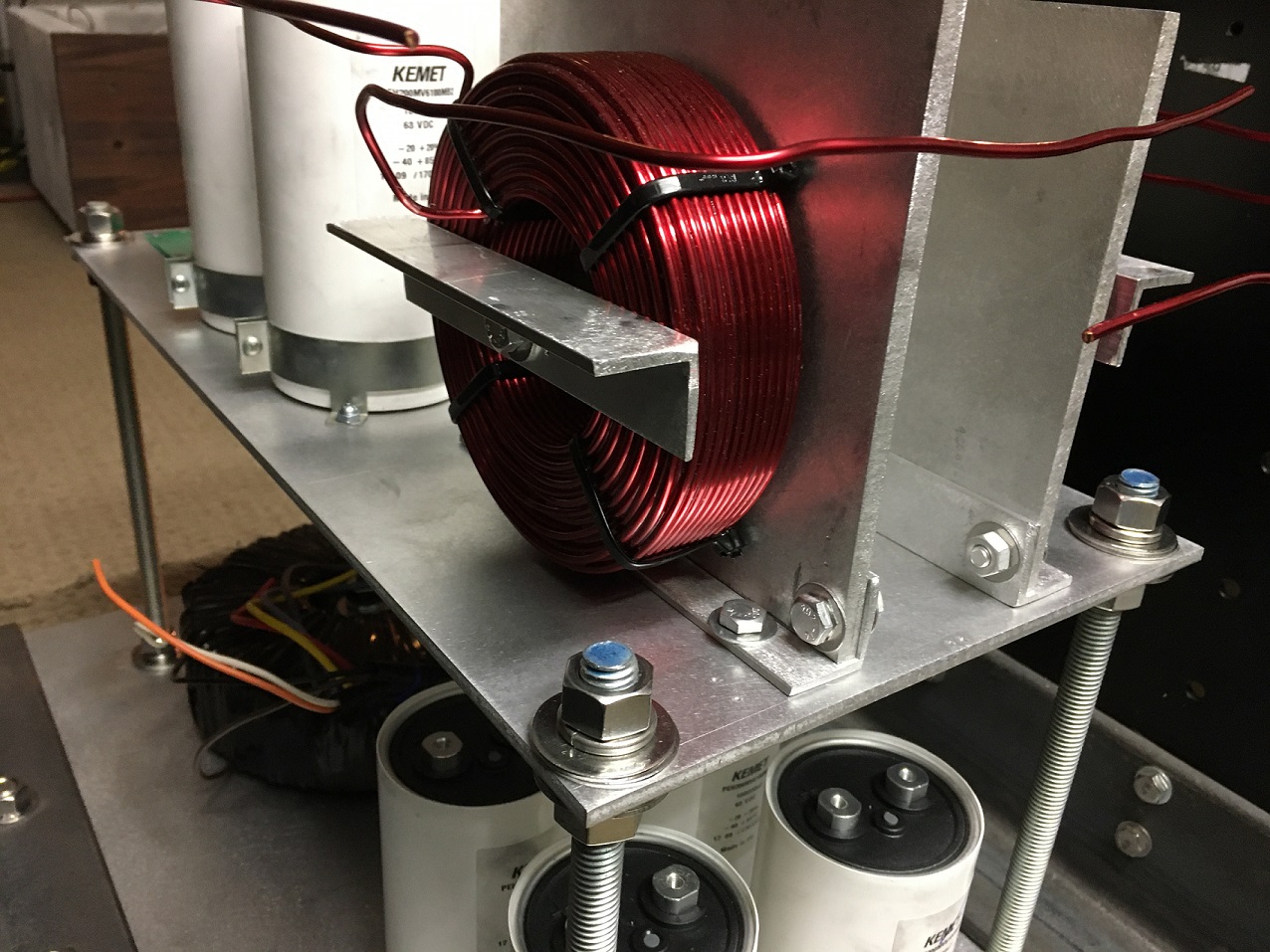

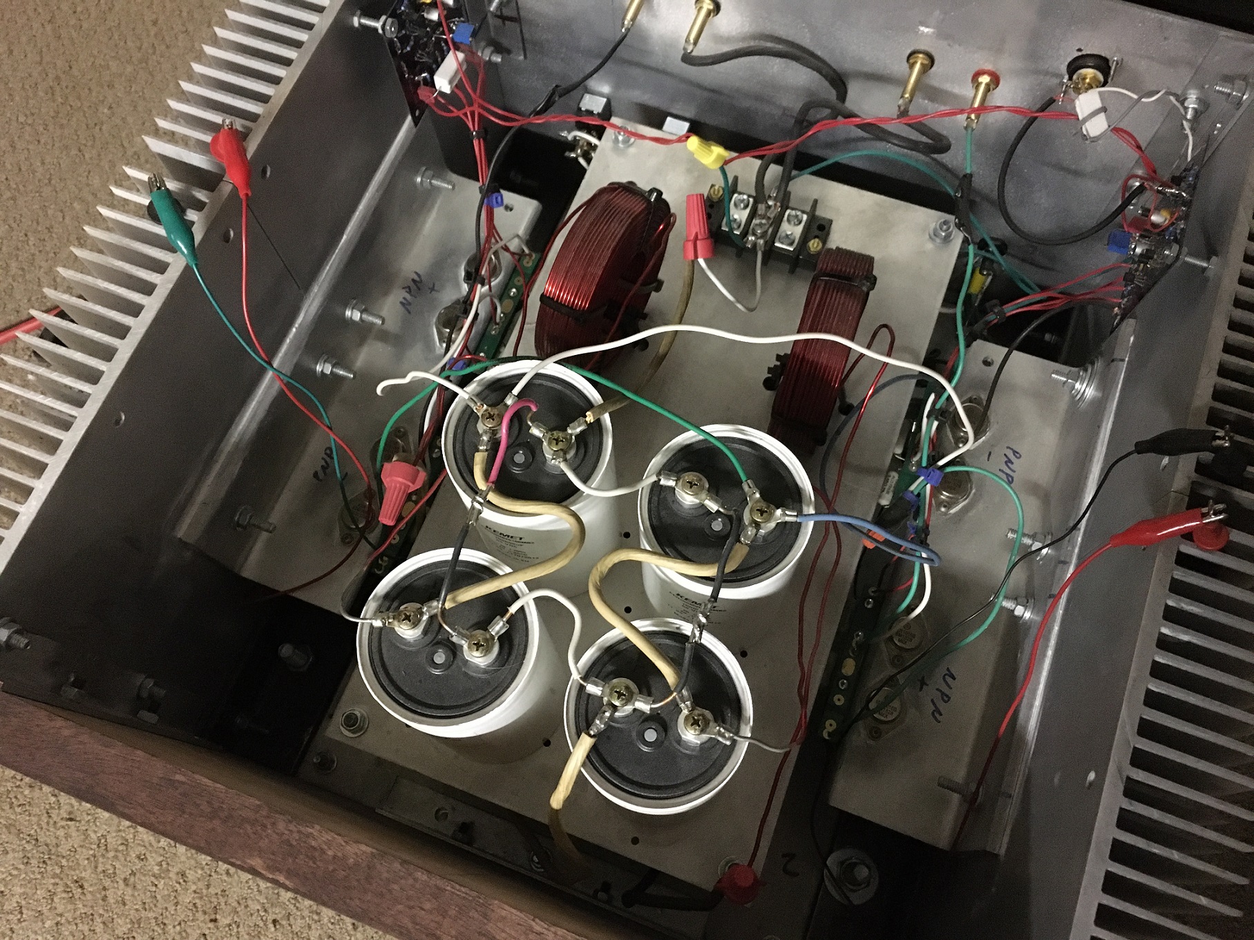

maybe an amp befitting of my screen name? Just finished these big boys, each case is about 160lbs empty. Thinking a 16 fet Aleph biased to 6.5A will work just fine. Thats a 1500VA 38V, 2.2mH (10ga), the caps are 100,000uF, each channel will get 8. The 250W resistors there for size reference. Each case consists of 4 heatsinks, they've been tested with flat pack resistors to 280W, it gets comfortably warm. In this case each sink will have 4 transistors mounted, so each sink will need to do ~140W. Cases are 20" h x 20" w x 24" d.

Thanks MEGA_amp, hence the reason to go to about 5 times the dissipation.

No prob, these won't be finished for awhile anyway. I used MJ11016/MJ11015 for outputs on the A40. The boards I used allowed for a LM334 as a current source for the front end, so you don't have to worry about finding that unobtanium jfet. I purchased the caps from mouser.

hard to find big caps that can handle the higher voltage...

Might I recommend some caster wheels mounted to the bottom of your amps?? Now that it's been 10 years since I build my huge Aleph-X monoblocks, I'm wondering if I'll be able to lift them in another 20 years...

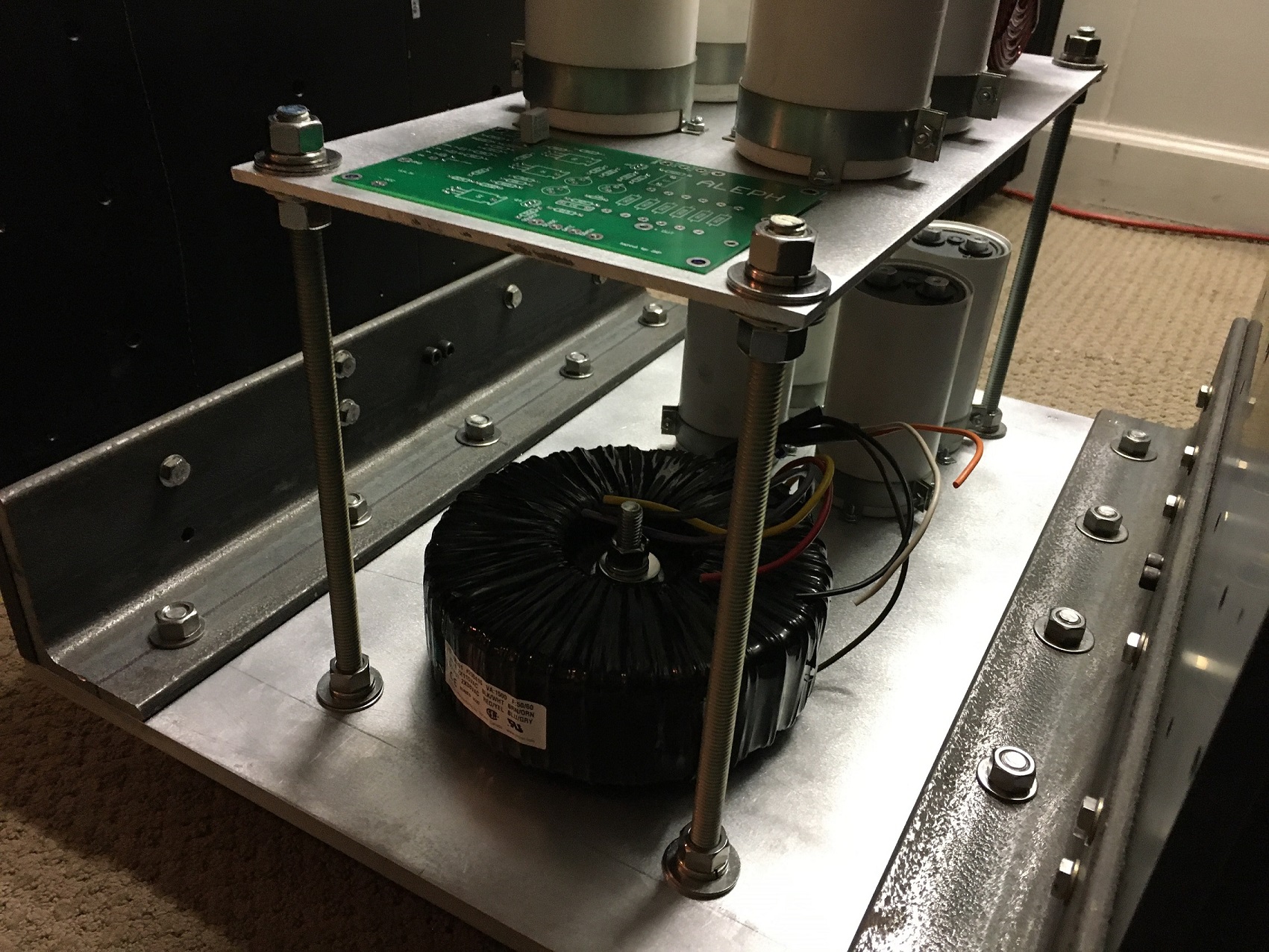

Gyuri, I remember when you initially posted your project way back, very nice! Some progress done on one of the blocks, it's looking like casters all around will be needed, pushing 200+ LBS as it is now.
