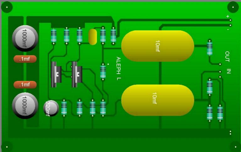

I am in the middle of the Alpeh L construction.
The version built: ALpeh L 1.2, with Aleph P 1.0 volume control in single ended mode.
My actual version is a bit modified, because the 10uF Multicap capacitors simply too big.
Here you can find the version designed for Audyn, Panasonic, Wima, Mcap andAxon capacitors.
This was my first plan, but I get those Multicaps...
I have the gerber files also.

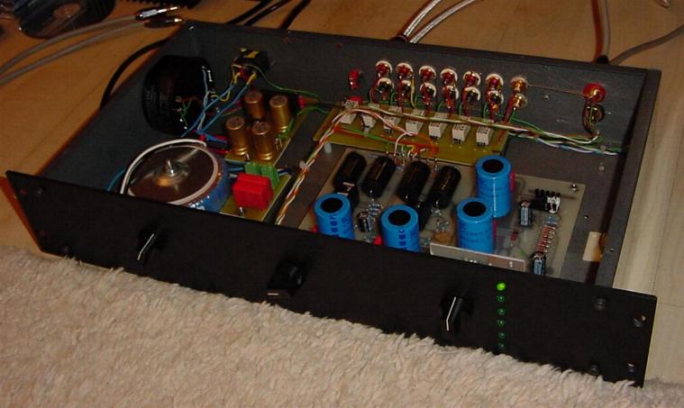

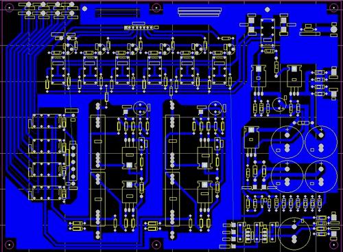

I did that preamp in 2 days
The PCBs were done and designed by me
I always prefer to use relay switching
on input and output
I used separate transformer for relays
coupling caps from LT 10MF 5%
That he can use some information from PCB, he is welcome
on input and output
