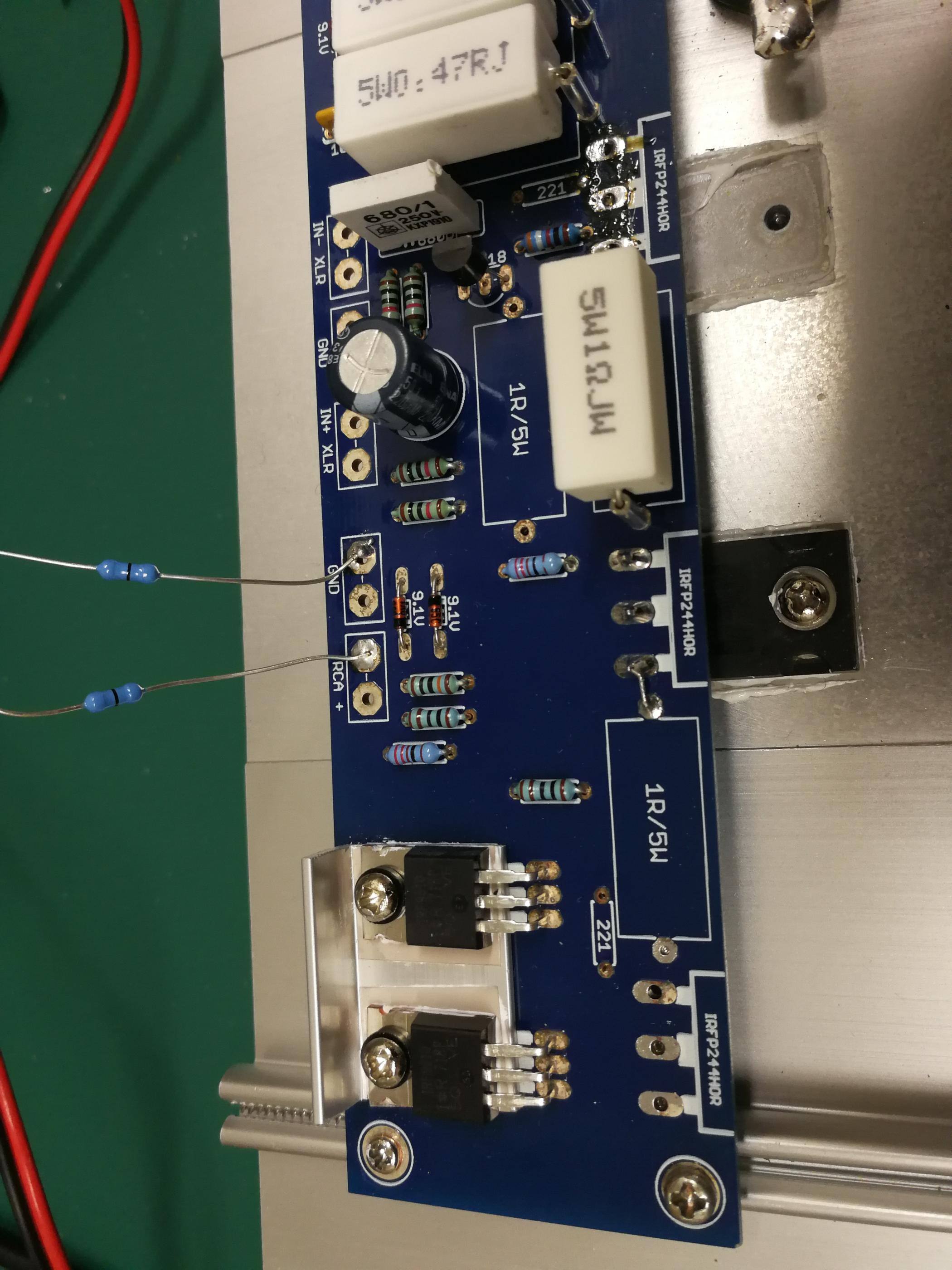

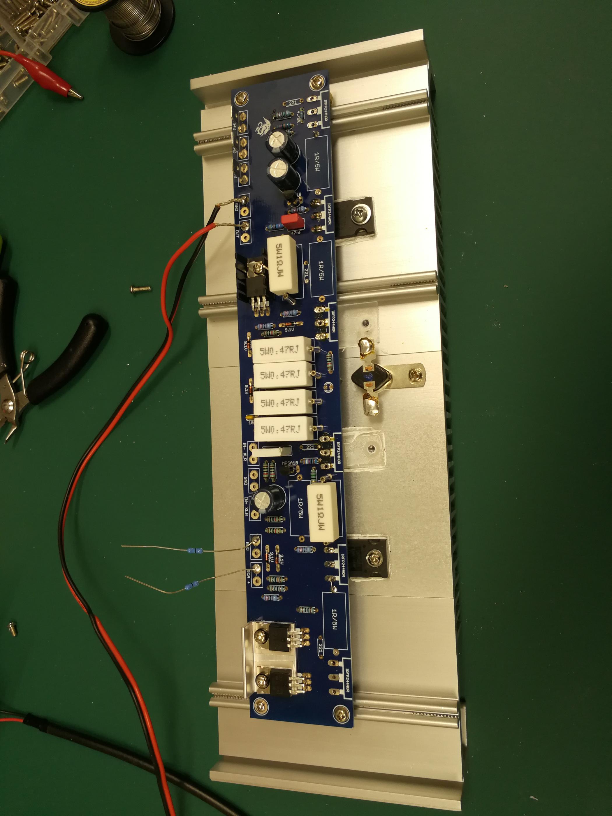

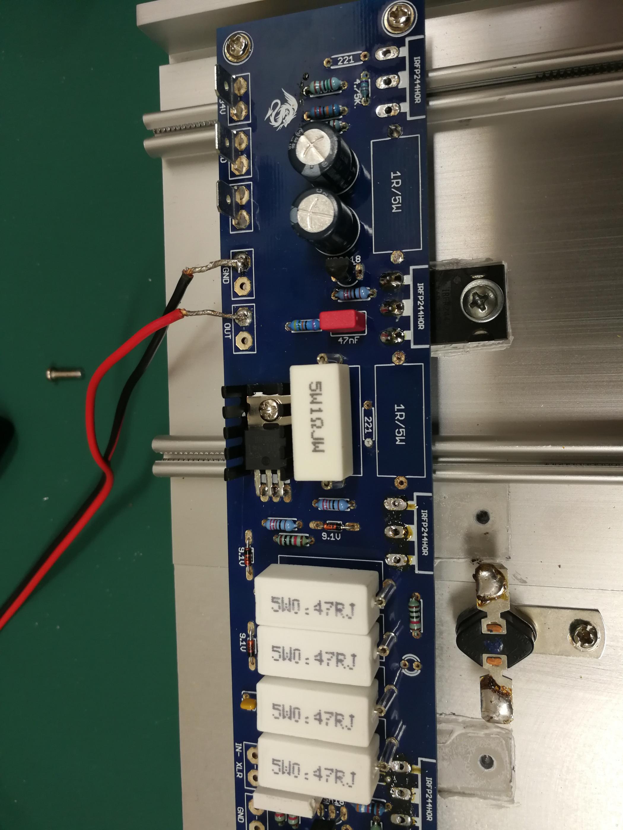

Please post some well-lit, in-focus photos of your amp so we can start looking at what you have. 🙂
PCB is from HIFISTOR Aleph 5 60W A class Amplifier D.I.Y. - HiFiStor
Some components I used from kit, some resistors I replaced with more precise and matched IRF9610. I tried to swap IRFP244 multiple times. Somehow, the amplifier is more stable with 2- pairs of transistors and has even clipping than with one pair. However, due to smaller heatsink and enough power to drive my speaker just with 10W, I would like to make it run on one pair only.
What is not visible, I added 1nF from bottom C102.
Thank you for quick answer. As I see in the schematic, there are two 1nF caps.
C105 - In my circuit is 680pF. Quite close to 1nF, so Im not expecting there should be any change if I replace it.
C102 - I have added 1nF there. Unfortunatelly, it did not stop the oscilation.
Also to mention, right now Im just using as rail power Lab power supply Fluke +-60V / 5A. Im not expecting any issue from here.
If the amplifier has no input, it stays ok. when I connect any source to input, even just wires without any signal (generator turned off) it start oscillating.
