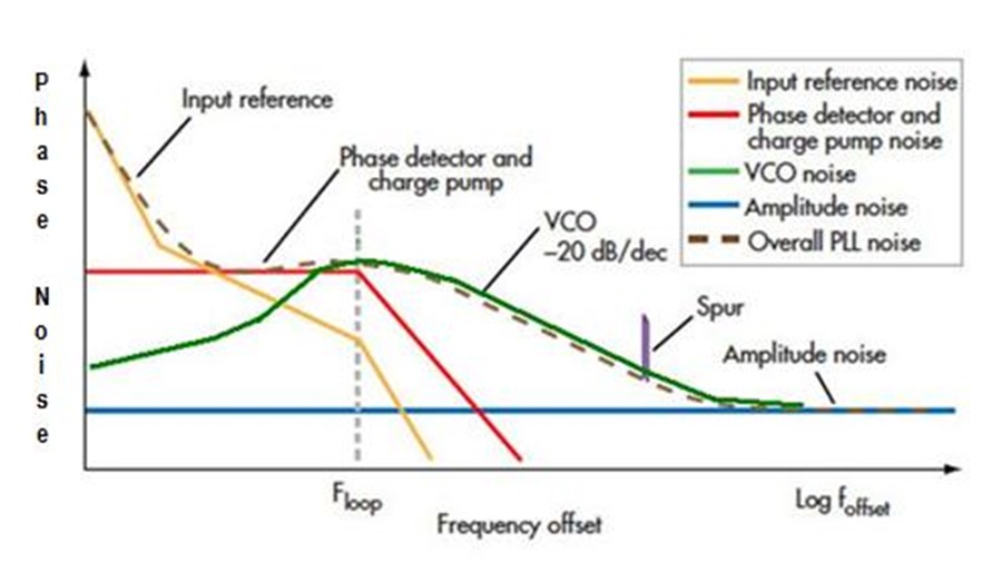

Please comment if you have anything technical to say. Clowning around won't bring you any brownie points. If you don't know how to use a PLL to regenerate a clock, Wikipedia is a good point to start: Clock recovery - Wikipedia
Things have changed some over the years since you may have dipped into this subject area, so it would seem anyway. No PLL used for audio can beat modern ultra-low jitter audio clocks such as NDK SDA series (I have done some audio work with ultra-low additive jitter PLLs, but they still add a little jitter to the crystal clocks). Those are the clocks used on the USB to I2S board I use and recommend. The main thing to be careful about is to keep jitter from deteriorating due to interconnections between the USB board and the dac board external MCLK input. In the case of AK4499 what I ended up doing was putting the USB board right above the external MCLK connector so that the interconnection wires are roughly in the range of 1/2" to 1" long. There is a little more that could be said, but that gets one pretty close to optimal for test purposes with an evaluation board. Orientation of the USB board has some effect, but I will leave that for another time. Integrating the clocks onto the dac board ground plane and putting them closer to the dac chip would be better, as Chris alluded to, but that would have to be reserved for a different dac board design.
Excuse me for being dense today, but is there any way to recover the clock from a serial transmission using only an ultra-low jitter clock as the NDK SDA and without using a PLL/synthesizer? You think the AK4137 (or any other SRC for that matter) is, on the clock recovery side, anything much beyond an Integer-N PLL/synthesizer?
That would be indeed news to me; of course, an ultra low phase noise VCO is indeed desirable, since the PLL output is a combination of the phase noise of all components, see attached (for a synthesizer).
P.S. In a sense, you are correct: my old habits are telling me to avoid using a chip until I understand it's internals. This could be a non productive habit in the era of commodity chips that "just work", discouraging any optimization effort attempts.
There is just some confusion over semantics here. You don’t need a PLL with an asynchronous USB receiver. The data is clocked out to I2S by the clock you give it. So, it should be synchronous with the converter clock if you’re doing it correctly, which is feeding the converter clock back to the USB receiver IC. Asynchronous USB devices use a feedback endpoint to control data rate from the host (along with an internal buffer I’m sure).
If your USB receiver is on a separate board and has questionable clock quality then yes you could possibly benefit from a PLL + VCXO or ASRC.
We seem to be talking about two different things here. The first is serial audio such as SPDIF, which requires clock recovery. The other serial audio is also often called I2S to distinguish it from the first type above. I2S (sometimes referred to as I2S bus) has separate clock and data lines. Some USB boards can output both types of serial audio formats.
