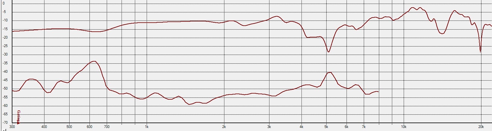

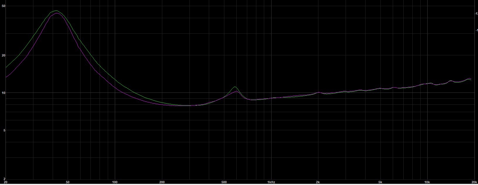

Does anyone have experience with Airborne FR222B8-19F full range driver? I'm thinking about trying them out in a vintage stereo console rework and have 2 main questions.
1)I'm interested if anyone has measured the TS parameters at home.
2)With the 5k dip, I'm thinking that after I shape the response above and below the dip creating a downward slope towards 15khz, the 5k dip will only be down 5db and that might be more than acceptable.

Hmm, the 5 k dip appears to be an eigenmode between the rubber surround compounded by others with the whizzer/phase plug and a circular one @ ~5-600 Hz made by the surround, so a felt or similar disc loosely suspended against it will help and light cotton ball or similar in the whizzer and the Lowther $0.98 tweak never hurts either 😉.

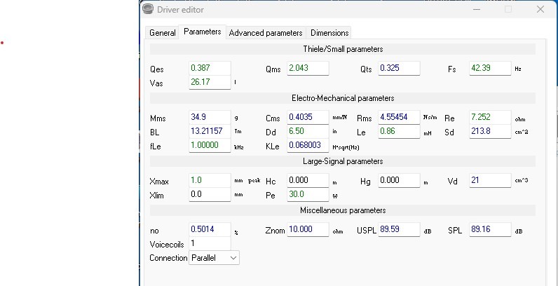

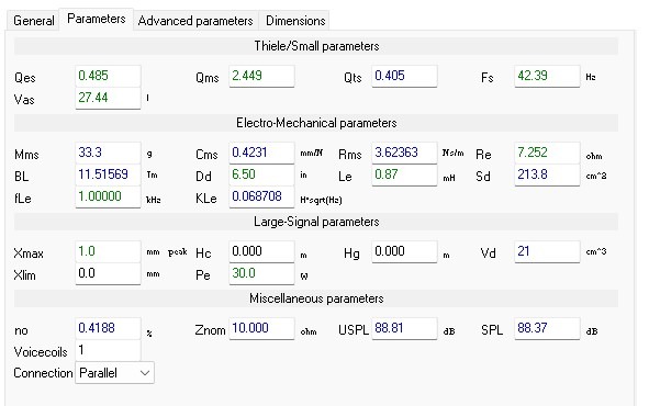

The driver models well for ported, reminds me of silver flute 8 in that way, except 1mm xmax makes it impossible, for real, 1mm or something else going on here?

Where is this 1mm Xmax coming from?
It doesnt make sense. Just look the size of the magnet, with 1mm Xmax it would be some 3dB more efficient, even with somewhat high Mms.
6mm peak-to-peak (3mm one side) sounds realistic to me.
4-5 kHz dip doesnt look nice but thats only 1/3 of an octave. With little correction below and above I doubt it will be problematic. Regarding that, do you plan active or passive correction?

So, two different datasheets.

Regarding dip in response, take a look at post #171 in this thread. It shows two measurements of coax driver with similar dip in response. 4 meters away at listening position response is smoother beacuse of room reflections. You can expect something similar too.

"4-5 kHz dip doesnt look nice but thats only 1/3 of an octave. With little correction below and above I doubt it will be problematic. Regarding that, do you plan active or passive correction?"
I'm planning to use a Pass full range active EQ to attenuate below the 5k dip and passive notch above the dip.
Looking at the distortion, the two peaks at 600 and 5k will be audible.
This driver will need some work to sound good and it has distortion issues.

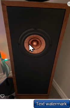

These are great drivers! I've just ordered my 2nd pair! I built a pair for a friend and he raves about them (and so do I) - and he's more than 1/2 to being an audio file. I will test TS parameters and post. Also, here are a few excerpts from an email chain with Solen regarding these drivers:
"2.36cuft is definitely too large for the FR222, it will end up being under damped and have very low power handling. We did use it in cabinet as large as 1.5cuft. You could reduce the internal volume of the existing cabinet by adding a partition. You can’t really smooth the dip with a filter. However, a dip is not as noticeable as a peek, so I would not worry about it.
"The 1.5cuft enclosure will go down to 41Hz, so not much lower then 0.889cuft cabinet. The smaller cabinet will give you better transient.
Me: WinISD says the ideal internal volume is 0.889 sq ft. (45Hz). Does that make sense to you or is there a more optimal box volume that your experience would recommend?"
"Flared 3" port - 6.25"

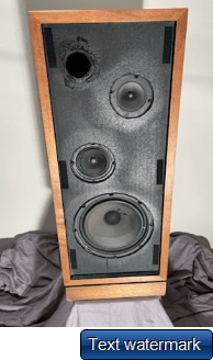

I converted this old Fairfax speaker
to this....
to this....
