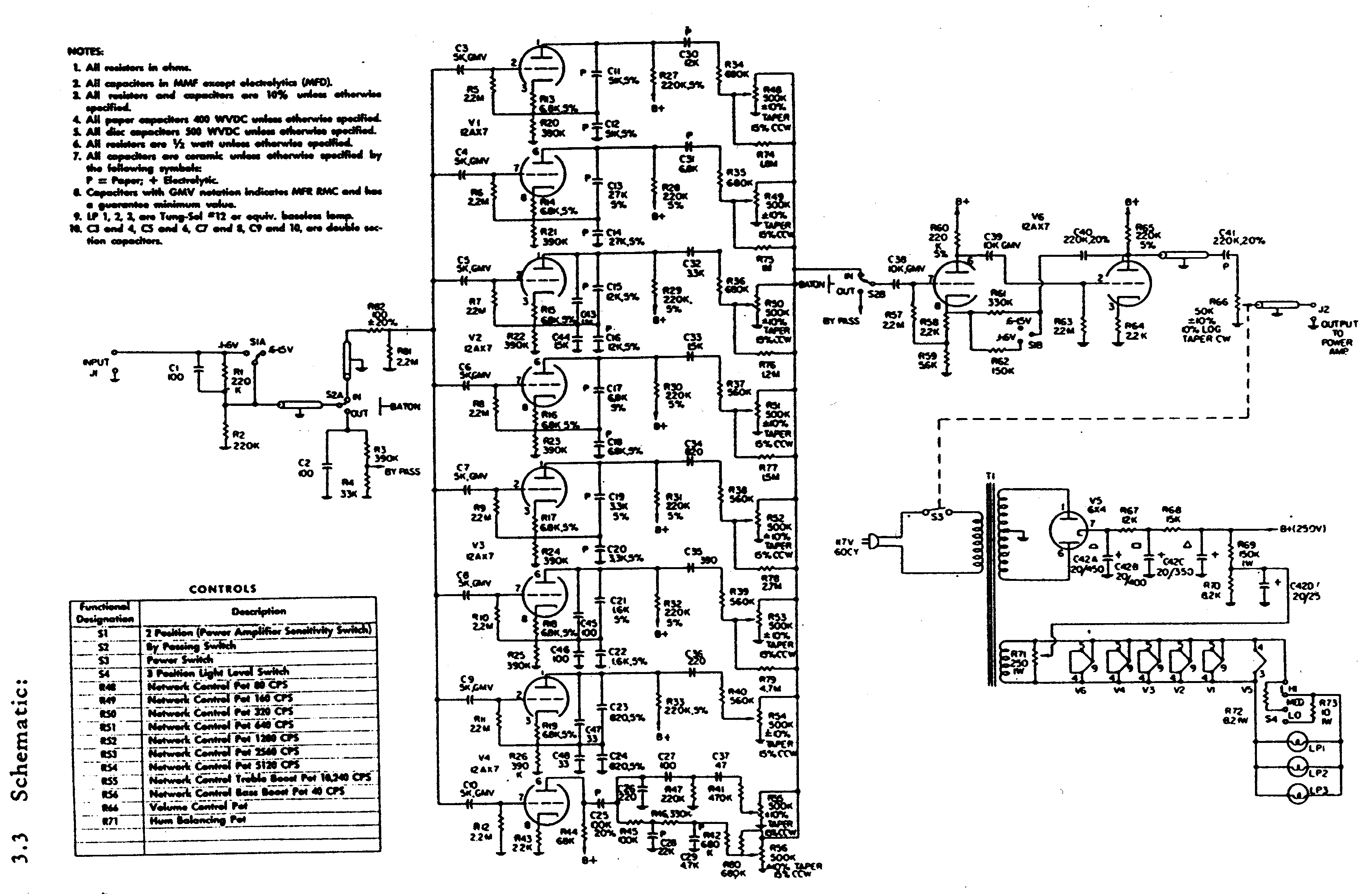

Yes. I'm wondering if someone has built either a zero loss multi-band tube unit, or a purely passive (loss based) multi-band unit.
Presumably there were tube based EQs back in the day but I have no idea if they were or are employed in home audio.
I like the Blonder-Tongue Audio Baton.
I might build one -someday..
It was the first 'no-inductor' graphic audio equalizer for hi-fi and broadcast use. The unit uses six vacuum tubes and an audio band-pass filter circuit invented and patented by Ben H. Tongue. Nine one-octave bands are individually controlled.
Interesting.
Do you have a link to the schema with better resolution ?
