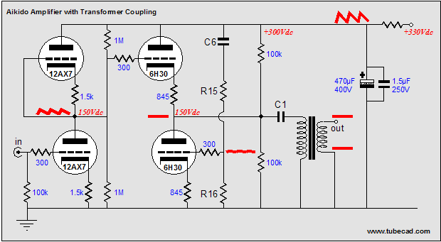

I have built aikido amplifier with output transformer 10k / 150 ohm. I use it as headphone amplifier.
Would there be any benefits converting output stage to white cathode follower to provide lower output impedance and more current drive? Or it is not need with output transformer?
When I plug 150 ohm headphones bass is good, but with 32 ohm headphones bass is weaker. Would white cathode follower provide more bass with 32 ohm headphones?

I've built a SRPP type headphone amp just with an output cap (at least 200uF or more), and bass is great even with 32ohms.
Try the cap change as mentioned. Or maybe it's an OPT limitation.
Try without the OPT and replace it with 200-400 uF output cap. Bypassed with a small PIO helps.

I have OPT mainly to invert phase back to normal, because aikido already inverts phase.

Be aware of the fact that if you want a White CF with lowest Zout this does not necessarily mean increased current drive. More likely you will find that the highest current output happens for a Zout similar to that of normal CF. So you have to be sure about the extreme case (load, voltage, current..etc) and design the WCF as a consequence.

The circuit that you posted looks to be from the tubecad site. Please confirm that you are running with the tube types and resistor values shown. You did not tell us the value of the output capacitor.
There can be a couple of things going on.
With the 150 ohm headphones connected the amplifier sees a 10K load. With the 32 ohm headphones connected the amplifier see about a 2K load. This will result in 2 completely different AC load lines. The amplifier with (if) 6H30’s should be up to swinging the 5 times current of the 32 ohm headphones if not there will be clipping.
If you have a minimum capacitor installed for the 150 ohm headphones it should be 5 times larger for the 32 ohm headphones. This is a likely culprit.

Yes, the circuit is from tubecad.com. I am using 4x 6SN7. I am aware that with 32 ohm headphones bass will be lower. But I tried changing output cap from 470nF to 1uF and bass got muddier, not well defined, tuneful - this was with either 32 ohm or 150 ohm headphones. I also tried biasing output tubes hotter, but that again didnt sound as good. I am satisifed with the sound as it is, but I am looking for more grunt, drive, or powerfull, if it is possible.

I have not tried the Super Triode you are speaking of. From my view it is worth the effort to try it. One thing I did try was Figure 5 in the attached BUF634 data sheet. JB also discusses the use of the 634. I used a LM4562 Op-Amp rather than the one shown. I was impressed with the results using Sennheiser HD600’s (300 ohm), sounded very solid and tight, no flab. I used 12 volt gel cell batteries for power.
