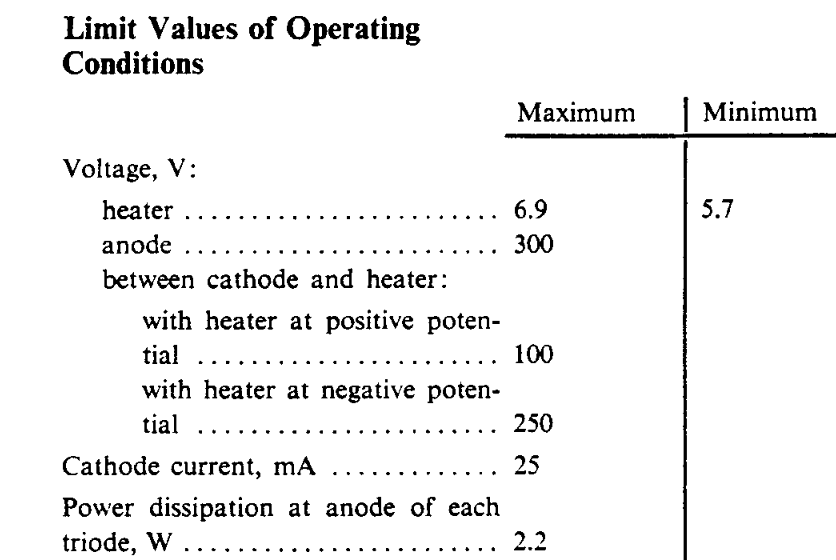

But something has always annoyed me - I hooked up the Hammond tranny (way overkill, but all I had when I built it) and have the 6.3v - 6.3v secondaries for heaters to the Aikido and after its regulation, the heaters are only seeing 5vdc. The losses in regulation circuit drop the heater voltage (duh) - and when I re-read the instructions it recommended 7v - 7v+ secondaries for the heaters, so the regulation can drop to somewhere around 6vdc.
I know Broskie proclaims 5vdc is sonicly ok and will lead to longer tube life...but know many disagree...and I wonder if I should just plop in another transformer, or just pull the regulation transistor for the heater circuit...
I cant be the ONLY ONE that has seen this issue....right?
Soooo....Could / Should this Aikido sound better with a full 6.3v on heaters?

Anyway, looking like there is no quick and easy way to get the regulated 6.3vdc on heaters except put a 12.6v transformer on it...
But I do have an unused 5v tap off this transformer - If connect them in series with 6.3v secondaries to get 11.3vac - the 5v secondaries is 3A, while the 6.3v is 5A. The total heater draw for the 6N1P / 6H30 is 600ma x 4 = 2.4A...

Well, all good - I was getting 1.5vac unloaded after series connecting the heater voltages, so reversed the 5v wires and now getting around 13vac series connected, unloaded.
Hopefully the different current ratings (5A@6.3v vs 3A@5v) is OK if only running at a total of 2.4A.
Now running good where its is supposed to be...
