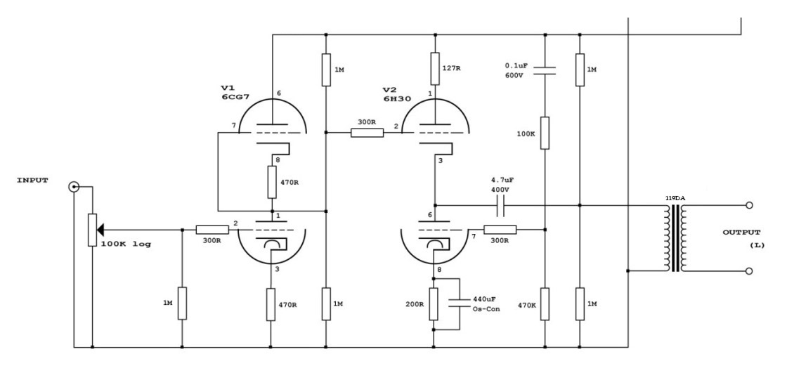

Will try the transformer. Basically it just gets connected to the output between the normal Aikido output and the headphone terminals right?
The other question was potentially using 5670 as the first tube instead of the 6n1p. Lots of substitution options, etc, might be a fun tube to roll, but about its sonic signature?
Yes, see pic.
Am using that for over a year now, my Aikido still being on the breadboard.
But casing up is making progress, and parafeed transformers will be upgraded to custom trannies from AE in Holland. 😉

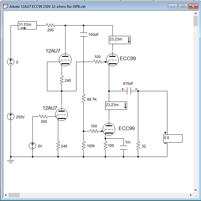

Included is a design I was given by John Broskie of tubecad.com
"It offers excellent balance and a gain of slightly over 2 with the 32-ohm load. With a 300-ohm load, the current-sense resistor value must be increased from 200 ohms to 255 ohms. (A toggle switch could be used which would short the 255-ohm resistor with a 931-ohm resistor for use with 32-ohm HPs.)"
I've built this for use with 470R headphones (ATH R70X) and subbed the 12AU7 for a 6CG7, a 6N1P, a 6DJ8, and (what I'm using now) another 6N6P
It's being powered off a DC-DC boost converter (12V to 265VDC) decoupled through 4.5H chokes/47u caps.
It's honestly the best sounding amp I've ever heard let alone built myself.
Because it's running off of switched power the current sense resistor doesn't need a switch but if you're running a linear supply it's useful for improving PSRR. You could also put a 200R resistor in series with a 55R resistor and have the switch short the 55R resistor instead.

*The 100u cap should infact be closer to 0.68u*
