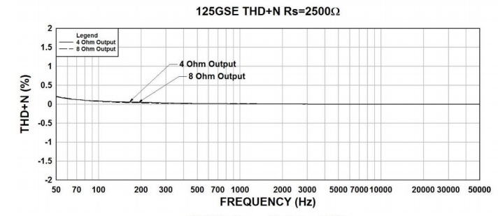

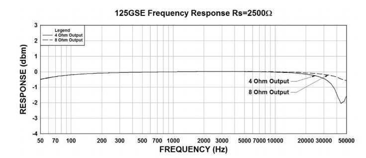

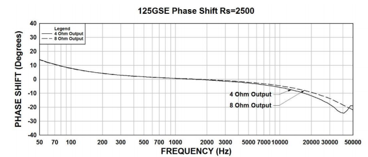

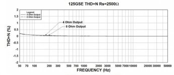

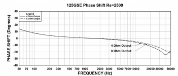

audio amplifier can give very good sound with standard hammond transformer
even in SE
125 gse perfect for 2A3 300B and 6C4C
for hi res and voltage plate load 1629/1638SEA very nice
a bad amplifier sound bad even with gold virgin or trans angel kiss opt

At what power level are measurements performed for Hammond 125GSE and did you test total inductance value?
Best regards, Max

Is the middle graph vertical scale incorrect?
