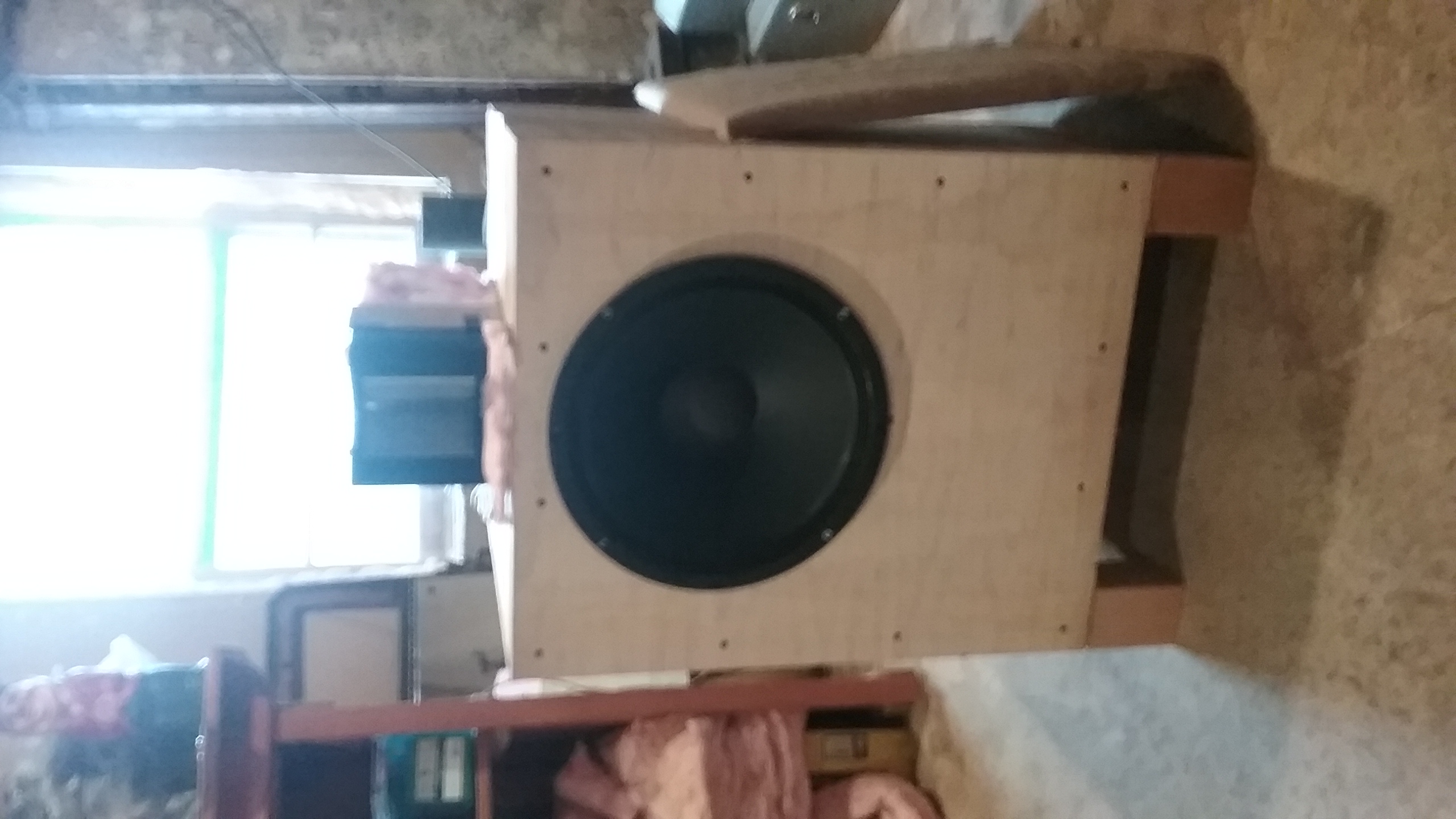

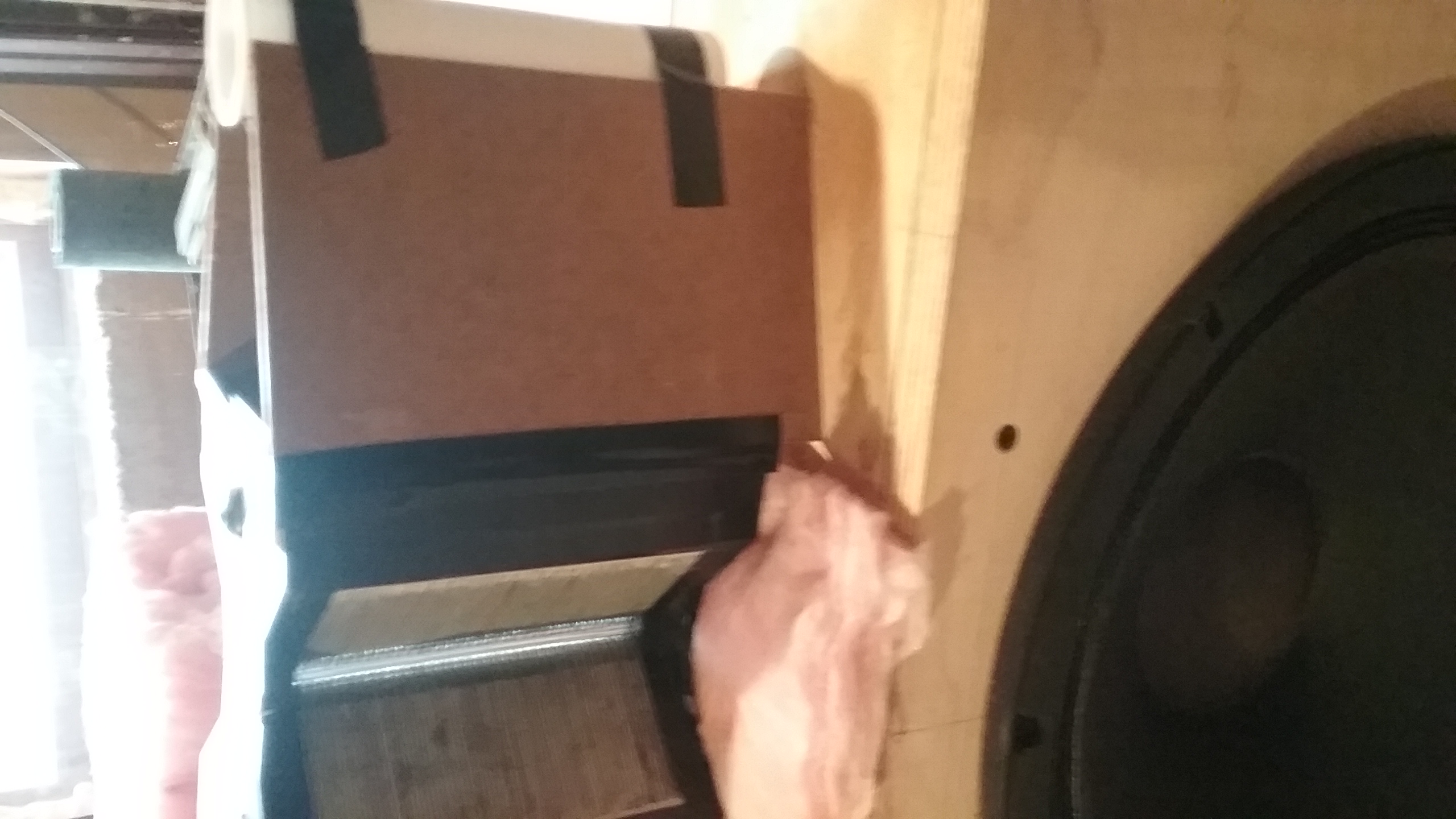

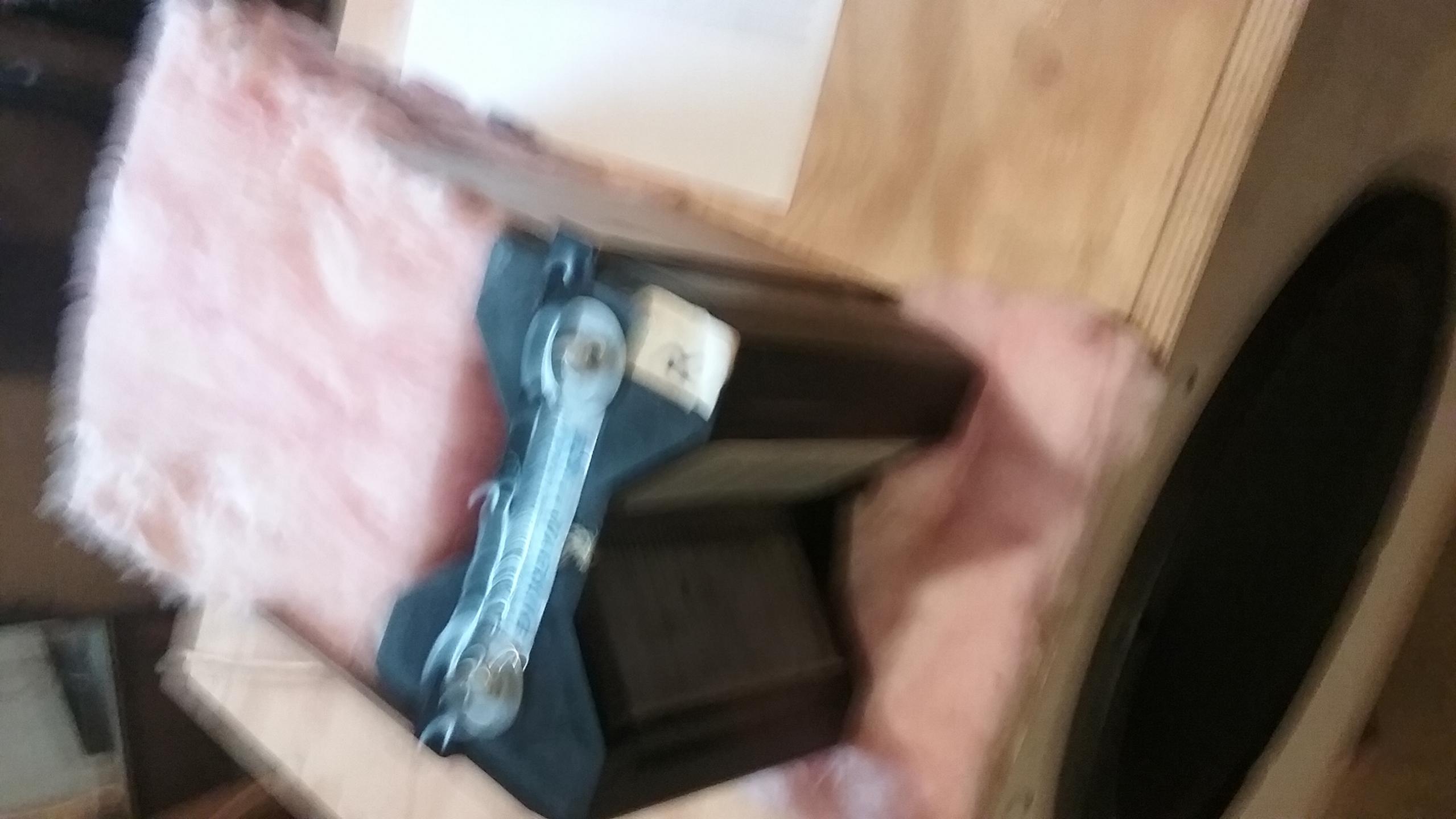

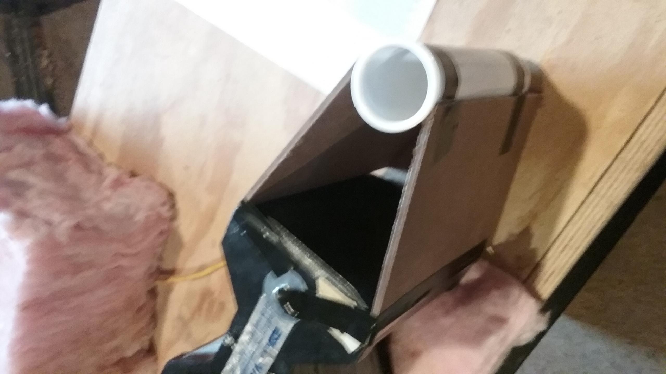

Do you have any pics you can share?
Hi kec.
I included a quick mock up of the heil baffle used with the OB system.
The other two are of the arrangement now.
I also removed the mesh veil on both diaphragms. This lowered the peak around 6-7khz by about 3-4db. Removal also brought back some sonic details I remember that the originals had. Oddly, the veils seemed adhered in spots acting as would a damping effect. Both diaphragms measured much closer to each other afterwards as well.

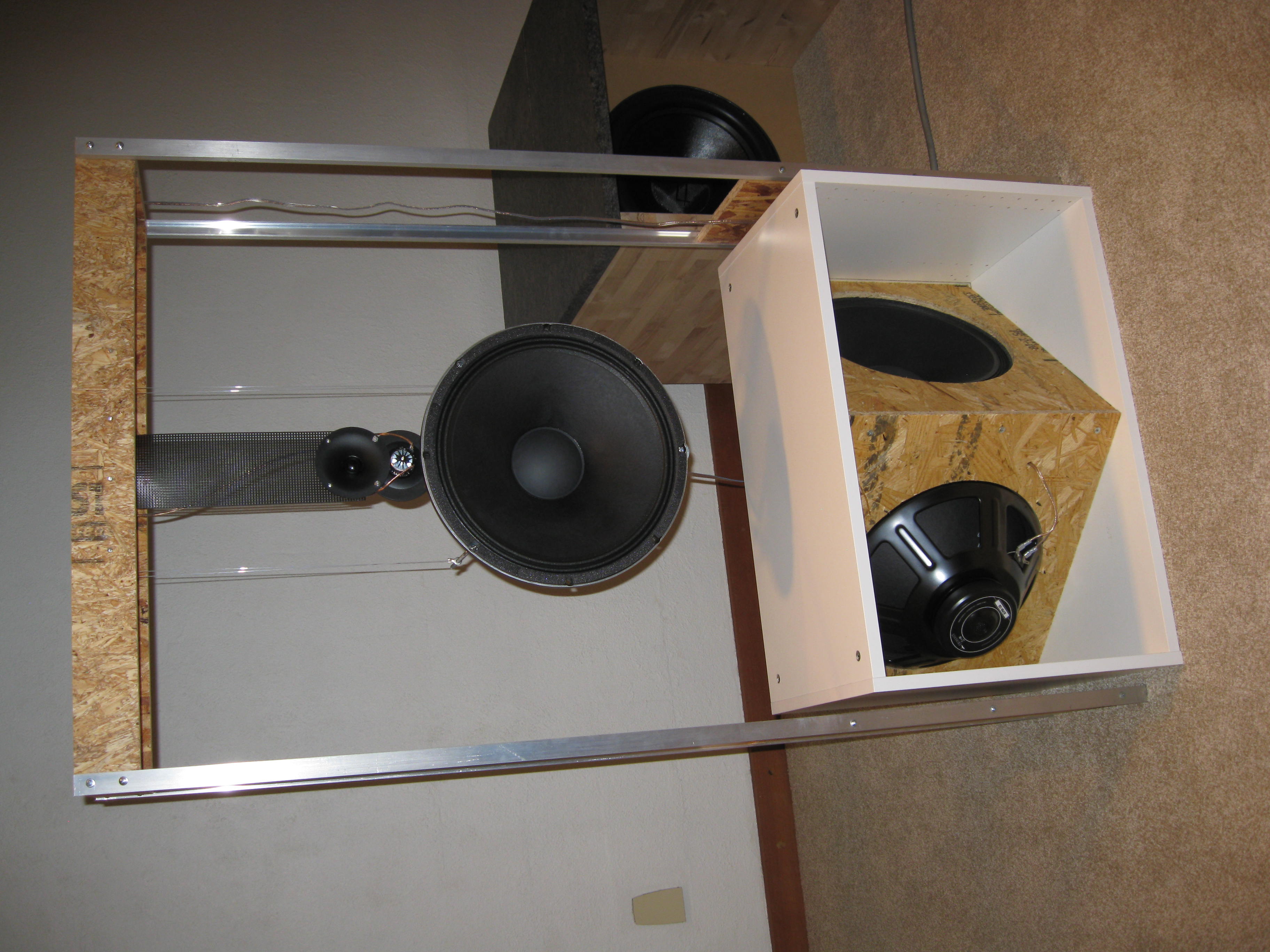

Actually, I have used a 15" driver directly with a dipole tweeter formed from two 1" domes, back to back, in a recent project (see attached pic). The only way this is possible is if:
1. The tweeter can be crossed over pretty low, below 2kHz
2. The woofer can play pretty high, e.g. to almost 2kHz or more
3. The woofer must be used "nude"
There are very few 15" woofers that can do it. I would have to measure the AE driver to know for sure, both on and off axis.
But even with this strange pairing, I had to add a subwoofer below about 150-200Hz because of the dipole losses on the 15". But when crossed over there, the system was capable of some pretty good SPL and the bass (from an M-frame) was impressive. Do NOT try to make a 2-way nude dipole, and even most 2-way open baffle speaker designs will have lots of issues.
P.S. I have no idea why the picture is rotated 90 degrees. It is not on my computer. Forum software to blame?
