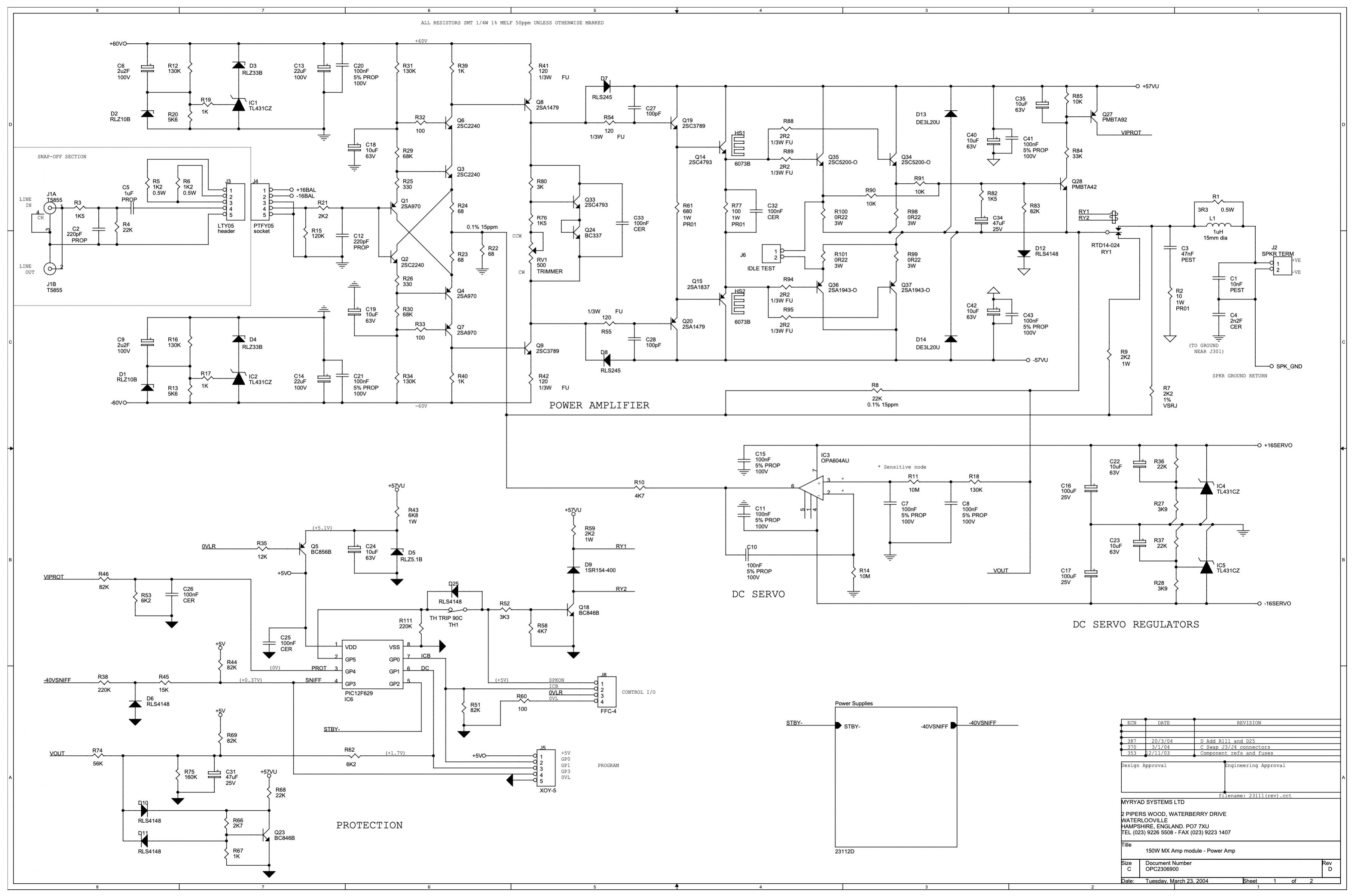

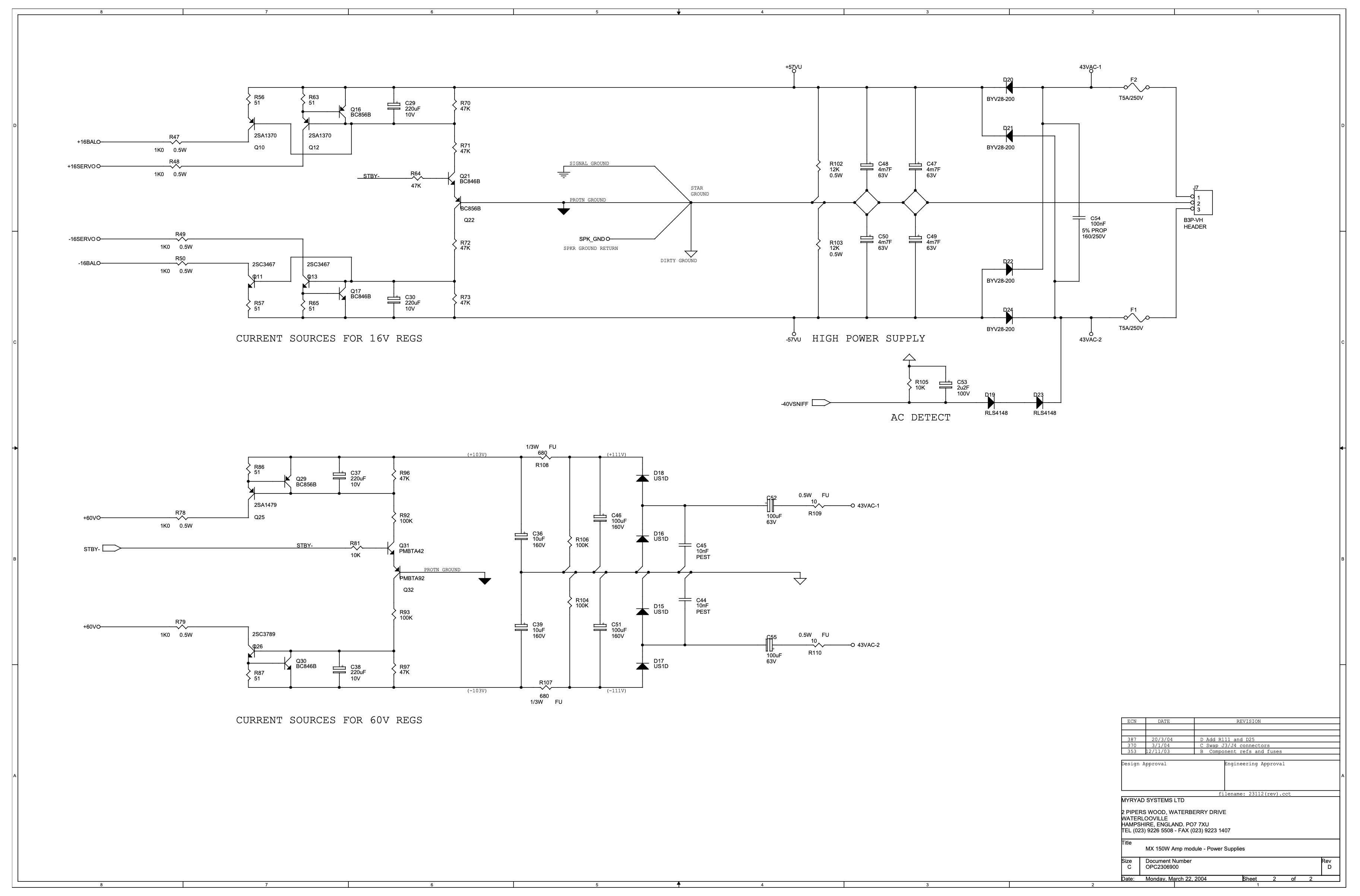

i'm not a completely novice but i'm not an expert either. the amp i've worked the most on is the Myryad MXA series (now defunct). I love these amps but i don't see them mentioned much
i would be looking to build something similar - class AB, separate regulated input stage, triple emitter follower
interestingly these amps also feature DC servo which i don't see mentioned much here
are there any DIY designs with these types of features? at first glance it looks like the honey badger is not dissimilar???

DX Blame Mk III - HX is a CCS input stage, triple emitter follower output. Doug Self & John Curl believe CCS input stage is better than voltage regulation. Honey Badger is a CCS input stage.
Peavey CS800x and CX800s are regulated input triple emitter follower output, but the input stage is an op amp. Pretty good one, compared to the 1st 2nd 3rd generation CS800 amps which had a noisy op amp.
But the only building you'll do on those is patching the circuit boards where the lands are burnt off. The Peaveys have differential input for long line noise (hum) rejection, and input echo to other amps, which you might find unnecessary or confusing.
I use voltage regulated first stage because the wire count is a lot lower, and I build point to point. Bare circuit board with holes drilled in it. Retro Amp 50W Single Supply - Page 22 - diyAudio AX6 when simmed shows about .06% HD someone said. I like the sound of mine.
