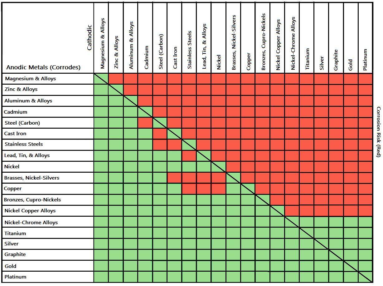

Aluminium is incompatible with many metals. The reason is that the electrode potential of pure aluminium is -1.67 volts, whereas the most other metals used for fixings have a near zero or positive electrode potential (e.g. chrome -0.76, iron -0.44V, copper +0.34V, gold +1.5V). The result is that galvanic corrosion occurs within the threads and aluminium is deposited in the threads of the other metal, making extraction very difficult or impossible.
Anti-seize does not stop the corrosion, so is of limited use. Engine head bolts are usually made from chrome molybdenum steel which has a relatively low galvanic potential, whilst aluminium alloys for engine blocks contain elements to raise the galvanic potential, and the two alloys are not dissimilar enough in galvanic potential to cause the thread corrosion problem in aluminium cylinder blocks.
Below is a metal compatibility table.
.What seems very odd to me is that these are the supplied fasteners. Only the ones attaching the grid wire to the grid seems to have problems. The plate connection seems OK According to the chart steel, brass and stainless seem compatible if the green areas are acceptable.
In your first post you said "I believe they are aluminum and the screws seem to chrome(ish) plated brass." If the metals are compatible some high temperature (silver, nickel or copper based) anti-seize should work.
Because items are supplied together you would hope they are compatible. In Australia the Australian Standard for solar installations requires by law that stainless steel bolts are used with the aluminium frames, rails and brackets that hold the panels. This is a disaster and can cause premature failure of the fixings, as well as making it near impossible to disassemble a solar array without damaging the component parts. It's hard to believe that after >>100 years of metallurgical science that such a stupid proclamation could be made.
