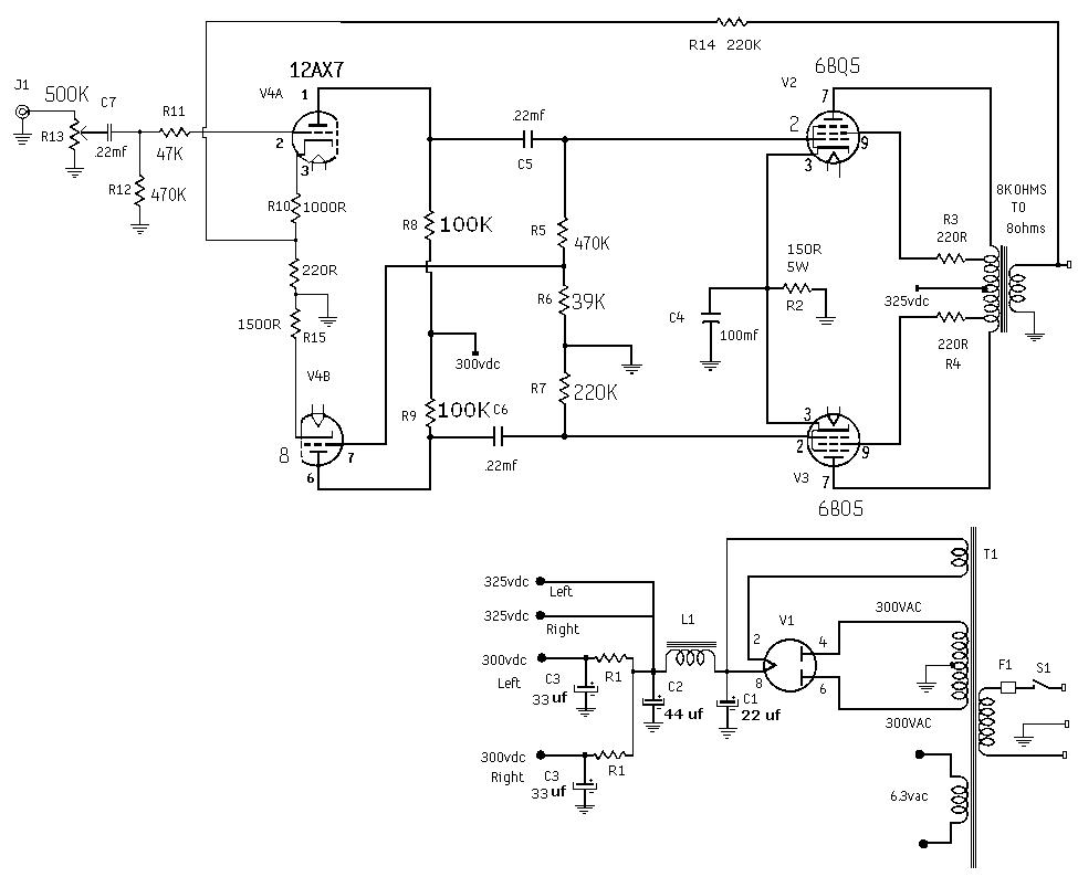

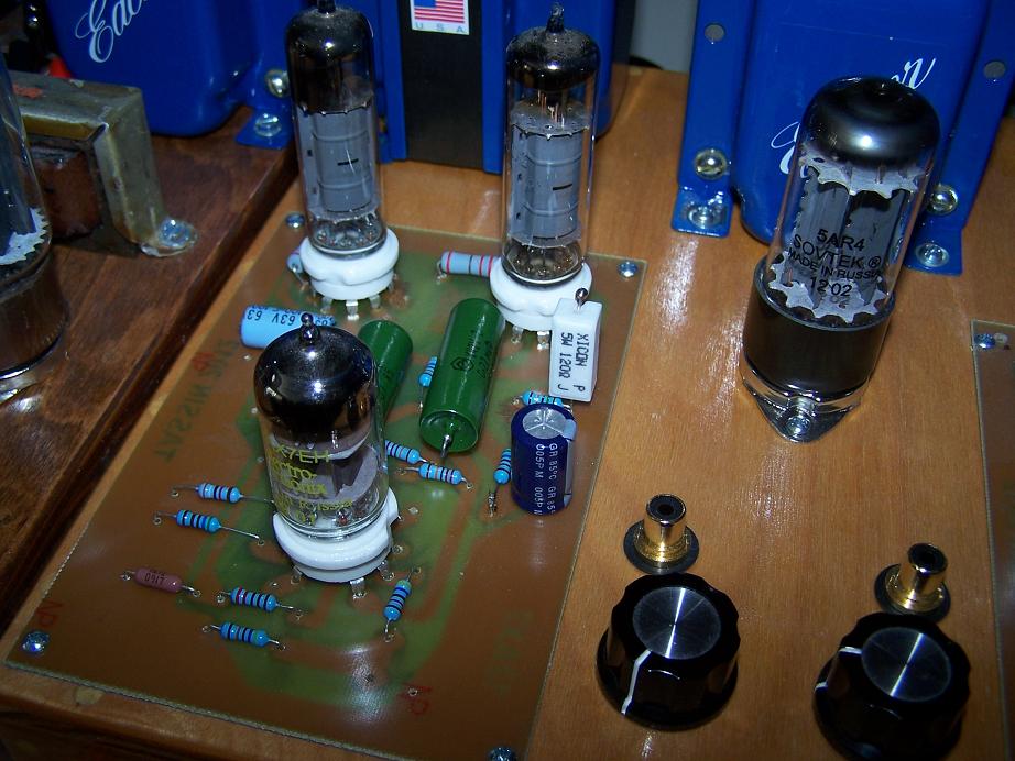

You can't go wrong with an EL84 push pull design.
Search for:
Bevios valley amp
Red light district amp
Baby Huey amp
Search for:
Bevios valley amp
Baby Huey amp

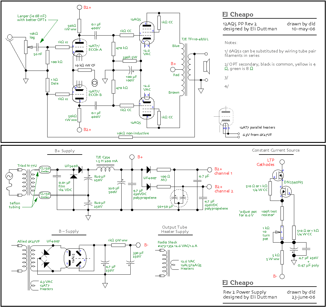

I'll grind my own axe and add "El Cheapo" to the list of possibilities. Any member of the large 6V6 family can be used as "finals", with zero parts value changes. EL84s can be used in the O/P stage by changing the values in the RC bias network.
Jim McShane sells kits of parts for the project. You add a chassis and magnetics. A complete set of power magnetics can be purchased from Allied Electronics. Depending on budget, O/P transformers can be sourced from Edcor or Triode Electronics. TE's Dynaclone Z565 is the gold standard, but may too costly.
