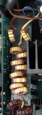

Interestingly I only yesterday built a filter with 13uH inductors. They were wound on no.26 iron powder toroidal cores (cheap). Iron powder is a great choice for supply line chokes because of its soft saturation characteristic - essentially it has distributed air gaps. OTOH ferrite is a rather poor choice (unless over-sized) because it has a very sharp saturation characteristic.
When using supply line chokes, pay attention to their DCR - too low and your supply could amplify, rather than attenuate, ripple. There's a temptation to wind with the thickest wire a core will accept but often, thinner wire will give better damping.

Good question - it depends fairly critically on the particular caps. If they have low ESR then more damping is needed in the inductor.
The filter I just designed, I measured the ESR of my 2200uF caps, it was about 40mohm. The 13uH inductors were 20mohm, this had about optimum damping. Going to lower ESR caps would mean putting thinner wire on the inductors.
I should add - the particular filter I built was CLCLCLCLC. Putting caps in parallel means a bigger value inductor could be used.
Added a crop from a pic of the internals of my amp to show what the filter looks like. The 2200uF caps are underneath.
