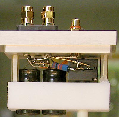

Like you I thought of wiring point-to-point however it quite easy to make mistake and make a mess of the wiring.
I end up using a chipamp board(on sale), for my LM3886, I don't use the alotted spots(ie on the PCB) for the resistors I wire directly to the pins esp the feed back(22K) resistor ie pins 3 and 9. This applies to other resistors. Use the board you mount the LM3886 on the board and solder the pins to the board. The resistors then rest on the board and all other terminations, eg I/P,O/P and power. The latter is useful us you may want to remove the wiring EASILY, YOU DON'T HAVE TO DESOLDER! YOU GET THE BEST OF BOTH WORLDS.
I mount 4 boards in one case, ie 4 channels. I will post picture soon.

If you already considered p2p, go with it, it's hard to make mistake.
I build some of my amps that way too: http://www.diyaudio.com/forums/showthread.php?s=&threadid=76609&highlight=
