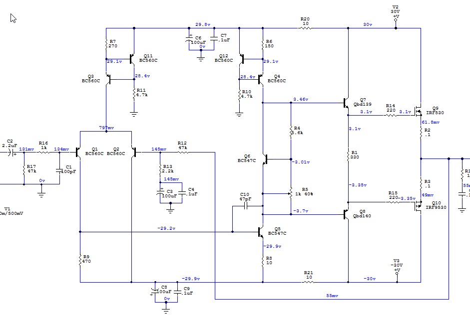

Perhaps repurposing what you already have there would be a good route to go. The RedCircuit is very poor, but with a few changes and a minimum of added parts you can make a respectable amp. The biggest flaws seen with the RedCircuit is the lack of temperature compensation for the outputs, the way the output mosfets are driven and the value choices of frequency shaping components that have the bass and treble both severely rolled off at each end.
Thank you a lot for your answer!
I did speak to one of my electronics teacher and he was quite intrigued about how the mosfet's were driven. I believe that what you draw was a lot more alike to what he descrived as usual.
Mounting both mosfets on the same heatsink shouldn't compensate their behaviour? Should some kind of thermally depending component be added to the feedback path?
Q6 in my schematic is the bias generator and thermal compensation device. It would be mounted on the heatsink between the mosfets. Adjustment of R5(1k pot) adjusts the idle current in the mosfets.
I have not yet studied mosfet's and how to drive them yet, so I am planning to stick with your proposed design for the new build.
I am quite upset about how awfully was the LP filter from the input stage calculated. Thank you a lot for pointing that to me!
Why did you change the cap from the high pass filter too? The pole was at about 7Hz which seemed fine. Also, can the electrolytic cap operate with the reversed polarity shown on the diagram?
