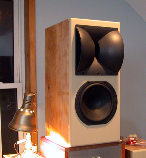

I have a JBL2342/JBL2425 with an 8" Peerless.
I had high expectations but ....FAILED
Back to the drawing board
