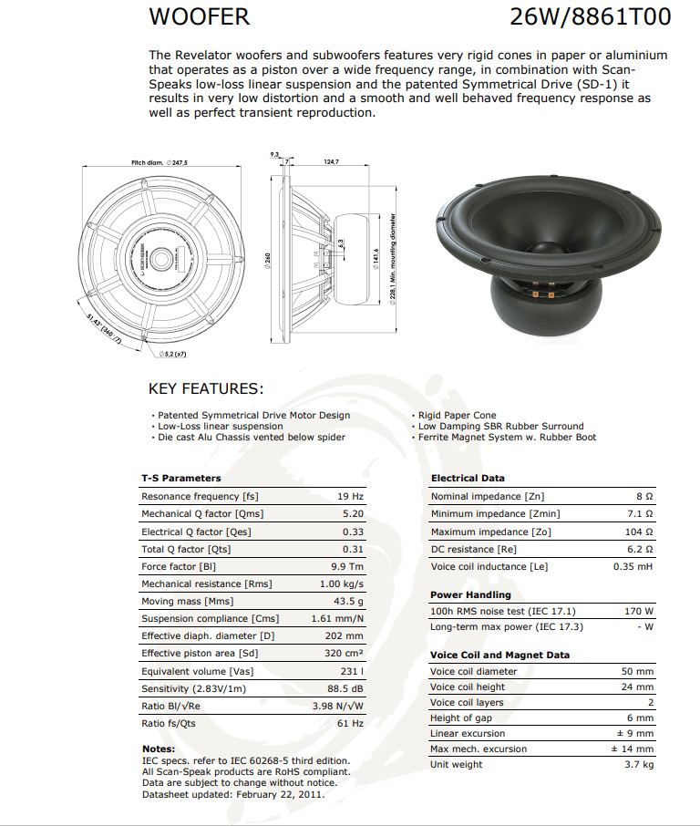

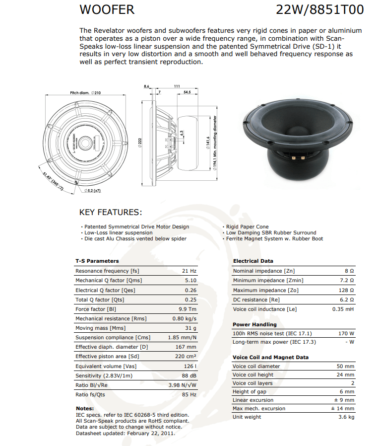

To be a little more specific with my question or to name the application.
I would like to build some kind of Illuminator-4 from Troels Gravesen.
And since I'm more into a slim design I would like to replace the 26W driver with 2 22W drivers. and make the enclosure of the Bass unit a little bit smaller
I know that this is not a simple thing to do and would require a lot of measurements and crossover tuning and also volume changes. I would just like to know if this would tend to be feasible with 2 x 22W.

For sure, except you need to measure the speaker and design new crossover if you make these changes
That would be something I would not want to do for such speaker, I would just build my own from get go, or choose kit that is exactly what you are after without any modifications.
There is also a 22W as 4 ohm if I wire them in series I get 8 ohm again would it not be ok to wire in series?Effective area is actually larger with 2 pcs in this case. Generally using more smaller speakers can result in a stiffer and more responsive bass than using one bigger with the same cone area.
If the f3b is about the same, I would suggest using 2 speakers. But then you will have to wire them in parallel. Resulting in 4 ohm speakers. And who wants that...
I see what you mean. I'm not necessarily interested in actually putting it into practice, but rather in learning a little more about some things from such mind games.For sure, except you need to measure the speaker and design new crossover if you make these changesThat would be something I would not want to do for such speaker, I would just build my own from get go, or choose kit that is exactly what you are after without any modifications.
Yes. If there's a 4 ohm version available it is preferred to wire them in series to get a 8 ohm speaker.
Better to make the dual woofers a 1.5 way for baffle step loss, best overall blend to the mids.And since I'm more into a slim design I would like to replace the 26W driver with 2 22W drivers. and make the enclosure of the Bass unit a little bit smaller...............I'm not necessarily interested in actually putting it into practice, but rather in learning a little more about some things from such mind games.
