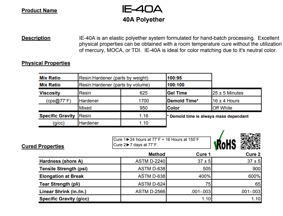

Look for Shore hardness scale, adhesives should have a shore number in their datasheet so you can quickly evaluate if it is suitable or not.
I think what you want for CLD is shore A 30-40 or something like that. Geddes used Innovative polymers product IE40, which seems to be have shore A 37 +/-5

I just found out that Innovative Polymers was bought by Rampf and that IE40-A is not anymore available. I try to find out if any of their PU would work.
One issue which not really directly related to Shore hardness is whether a flexible polymer is elastic (acts like a spring and returns all vibrational energy) or viscoeleastic (absorbs vibrational energy, also described as low rebound) and that is data is very difficult to find.
