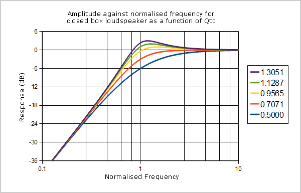

I am looking into adding a 2 ohm resistance to a driver (Monacor sph-130). According to my maths this would change the Qt from .32 to .40
The effect this has on a sealed box with a Q of 0.8 is as follows:
Without series resistance Volume 4.1 litres, Fbox 95Hz, F3 85 Hz
With 2ohm series resistance Volume 7.3 litres, Fbox 76 Hz, F3 68Hz
My question is, is the pay off as simple as that (apart from the sensitivity going down) or are there complications and other considerations?

Because that Qts=0.32 is a manufacturer data, it's even possible that the real Qts is different, can be 0.4 either.
What about the larger box without resistance? F3 would be higher but F6 and F10 are not.

Adding a series resistance is creating a voltage divider between the resistor and the impedance of the driver. For simplicity, think of the driver's impedance as pure resistance that is frequency dependent - the familiar "impedance curve" that you see for the driver.
Because of the voltage divider effect, you will also get changes to the frequency response at high(er) frequencies, where the driver has a rising impedance. In essence, by adding a resistor you are implementing some degree of equalization of the input power that roughly follows the contour of the driver impedance magnitude (the impedance curve). The degree of EQ is related to how much series resistance you add.
So make sure to take the effect at higher frequencies into account when you are considering this change. Just like with high impedance amplifiers, many uninformed tweakers think that using it does "wonders" to the sound of e.g. their single-driver loudspeakers, as if the amp itself is the culprit. Instead it is only the "EQ" effect that is responsible for the tonal changes that they hear.
Ah. I was thinking of running the main driver quite high, and I see on the manufacturer's impedance curve that the impedance is about 15ohm at 5k. What you point out will be significant. Thank you.
Any competent simulator will take care of the changed frequency response. The resistor just becomes a circuit component.
