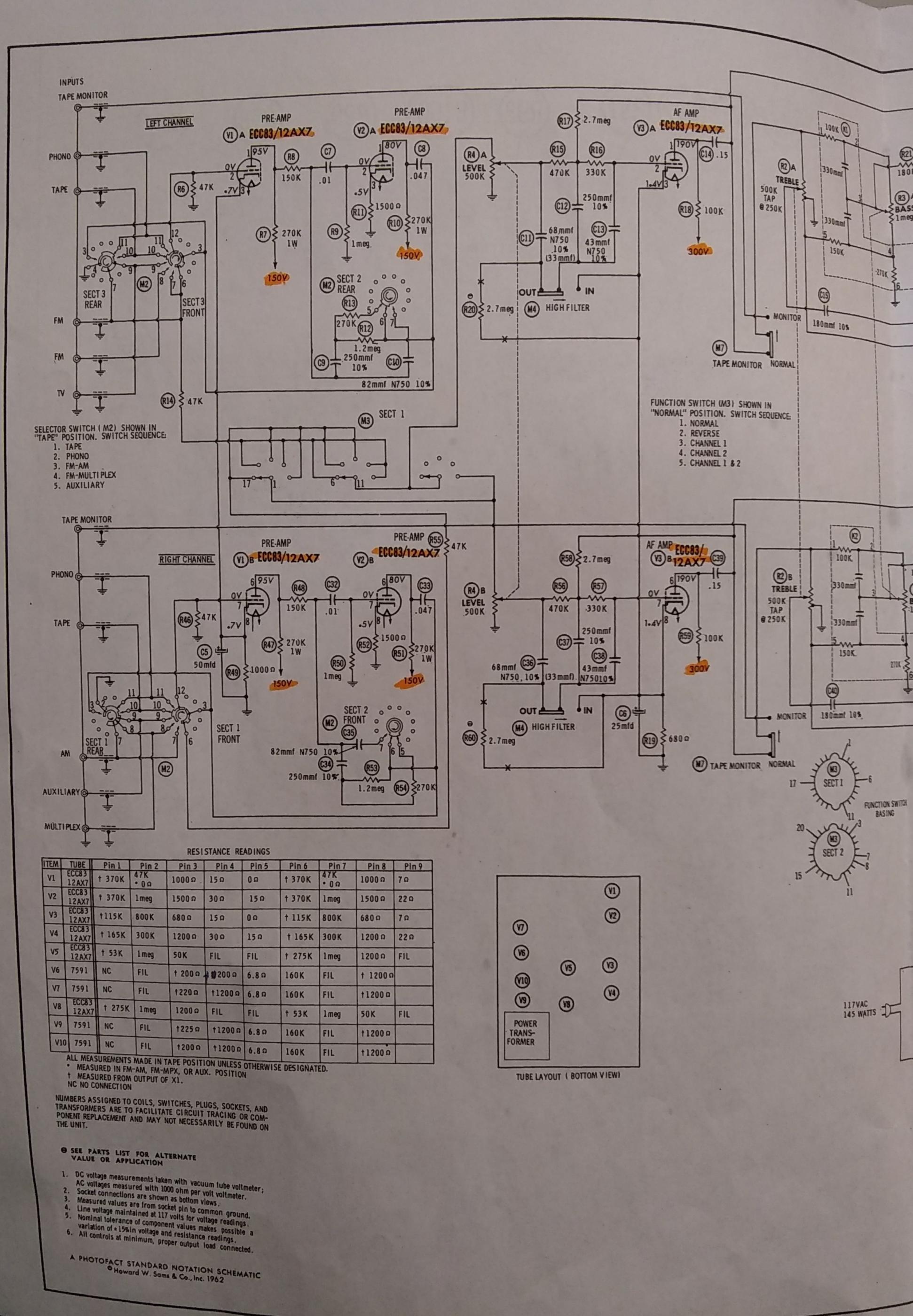

Hi guys, I'd like to add adjustable bias to my Sherwood S5000II. I can solder but I'm not great with electronics yet. I'm attaching a schematic. The power tubes are 7591s. Is there someone who can tell me if this has fixed or cathode biasing and where would want to install bias pots? My best guess is replacing r45 and r85 with adjustable pots but I'm really just guessing. I'm also installing 10 Ohm resistors from cathode to ground so that I can measure bias per Jim McShane's advice but I don't know how to add bias adjustment. Advice is greatly appreciated! Cheers
The schematic is to fuzzy to see what you mean with r45 and r85.
The amp is fixed bias, the bias comes at the "-22V" points.
You could mount 2 pots , one for each channel, from the -29V where the viper goes to the
"-22V" ( and remove the existing connection). But you better make sure that the bias supply can take the extra load from the pots.

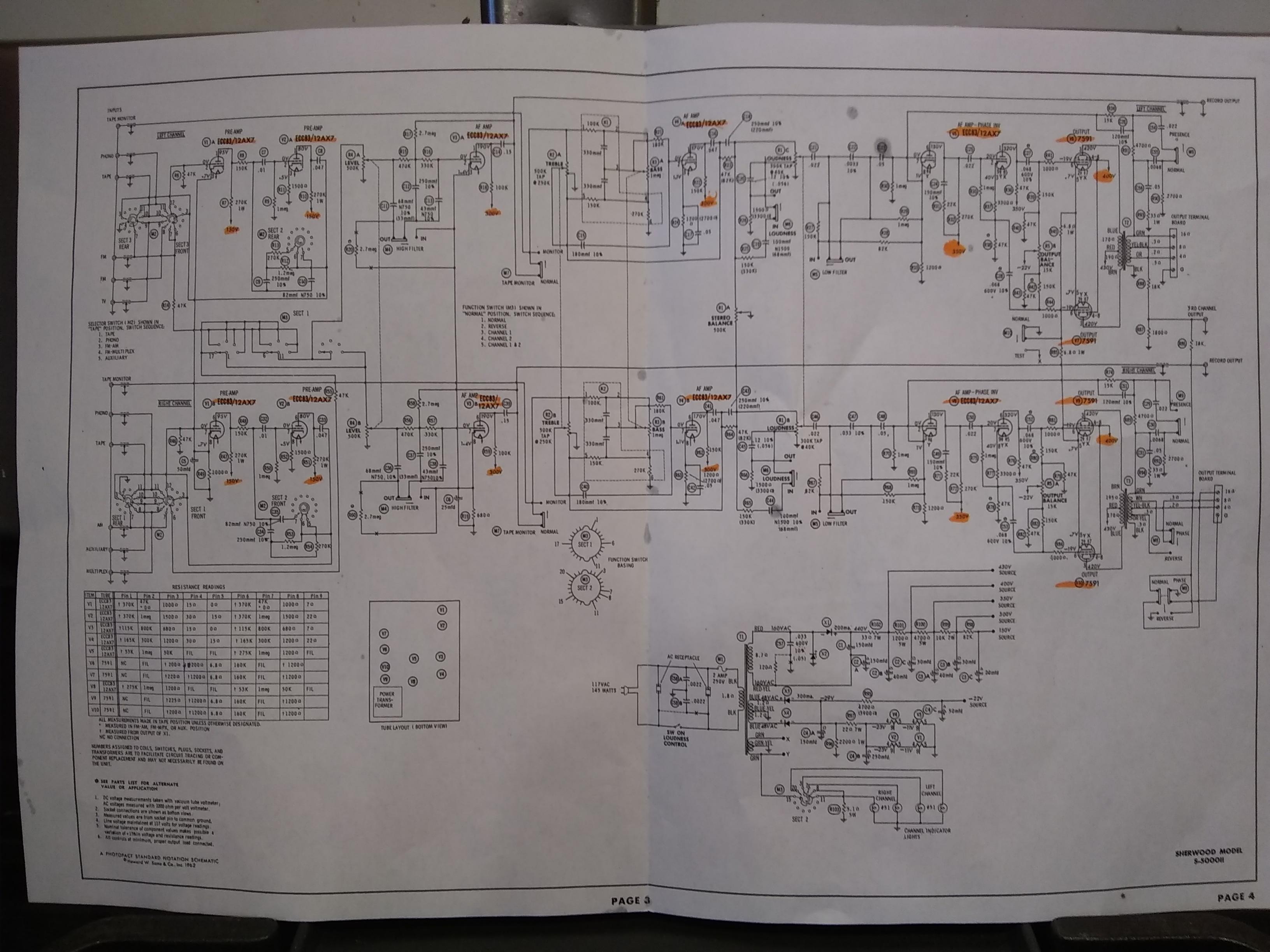

I don't know why the schematic looks blurry on the attachment. The original image on the phone looks great. I'll attach another source but the schematic is broken up where they separated the pages, and there is some overlap. I had to zip it to get it to fit under the size requirements.
OK so I took new pics one of each page. I think these will work better. It looks like you were referring to r5, where the -22 volts are, which is actually what they call an "output tube balance control" which is a 2 part pot for left and right. You're supposed to adjust those to reduce hum. But since that is an adjustable pot does that mean there is already bias control? In the attached image I've pointed to the adjustment knob that is R5 in the schematic which is the -22v point you referred to.
Those pots are indeed for bias adjustment, but they adjust the relative bias of the two valves in each channel. Adjusting for minimum hum is a crude way to zero the standing DC field in the output transformers. Your plan to add 10 Ohm sensing resistors is much better.
The next step beyond this would mean two more pots, each adjusting the bias voltage for its channel. An alternative would be four separate cathode bias resistors, each with a big capacitor bypass, and no pots.

Hi Chris, thank you for your input. Is the bias voltage typically on the cathode (pin 5 on the 7591)? If so, then can I simply replace he 6.8 Ohm resistors (R45&R85 on the schematic) with the appropriate pots? Or is there more to it than that? Cheers
This biasing is called "fixed bias" although it's often adjustable - your Sherwood is truly "fixed" with the same average bias applied to all valves' G1. Judging from your response, I'd guess that drilling into your classic chassis to install more pots may not really be what you'll want to have done, down the road.
As a conservative first step, maybe you should add your 10 Ohm cathode current sensing resistors and get a true feel for the bias currents as-is. Be careful, be safe, and let us know the voltages you measure across those resistors.

Ha, no offense taken. Its not obvious to me at this point, I'm a novice. Here's a question on that line of thought. Is it possible for me to measure voltage drop on the 6.8 Ohm resistors and derive current from Ohm law from there, then divide by 2 to get an estimation of the cathode current to each tube, assuming the tubes were balanced with those balance pots we talked about earlier?
On the nosey. Assumptions are getting me into trouble here. How are your power supply electrolytics? How is the (probably) selenium rectifier for heaters and bias? These need to be addressed first, if that's not obvious.
